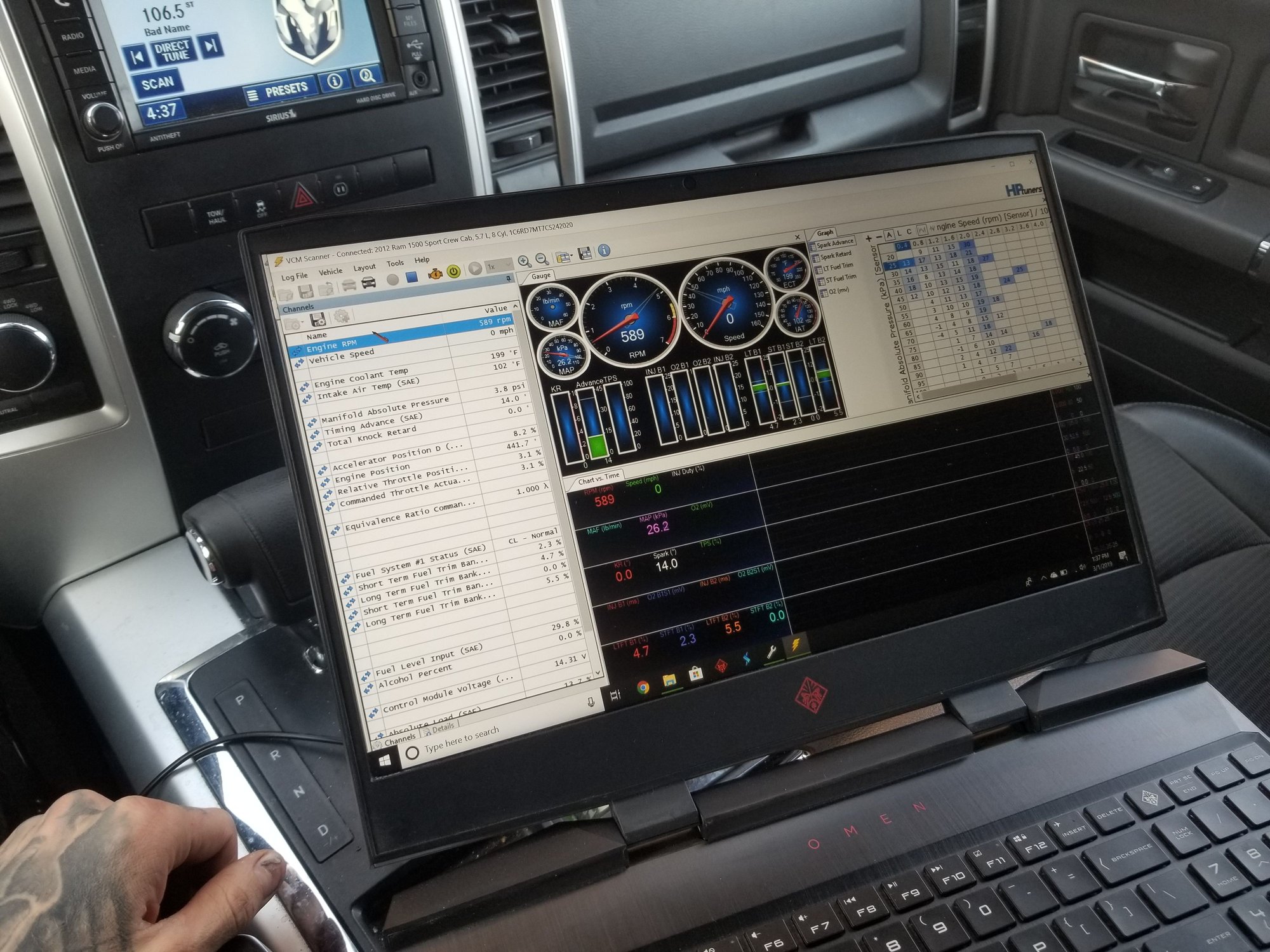

I didnt get a new shaft for it. I dont think I'll even have the u joint in time... I'm hoping to have the engine back in tomorrow. I'll have to do the ujoint at a later date.
I got the intake manifold all bolted on now, no broken bolts this time ��. Just gotta get a couple fittings and I should be good to go with it.
Pulled the oil pan and cleaned it up nice. Just gotta throw the new gasket on with a couple strategically placed drops of rtv so it hopefully doesnt leak by the timing cover again this third time.
I also got my hp tuners MPVI2 in the mail today, I'm excited about that. I tested it out and started tuning my dads 2012 Hemi Ram. I have a TON to learn, but I managed to increase throttle response, change the shift points, and firm up shifts on it so far. If I have a chance I'm going advance the timing a lil and set it up to run premium fuel.
Kinda off topic...but also kind of related since I mainly got it to tune the blazer.
