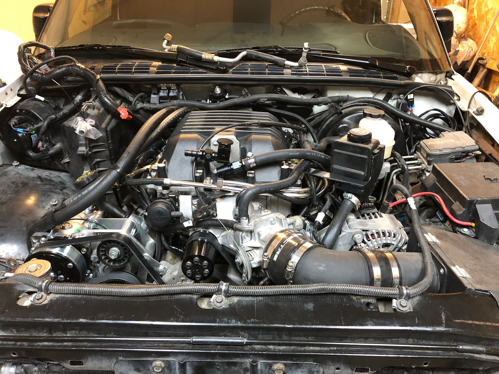

Pushrods came in today and i made some progress.
Soo close!!

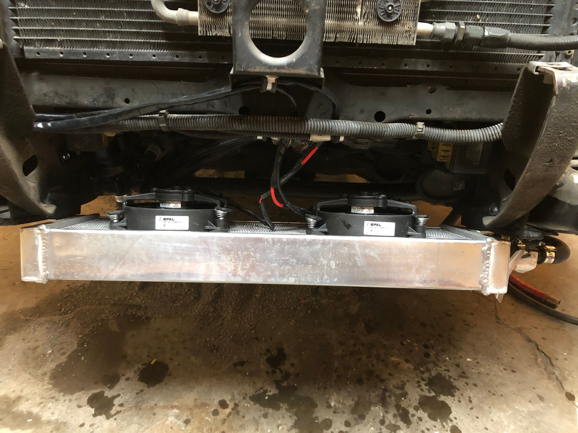

I also added 2 SPAL 5.25 fans to the heat exchanger while i had it apart.
I have them temp mounted just to see how well they work. If i need to, i have room for a 3rd one of the same size.

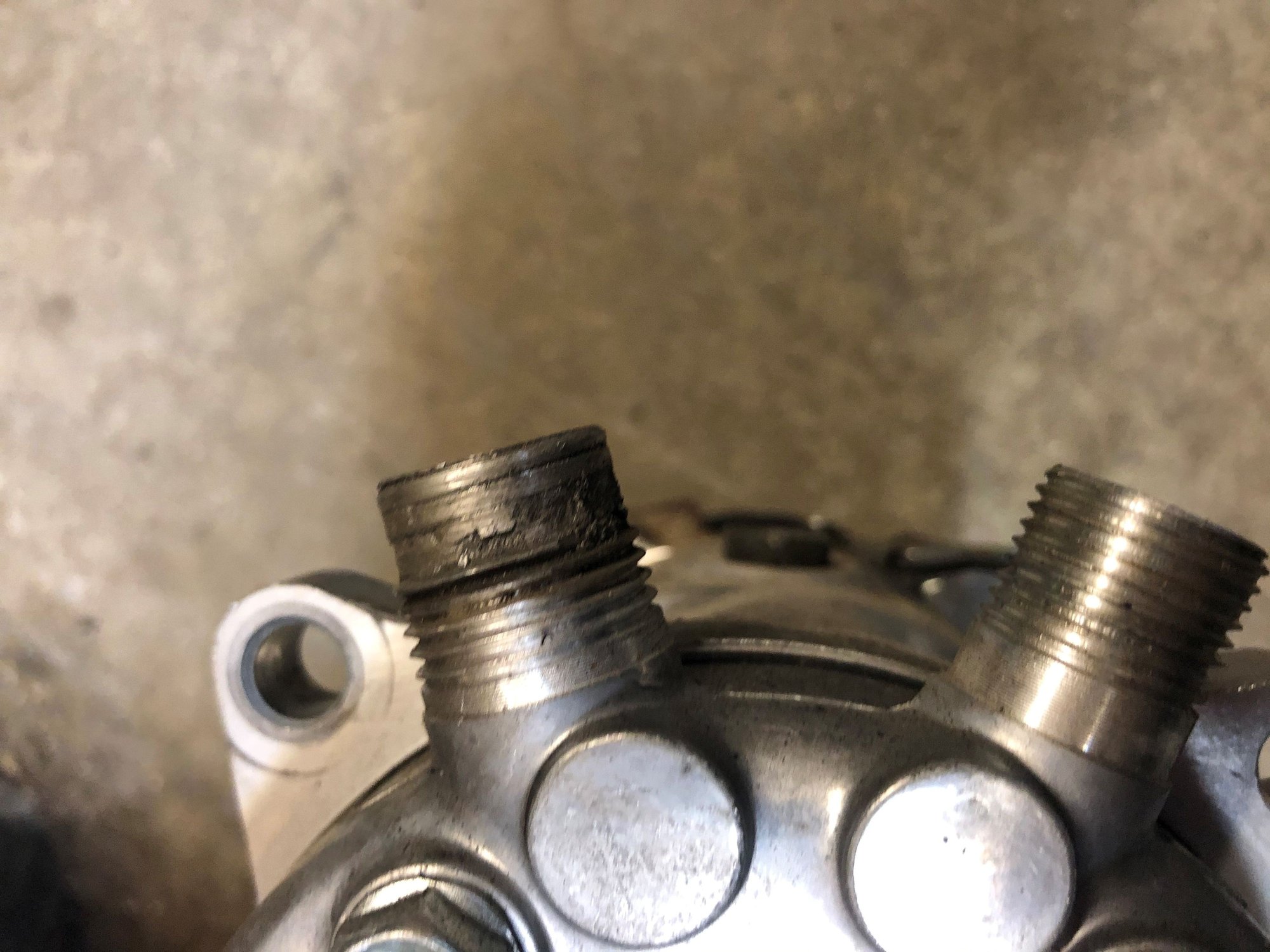

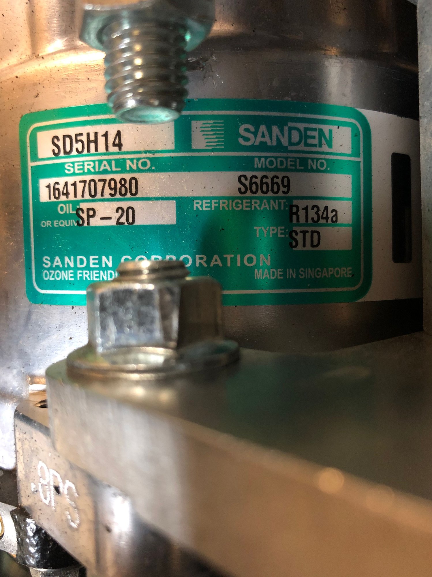

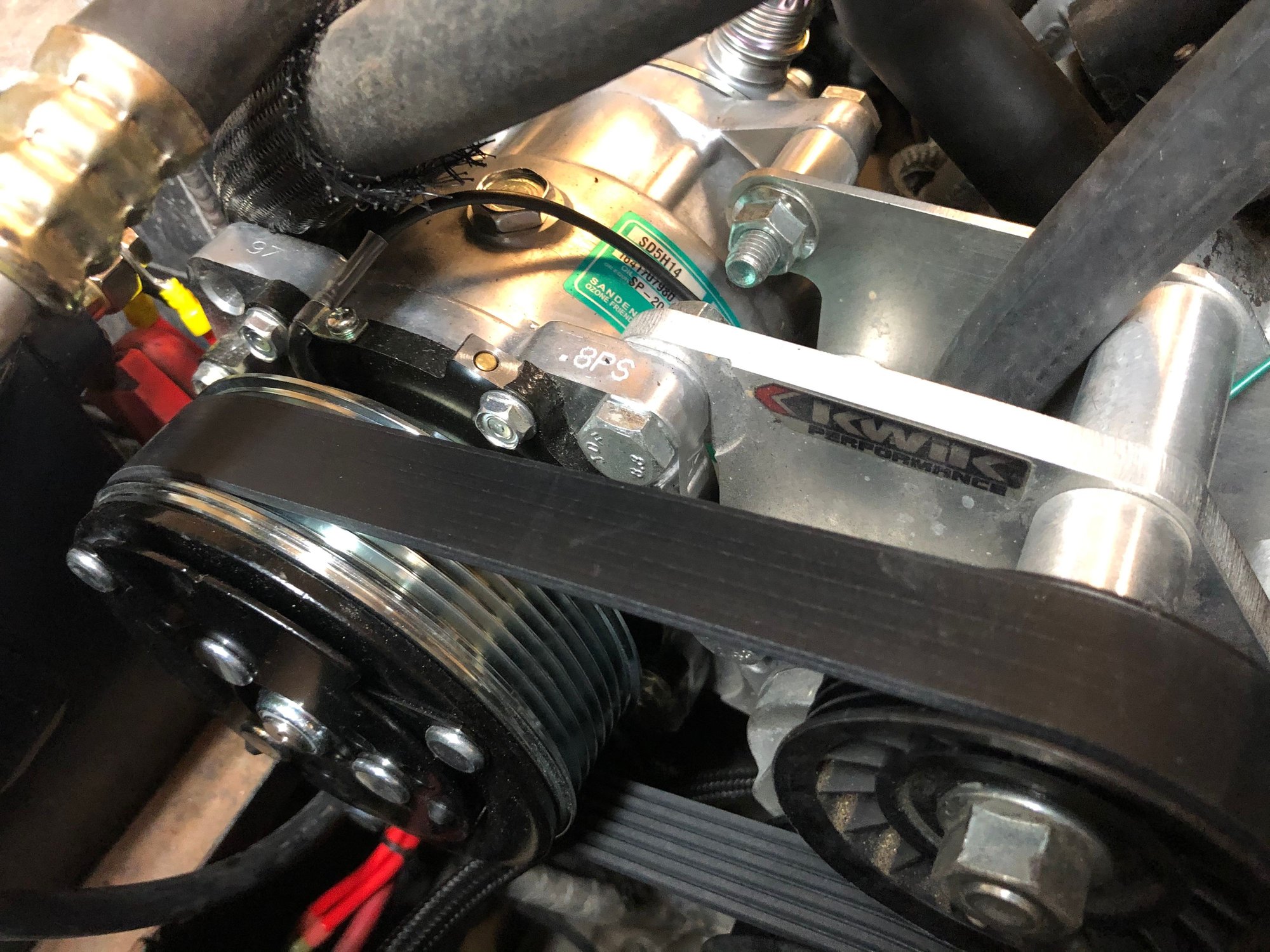

I also had some fun when i went to reinstall the old A/C Compressor.
Made in China.....yay
And the replacement along with cleaning out all of the lines, the condenser, the evaporator and ordering a new line and dryer.

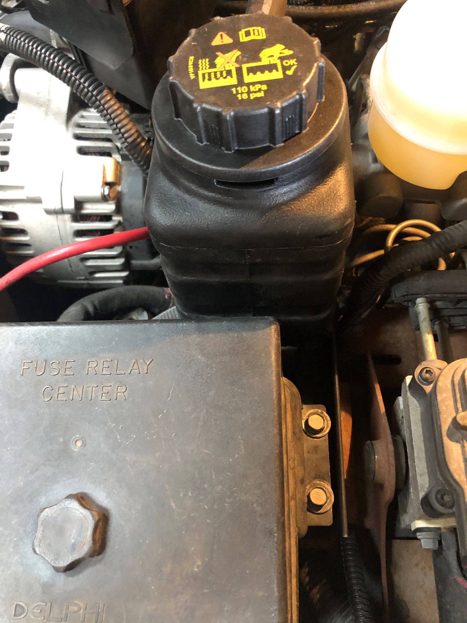

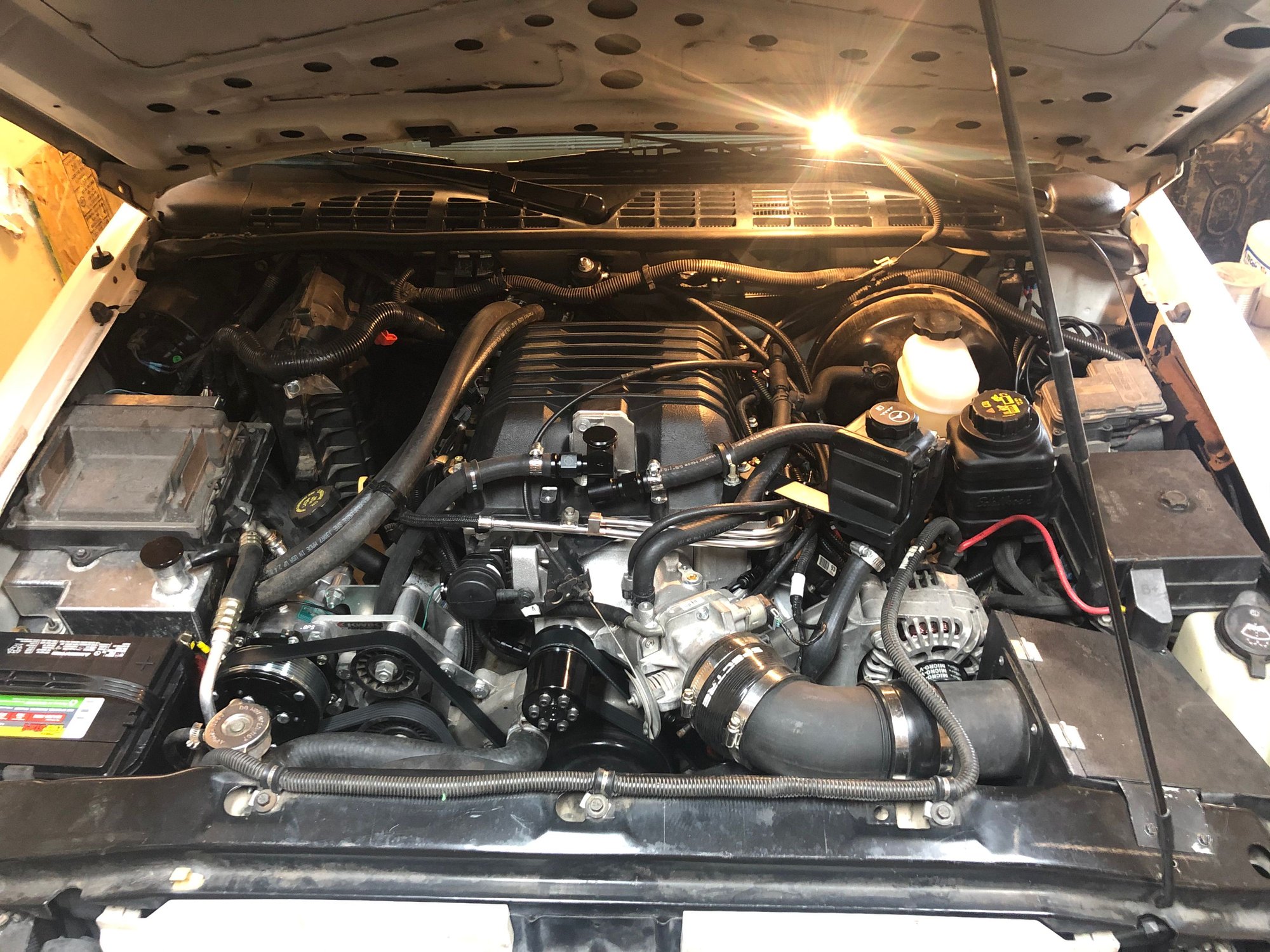

I found a good location for my supercharger coolant overflow bottle. I thinks its about the only spot i can put it at this point and still keep it high in the system.
Fabbed a simple bracket up and she fits like a glove.

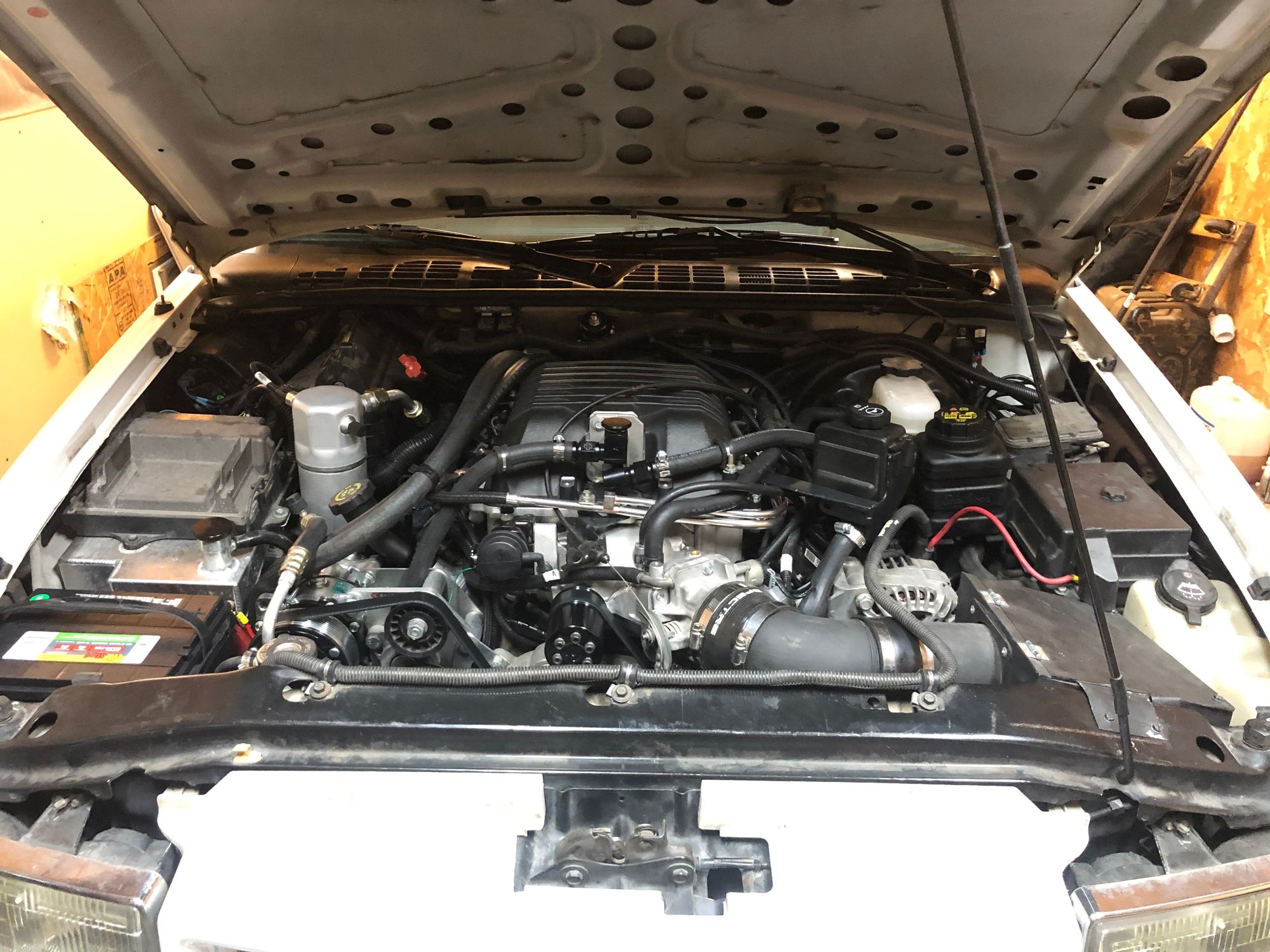

  #137
Theres more going on under there then a 2020 Mercedes lol... looks good tho, tightly organized lol

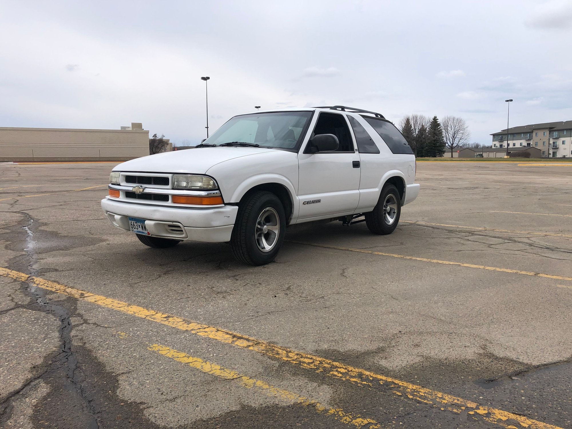

She is complete again and back on the road.
Now i just have to get the tune dialed in.
Look like any other beater to most people. HAHA
The heat exchanger hangs below the front bumper by about 1-2in, but is almost hidden. And my Intake air temps stay around 93-95 degrees so far with the fans and pump running.

VERY VERY Nice Work!! Best I've seen in a modern swap. You should contact "Jags that Run" and get yours in the next edition of their book. Can I post your last photo in Hotrodders.com?
