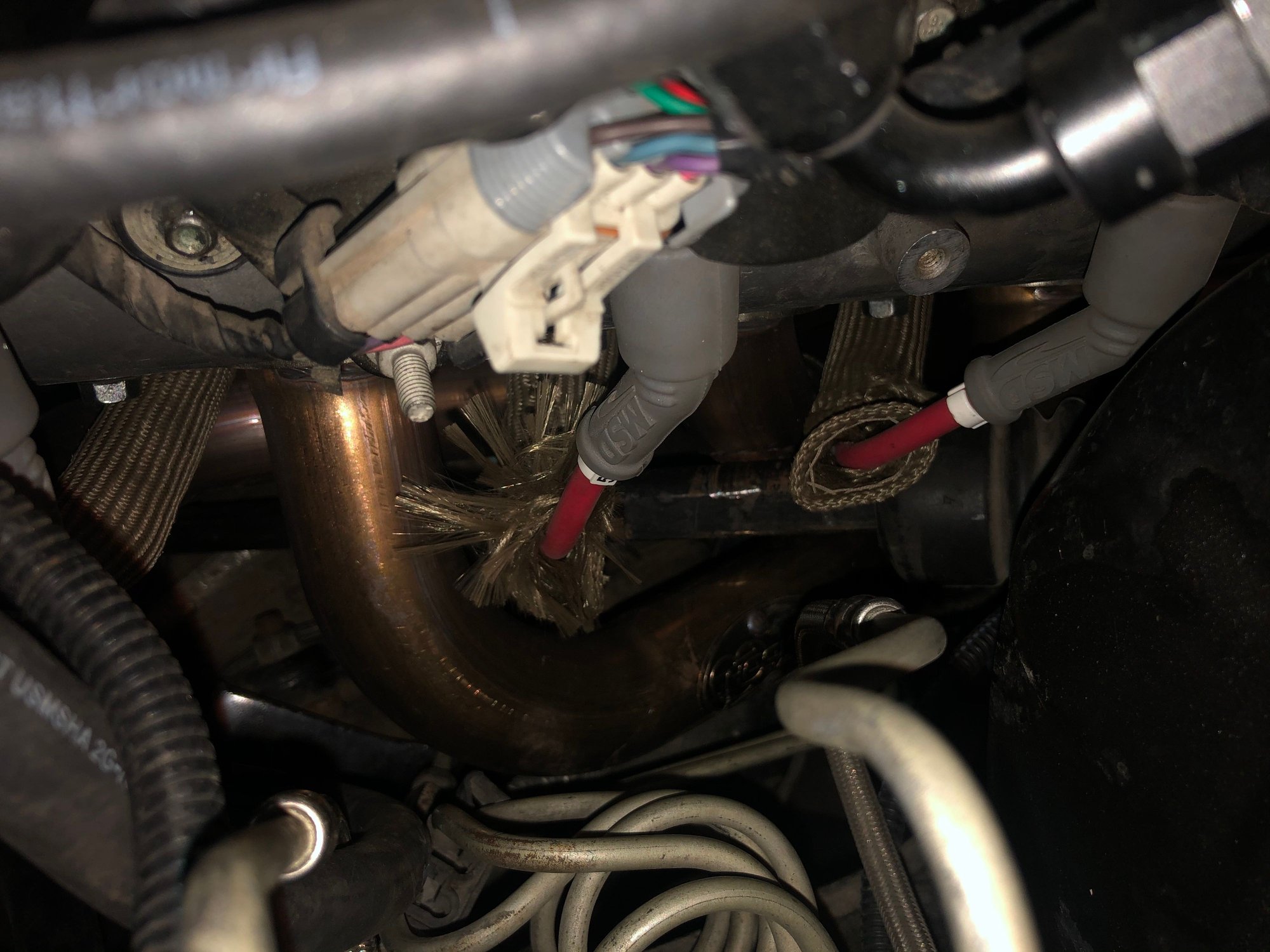

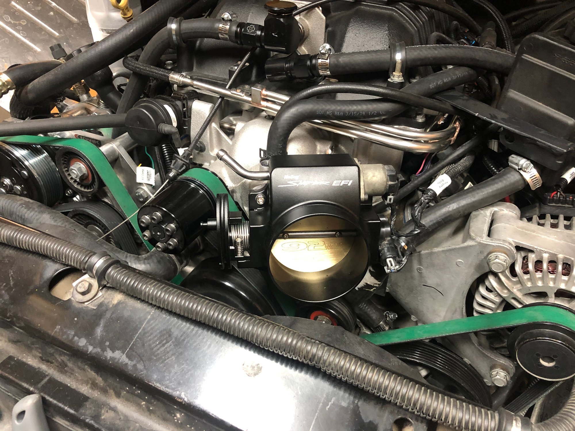

I put a larger 92mm throttle body up top and swapped to the Hooker 1 3/4 headers with a dual 3in exhaust. Ill have to get some more pictures, but for now it just dumps in front of the rear axle. This is way too loud and drones too much for my liking.
Please ignore the junk plug wire protector that i need to replace haha.
The left header needed a little bit of love from my hammer to clear the steering shaft. I believe this is due to being a blazer and the engine sits 2in higher than the pickups that these were designed for.

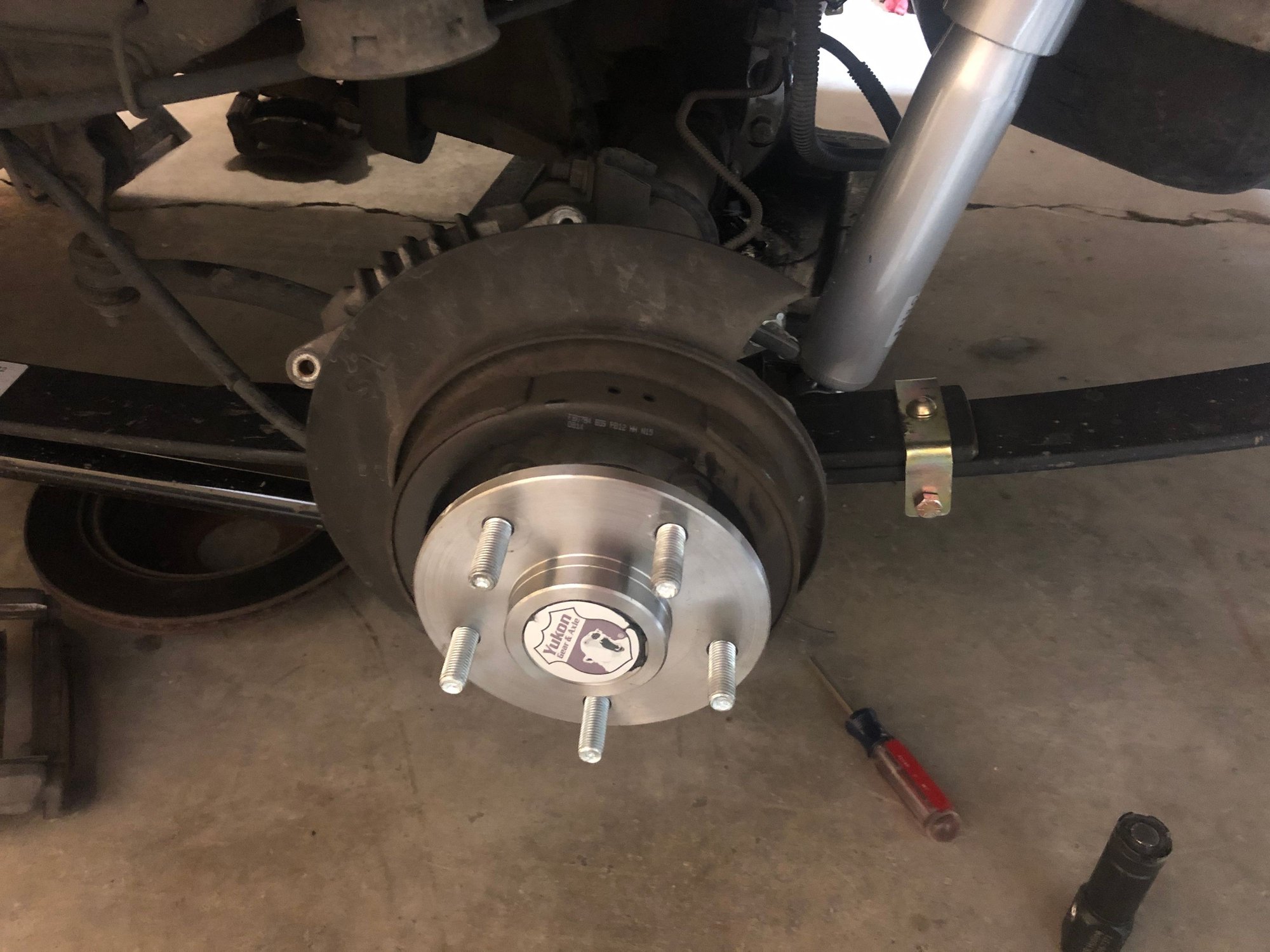

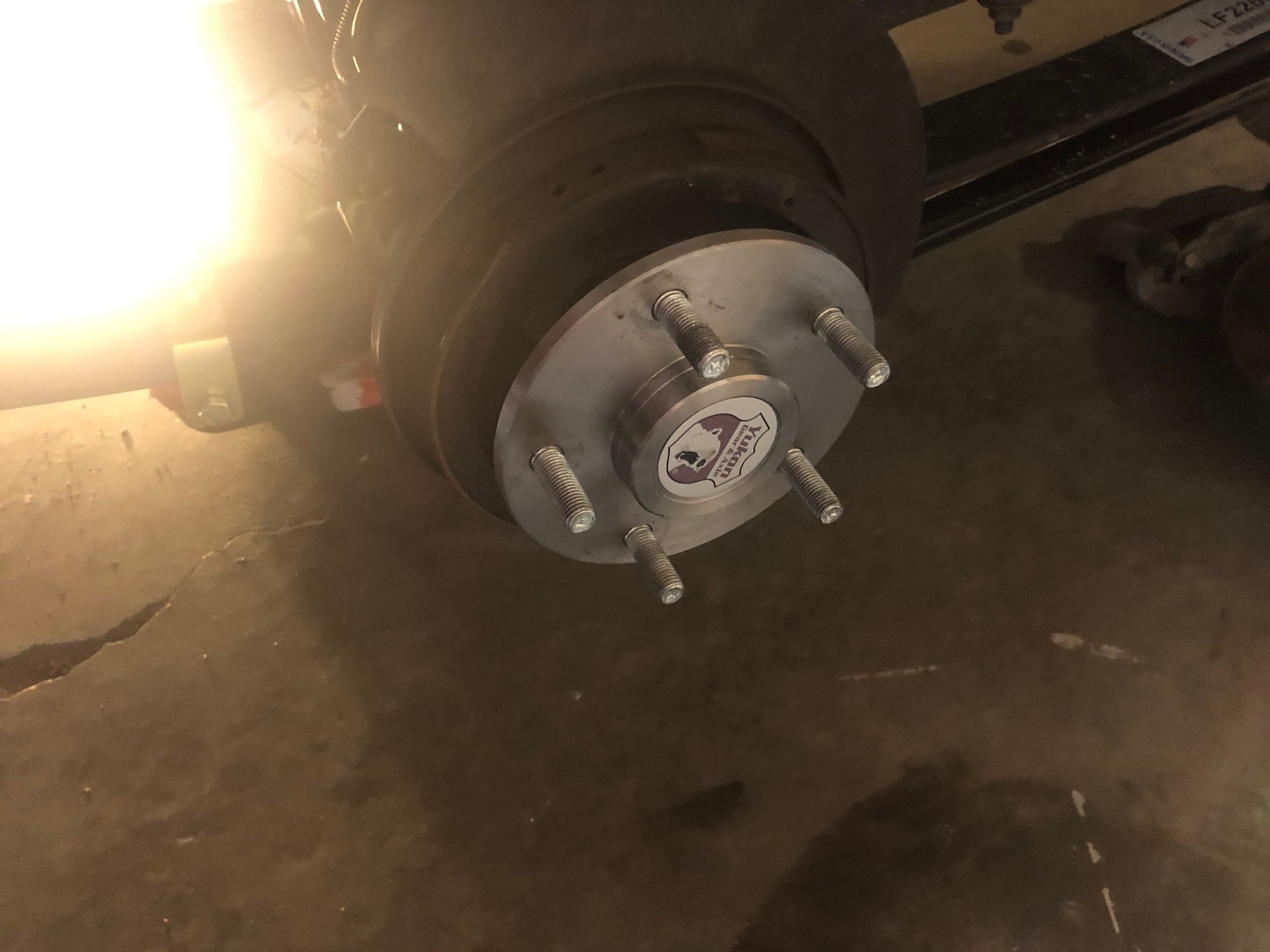

I also swapped in the Yukon axles. They are not the strongest out there, but better than stock and were a direct replacement.

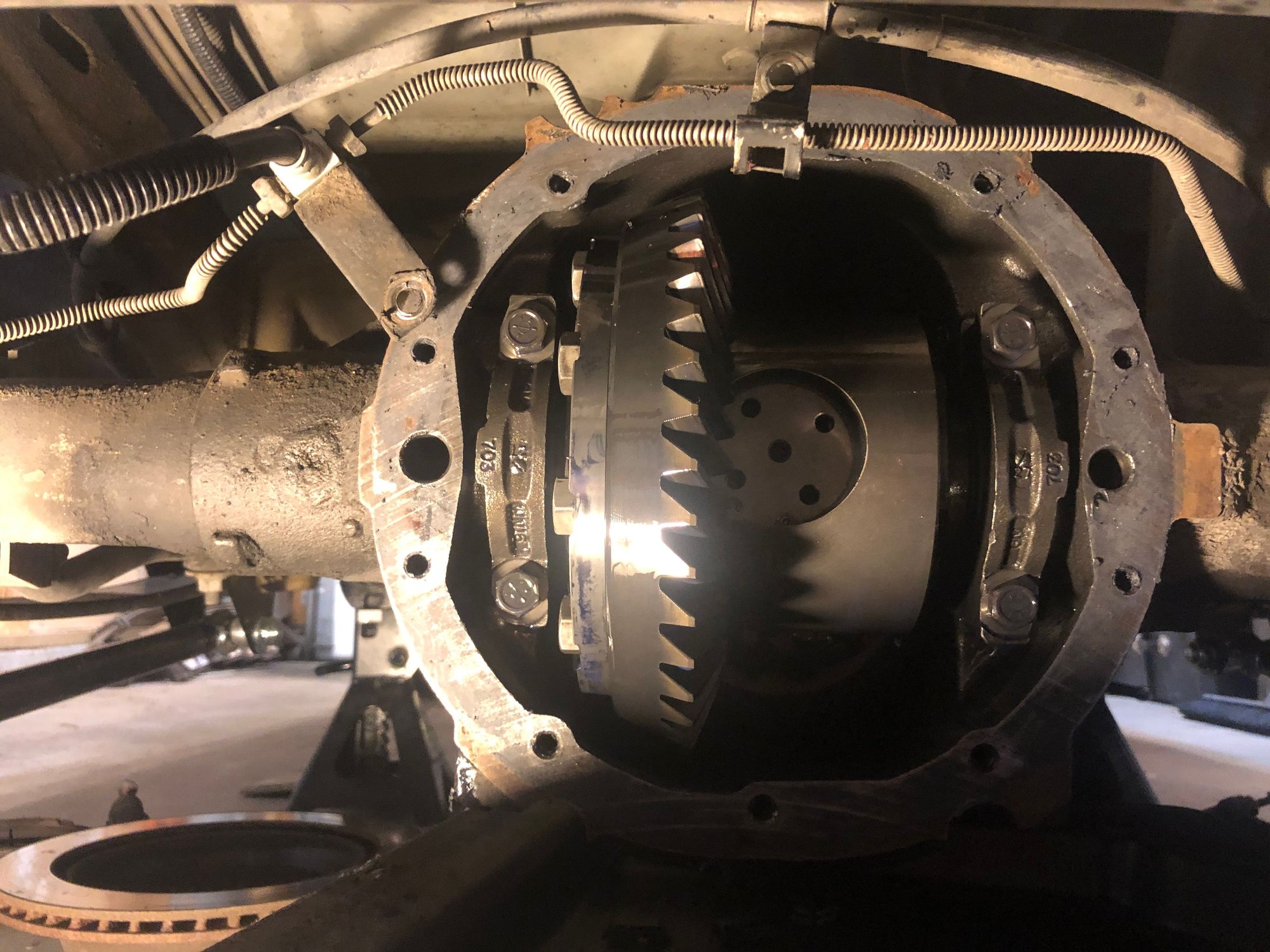

Here is my Eaton Truetrack limited slip. Much beefier unit than the factory carrier.

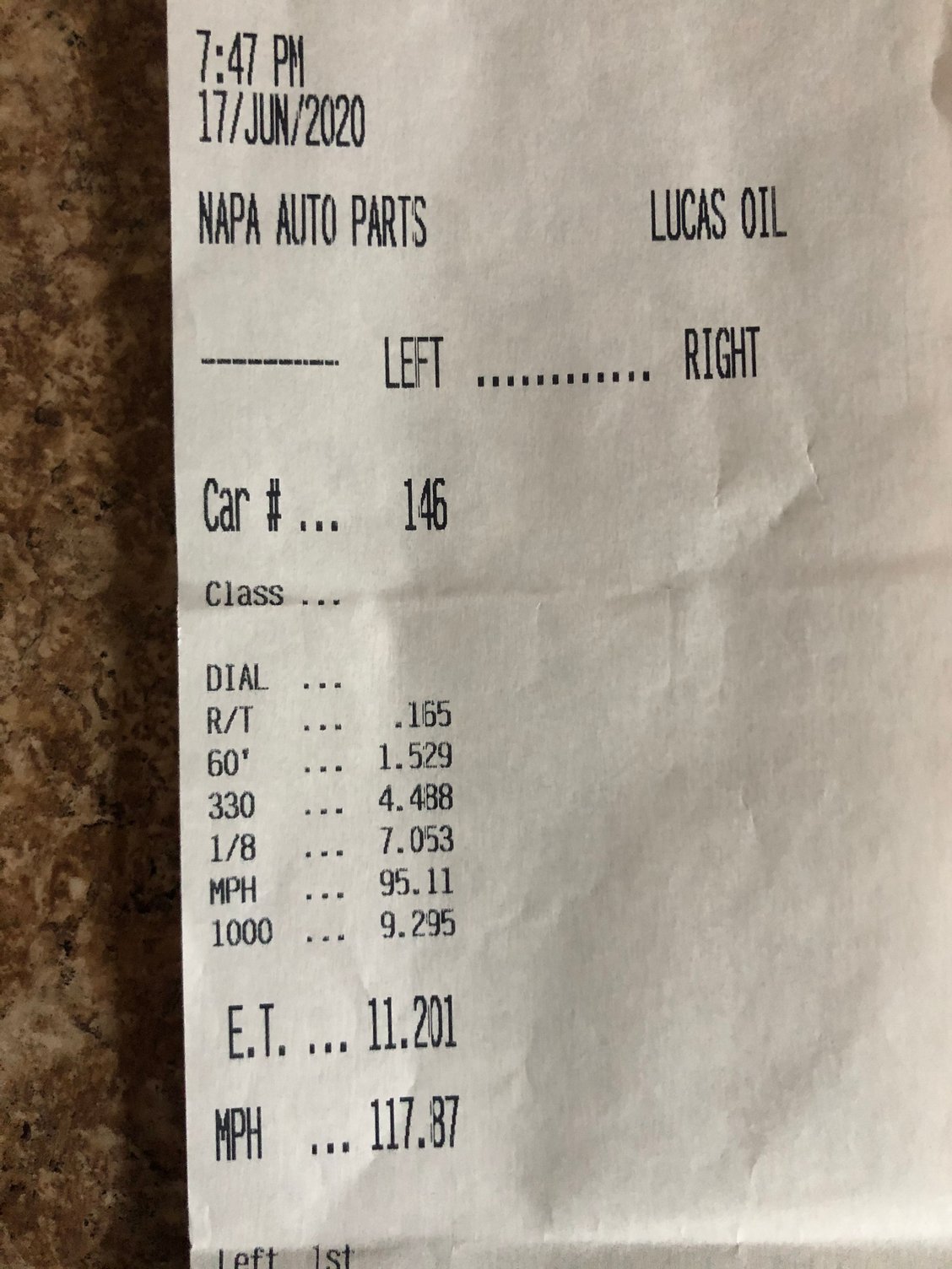

And here is the result when i can get her to hook. It lifts the front tires about 6in off the ground on the launch when it hooks. But most of the runs i was spinning off the line running mid to high 11s

Excellent! It's hooking very nicely. Very good 60', 1/8 mile ..... right on track for 11.2 ET. Is boost level adjustable? What tires? Was track prepped for race, or just a Test and Tune?
Here is my S10 for comparison. At 3200# with me and fuel so don't need quite as much horsepower. I finally managed to squeak into the 10's this year. Note that your 60' time was even better than mine! And you even have windshield wipers!!
If you want to bracket race, slow it down to 11.5 and you won't need to put a roll bar or cage in it.
