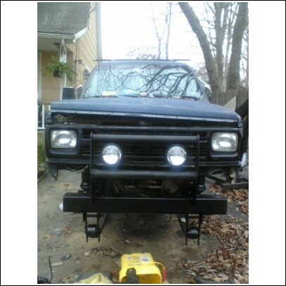

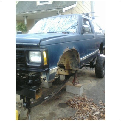

okay so just got back from a small vacation
u bolts for front come this week, should have front rear in and steering sorted out just as long as i get my oxygen bottle filled.
thanks for your concerns, i did listen.. i have a 6 lug to match the front and i am cutting the old perches and simply moving them in while also adjusting driveshaft angle.
as for the shackle, thats been that way since i bought the truck, no problems yet but i do have the gussets already cut out, waiting to fire up my welder for one big job.
looking for tires and rims now on craigslistm thinking about something between 35-37"
started to paint in the down time waiting for parts, blacked out the front and frame rails (pics below)
so how do you guys feel about heating the steering arm up with the oxy acetylene and bending it forward so there is no longer a "u" shape ? where it sits now it actually reverses my steering wheel and right goes left, lol. any ideas ?

you can swap in a astro van gear box junkyards are full of astrovans. its a direct bolt in. lines and everything. thats what im running the pitman arm faces forward and swings the way you need it to. only problem is you will have to get a pitman arm or just ream the hole bigger depending on what tie rod ends you use in there. i went with the k5 blazer ends. beafy suckers.
ES2027L
ES2026R
are the part numbers i think. they are the ones that go from the steering box to the steering arm. the actual tie rod ends dont have as much mobility
