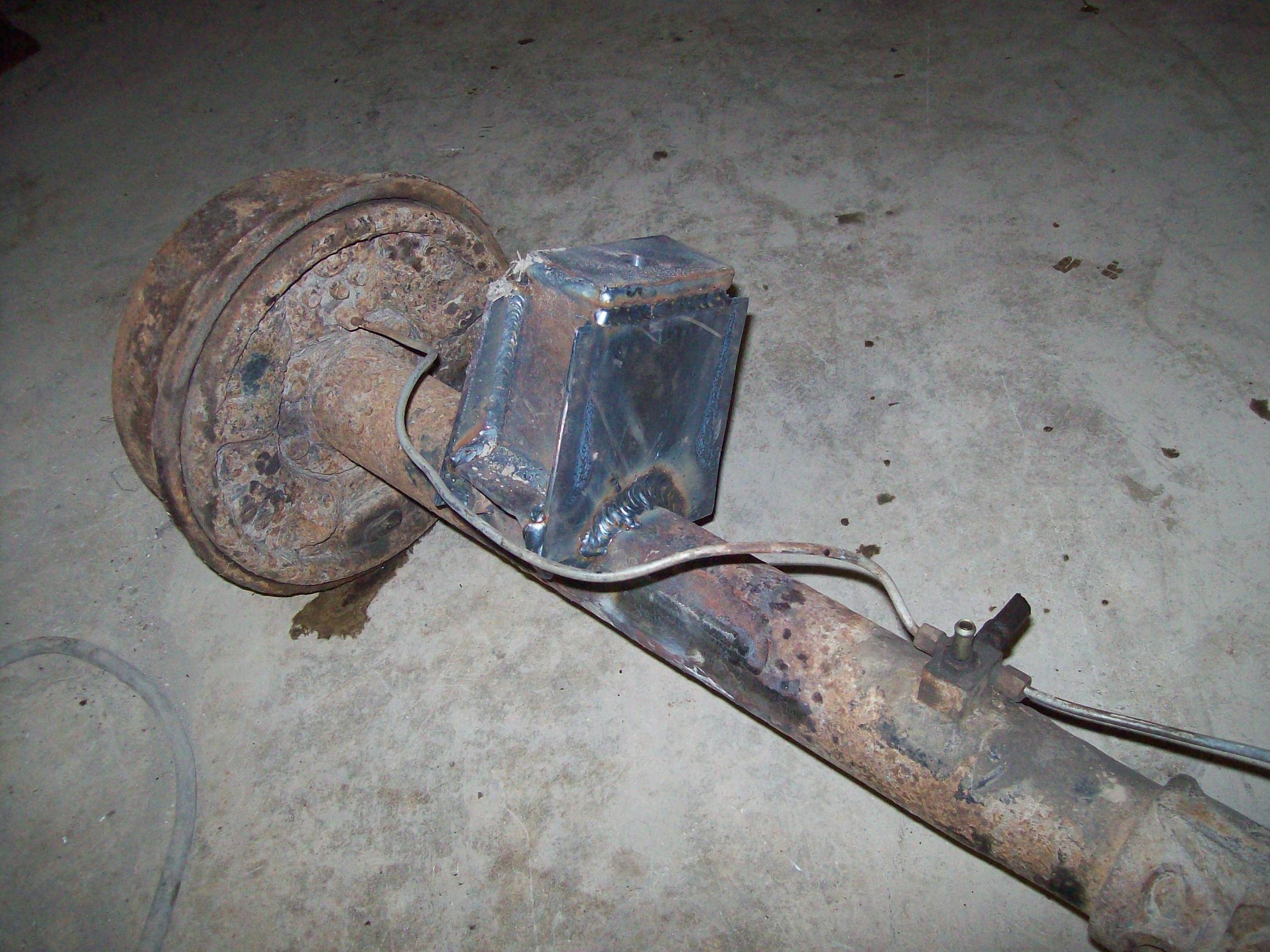

that axle you just posted in the rear is that the fullsize axle your using? it only has 5 lugs. a k5 blazer front is gonna have 6.

yeah im gonna be running two different sets of rims for now. not one of the major problems right now..

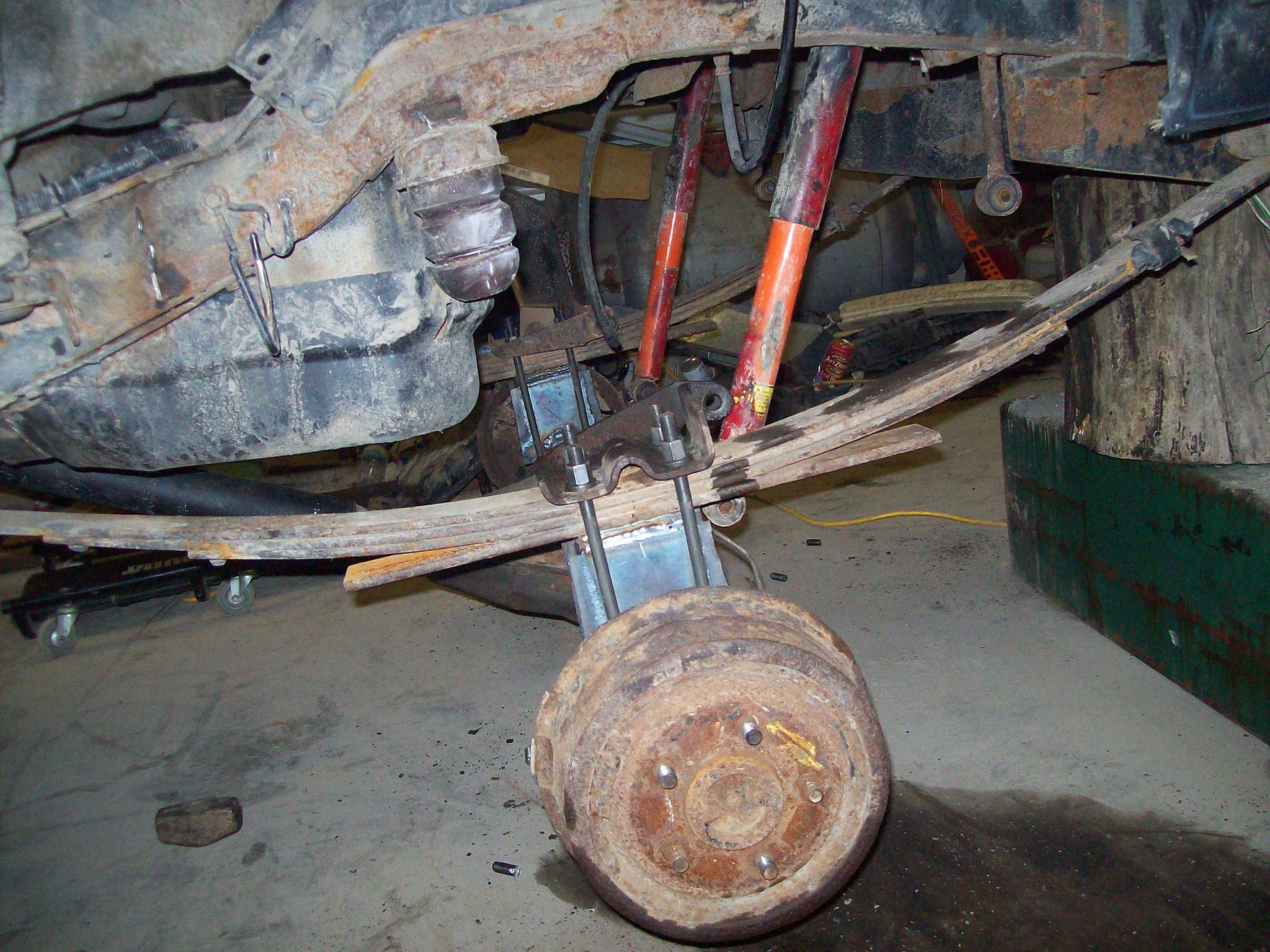

i hope these can be of some assistance. good luck on the build! And the leafs up front truck rides like a dream. blazers are way to soft up front stock. my opinion..
Attached Thumbnails PROJECT solid axle swap/lift-jimmy-project-049.jpg   PROJECT solid axle swap/lift-jimmy-project-052.jpg   PROJECT solid axle swap/lift-jimmy-project-055.jpg   PROJECT solid axle swap/lift-jimmy-project-058.jpg   PROJECT solid axle swap/lift-jimmy-project-060.jpg

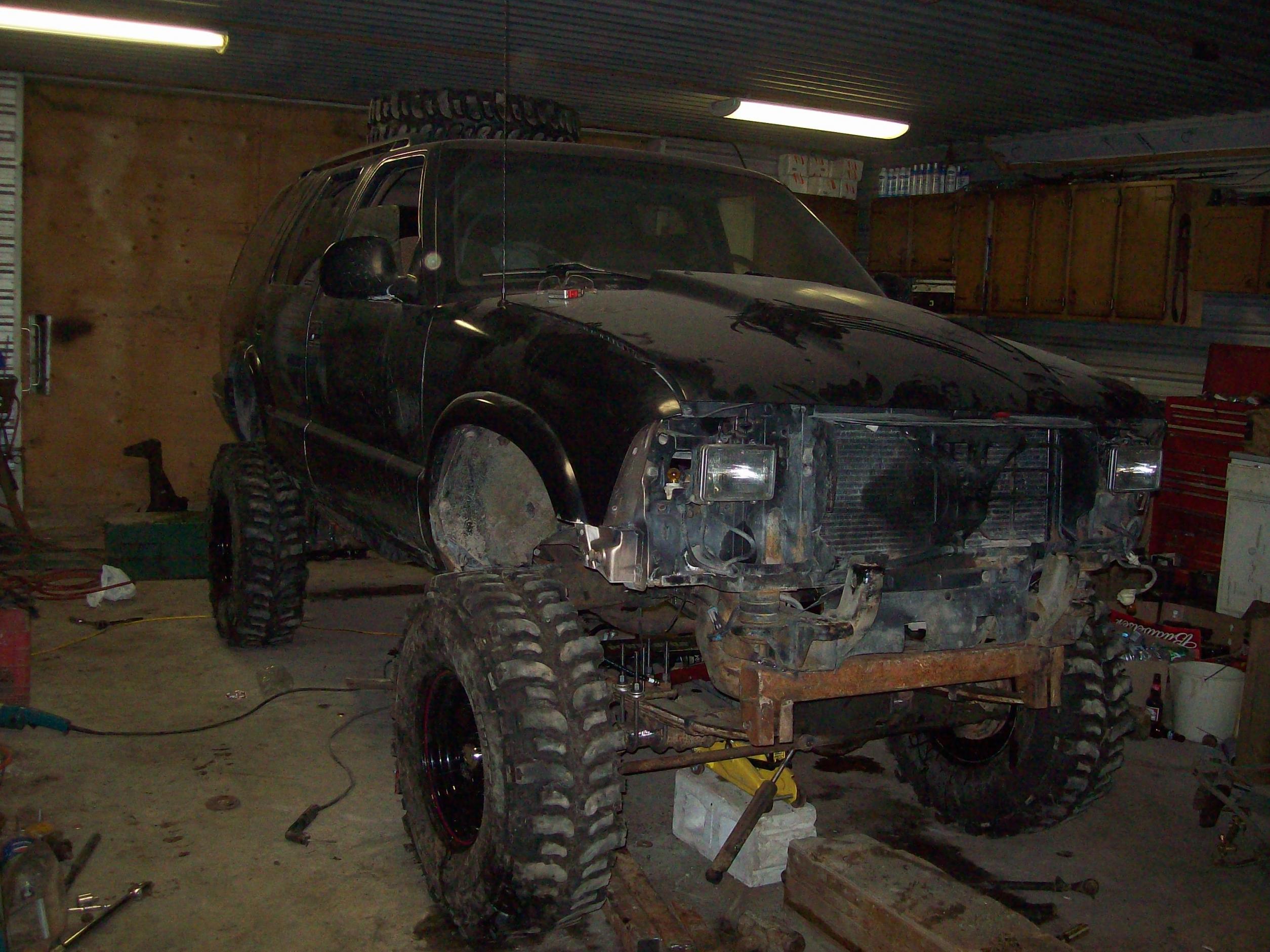

got my crossmember in place, 5x5 square tubing, 3/16 inch thick
pics tomorrow in daylight
welding tomorrow, also cutting gussets and the rear hanger box out as well
thanks for those pics, kinda same idea as mine will be
i going with ford super duty springs from a turbo diesel... hello lift, haha
boggers on the way

rained today so couldnt weld..
got gussets and front hangers cut and clamped in place, shooting for tomorrow afternoon to weld everything in.
also still trying to figure out what to do with the backside of the front spring, couple ideas running through my head on how to box out the frame as easy, but as solid, as possible. any ideas ?
