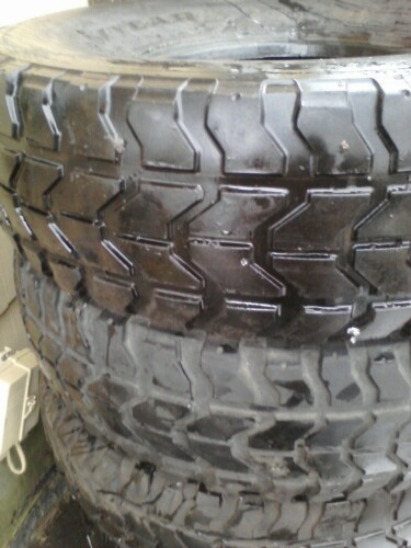

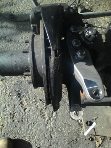

put my new steering knuckle and arm on, also changed the driver side spindle

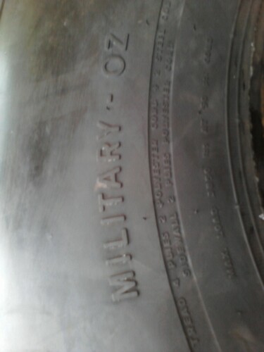

bought tires yesterday, 37x12.5 goodyear mtrs off of a military humvee. theyre even stamped "Military OE" haha. waiting for my frirend to weld up my drag link, already cut it to size. just need rims and im ready to go. leaving for florida tomorrow though, so i guess its gonna wait a week.. uploading pics now

Damn! 37's? Those will be awesome. Got any pics of them? Pretty cool theyre stamped with Military OE too lol.

Pictures are a must with those tires. Lol Sure wish I was heading to Florida now

tires and knuckle
