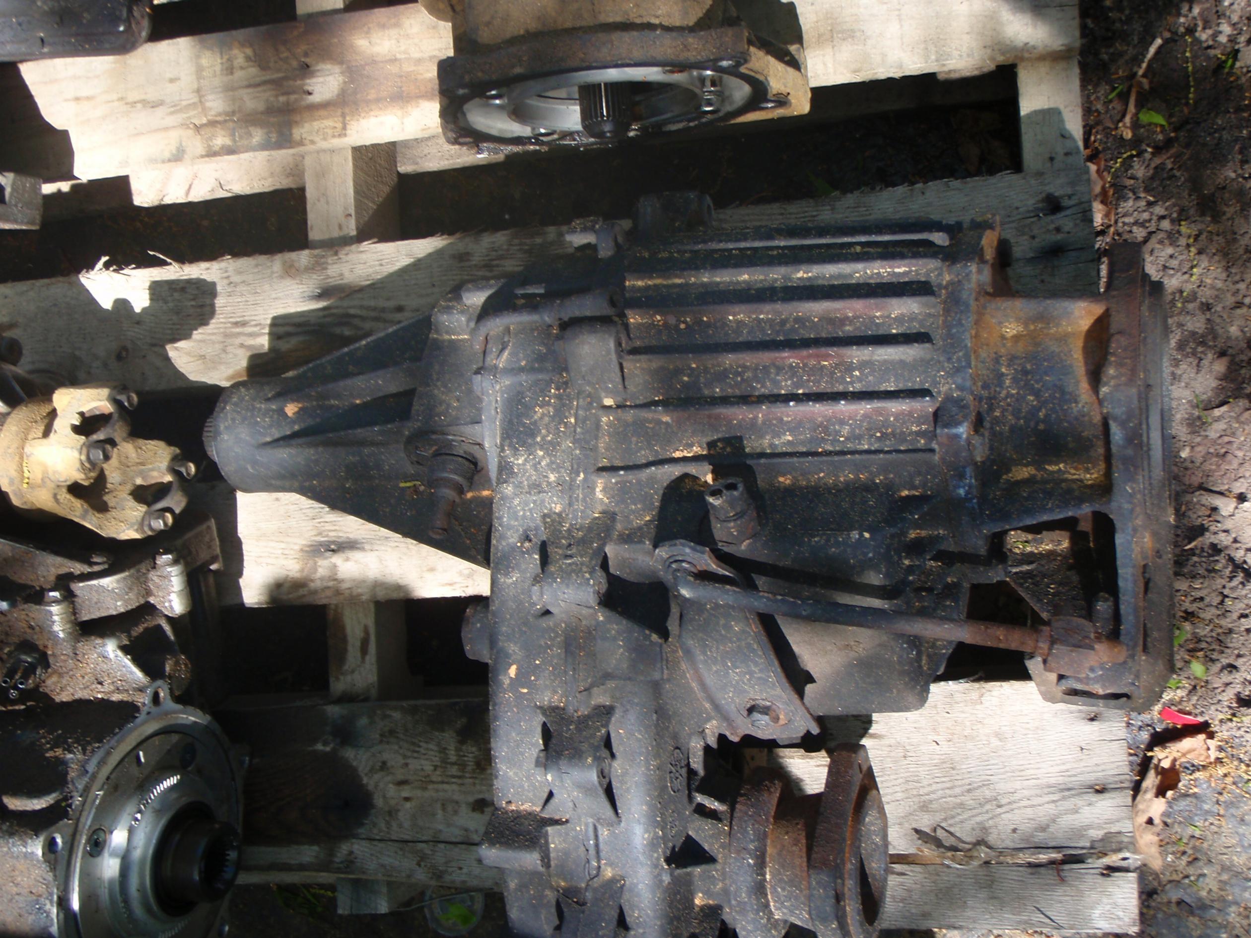

okay so now that we determined i have a 700r4 and im going to run the np208 transfer case, do i still need the vss from that jagsthatrun website? or was that only with the 4l60e ?

That will depend on what year of 208 case you have. If its an earlier model , with a cable speedo then yes. If its a later model with a VSS already in it then no.

its this one. theres two spots on the top, one looks like a cable and one looks like a sensor, haha

Thats a 4wd indicator sensor for a light to tell you what range your in. your speedo will always be on the tailshaft. so you have a cable speedo Xfer
Does your transmission have a kickdown cable?
