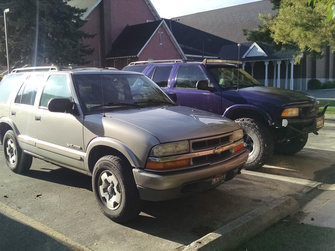

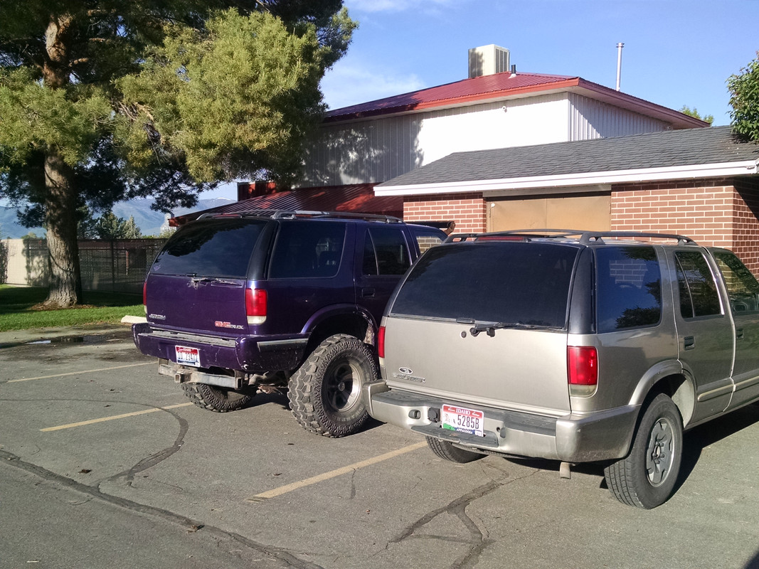

Had to take a couple pictures of this blazer next to my Jimmy.
