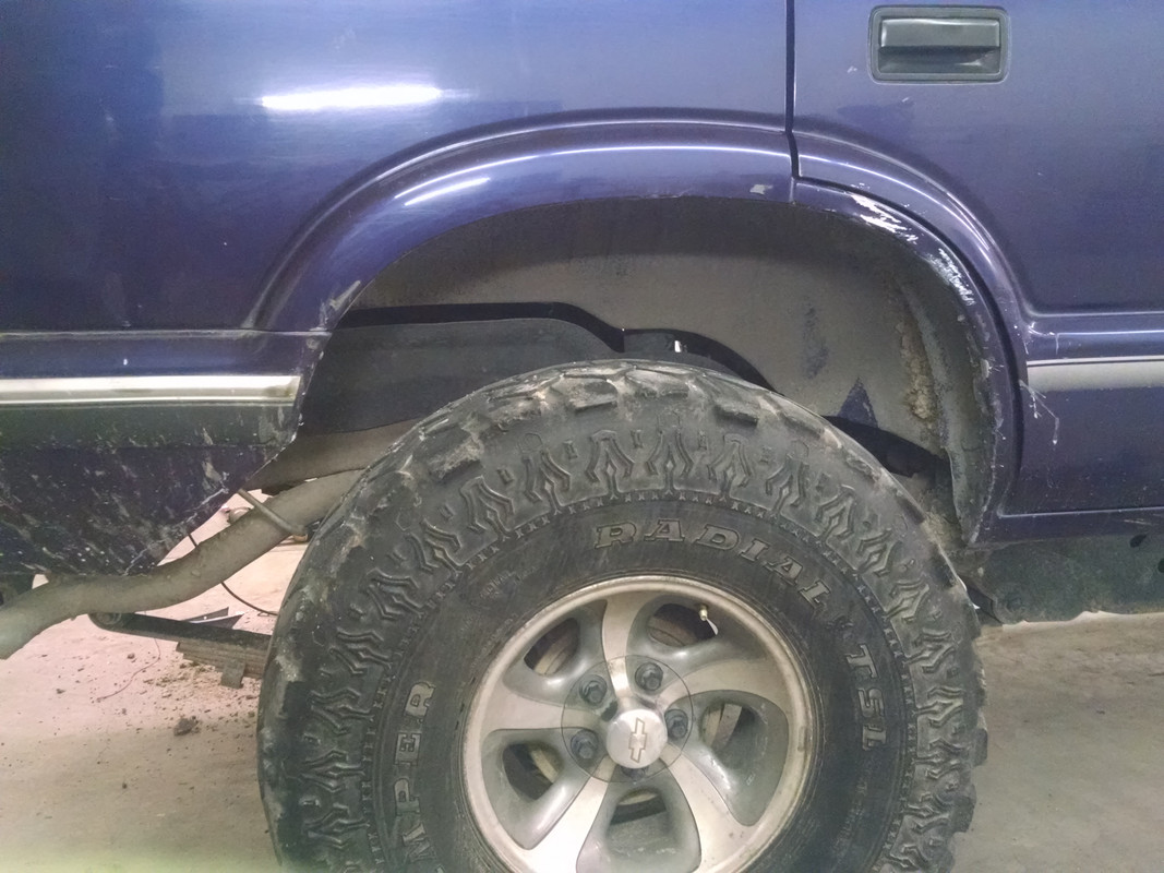

I redrilled my spring perch today and moved my rear axle back an inch and a quarter. That got the rear tires away from the rear doors. I trimmed the back of the rear fenders. No more rubbing! I did notice 90 weight all over the drivers rear wheel well. Axle seal is shot and I've got some play in the bearing. So going to replace the axle, bearing and seal.

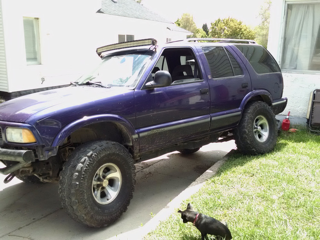

Originally Posted by Hess13x
Looks like the dog is attempting the same flex....with different results.

Lmfao! I never noticed him before. Looks like the gfs chihuahua... except hers is a long haired who's hair isn't so long lol...

Damn, photo bombed by the wife's dog! Lol I didn't notice her. That would be Grace the wife's ratcha. Rat terrier/ chihuahua she keeps my 2 pit crosses in line!

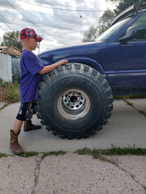

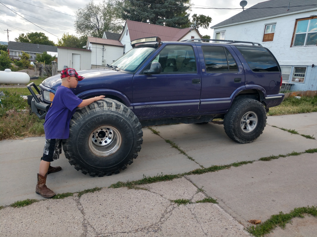

What's everyone think? 44s on the Jimmy? Lol

Theses are going on my 82 suburban.

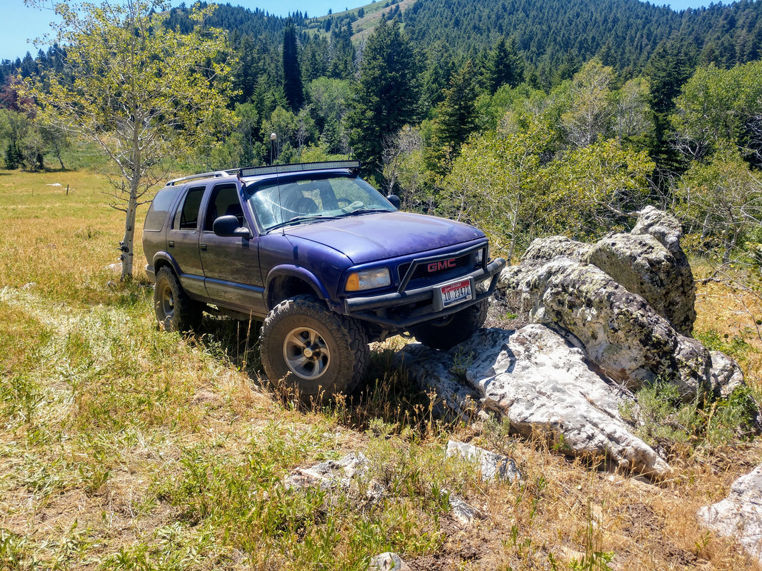

From: Idaho

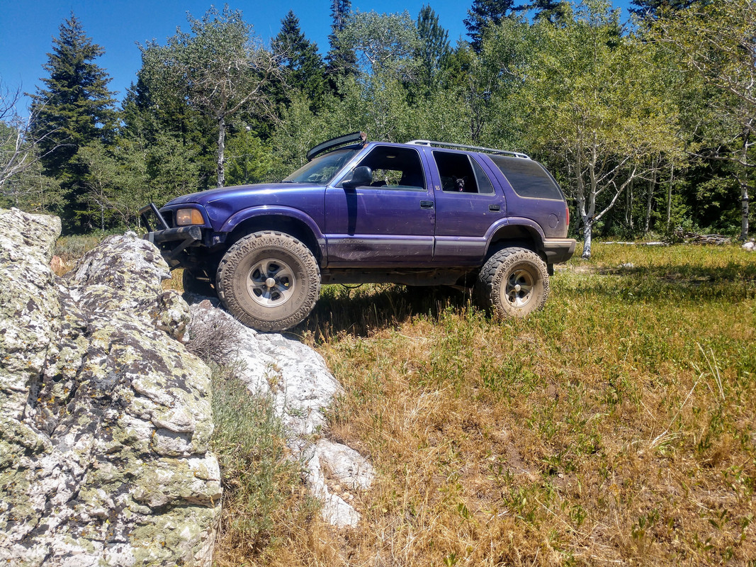

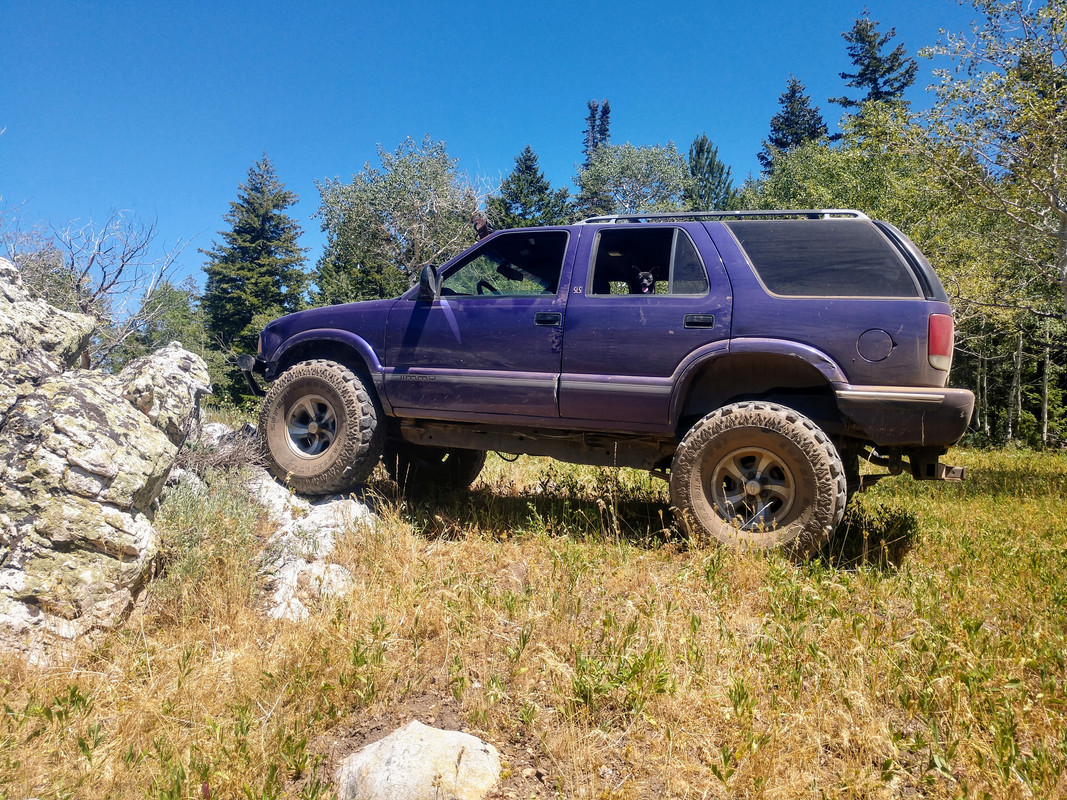

Took the purple mini monster up in the hills to get out of the heat. Ifs with aftermarket keys doesn't flex! I need to remove one spring out of each side of my rear packs. I also need to get a locker put in the rear.
