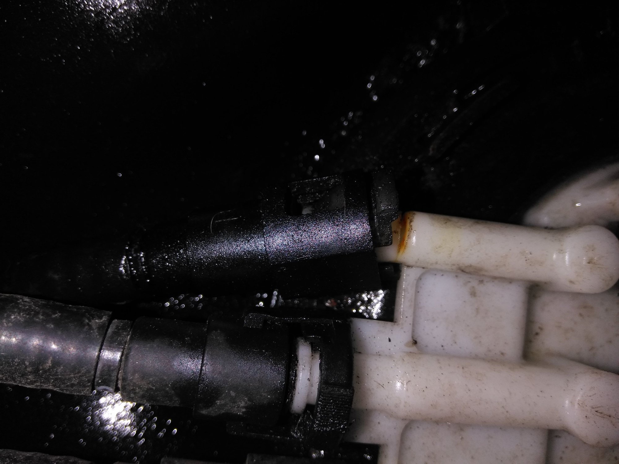

Replaced the vacuum lines for the 4x4, PCV, and the vacuum hoses running to the Breater/EGR actuator down infront of the clutchfan, Now it idles consistently. Located a fuel leak in the process, Can anyone identify what line is bent? its on the drivers side of the fuelpump.
EDIT: It was a snapped spigot on the fuelpump, so i get to drop the tank it seems.

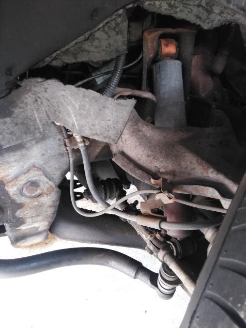

Discovered a leak in the P/S cooler loop, 58 f*&^ dollars for a replacement! NOPE
that brings the total of leaking fluids to 3, OiL, P/S Fluid, Coolant.
This truck just wont let me love her. Also installed the hingepins and new bushings from a combination of dorman and needa kits yesterday which drastically reduced the amount of sag on the drivers door. the passenger side though it much more worrying as its straight up missing most of its bushing.

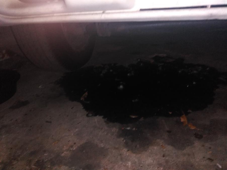

Spun it around in prep to drop the transaxle down as far as i can without pulling the CVs, all to replace the timing cover, jesus.
The Oil leak.

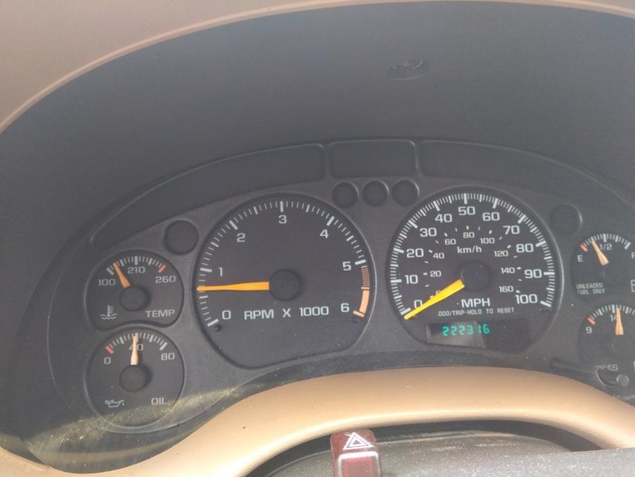

Putting a few miles on her now, last look at the odo read 222,319 and outside of poor running at low RPMs while cold she's in good shape. i need to start working on the body rust issues that are cropping up, big ones being the liftgate, rear drivers side rocker panel corner and above the passenger side rear cargo area glass.
Outside of the body she is very clean.
