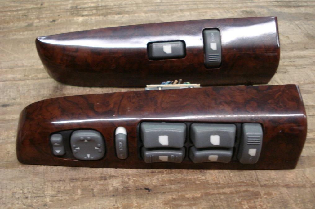

Payday came and new parts are on the way

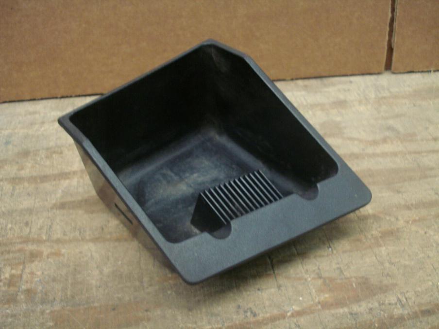

Found a set of Bravada Switch housings for the Power locks/mirror's for the driver/passenger side. and an Ashtray liner, seller is called s10warehouse on Ebay, i got the last set of Switch housings but the ashtray liners are still in stock.

New parts came in, atleast the swtich housings did, now my power mirrors work in 3 of 4 directions! vs the 1 in 4 i had with the stock switchbox.

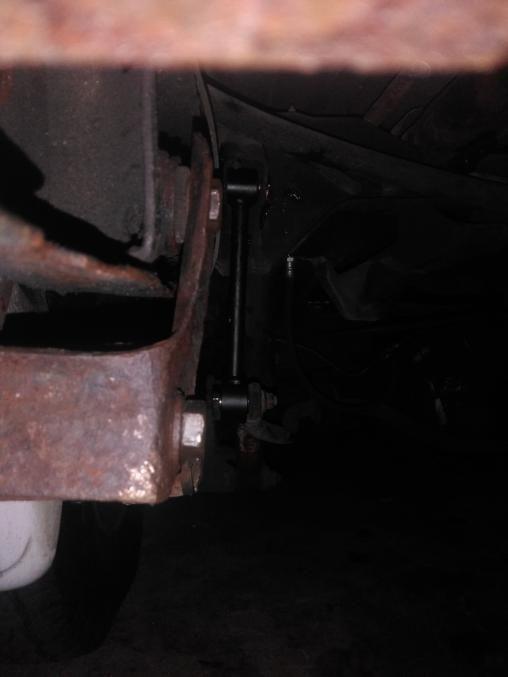

From: West-Central Florida
Did the swaybar endlinks and was painfully reminded of the dislocated axle, as far as i can tell the drivers side spring has a twist that i cant get rid of so its going in the pile once i have a pair of new springpacks.

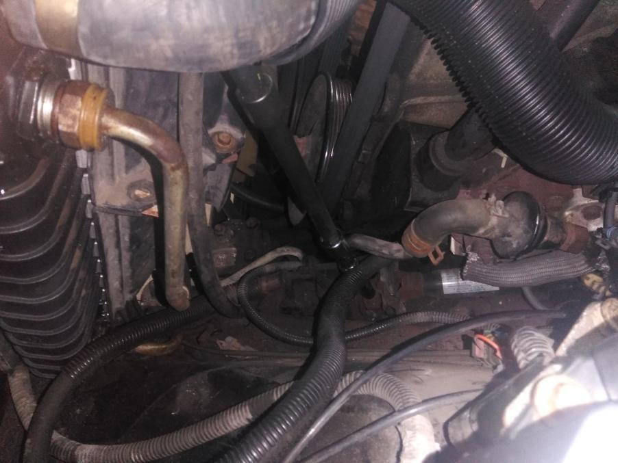

Soo, i ****ed up. Or more specifically i blame california for this.
That, is the Passenger side Checkvalve on my 99 Trailblazer. Being part of the California emissions package as far as im aware of (K18 RPO Air injection pump). my truck already had an exhaust leak, and i had a gut feeling to turn off the metal on the radio (wherever i may roam was the song, had it cranked) and i noticed the exhaust note was different, almost like it was running open manifolds even though the leak was at the catalytic converters forward flange...
I knew what it was as soon as i heard it, and i have never parked a vehicle so roughly and quickly as i did then and never will have to again hopefully. Does anyone have a schematic of this harness (main engine harness, passenger side where it goes down to the airbag sensors, K18 pump and the alternator) and what wire gauges are in it? going to get some 1 inch splitloom and the right gauges of wires and repair the harness as replacing the entire main engine harness is a task i lack the money, time, and sheer brass ***** to do currently. (truck was running when i parked it. so it did not get into the harness too badly, no lights on dash save for fuel light)
TL;DR I Blame california for nearly setting my truck on fire, if the valve blew a c-hair of a second earlier i would be staring at a monolithic piece of molten steel. And yes, those hose clamps were very loose, previous owner repair it seems like. this had happened once before but i cant tell if the second spot i found is new or not. it looks very dusted over so i dont think it was recently melted in that patch, the spot i pictured though was a repair i did because the wires were way out of the loom for some reason, so i know that damage is new
