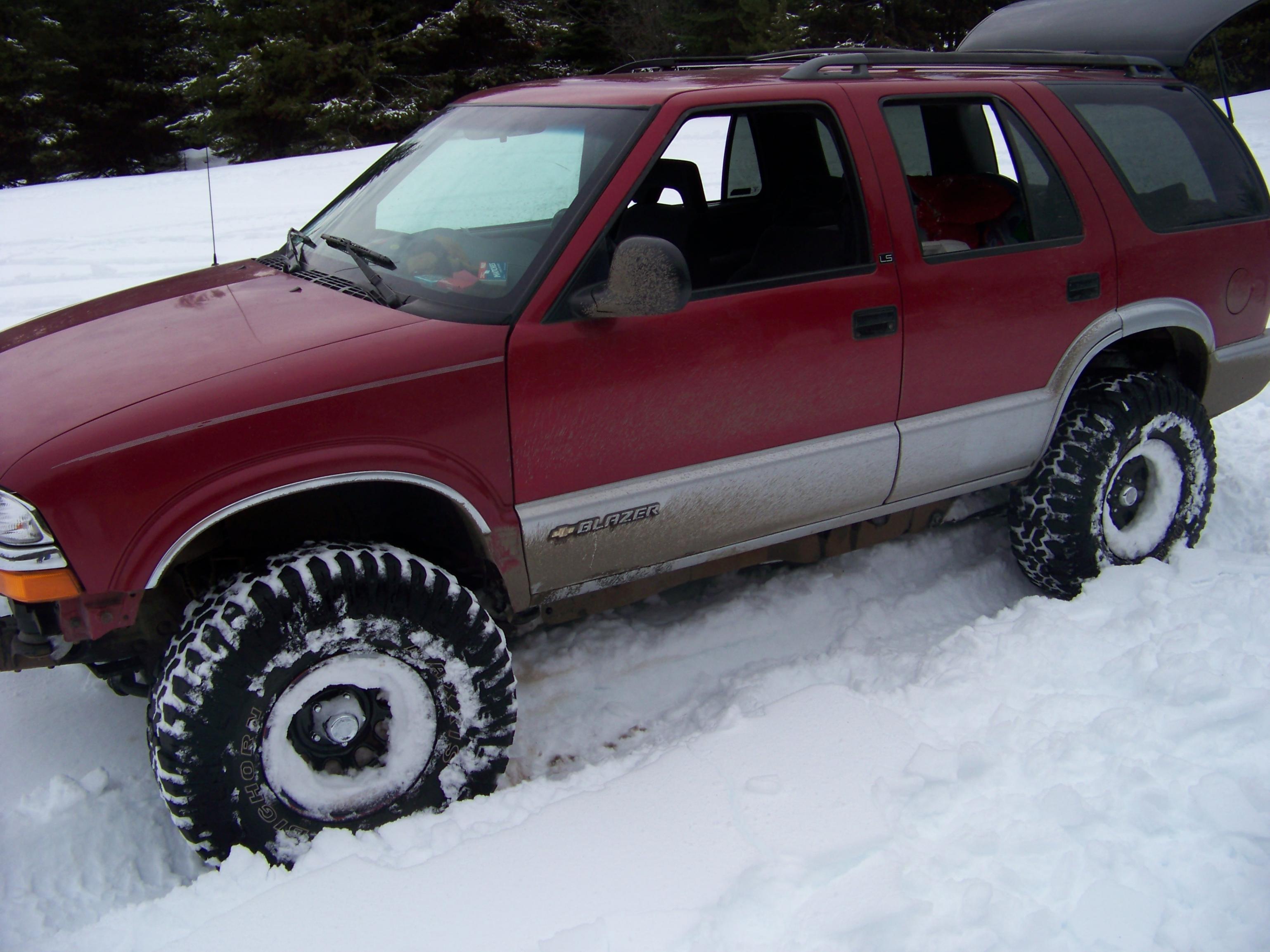

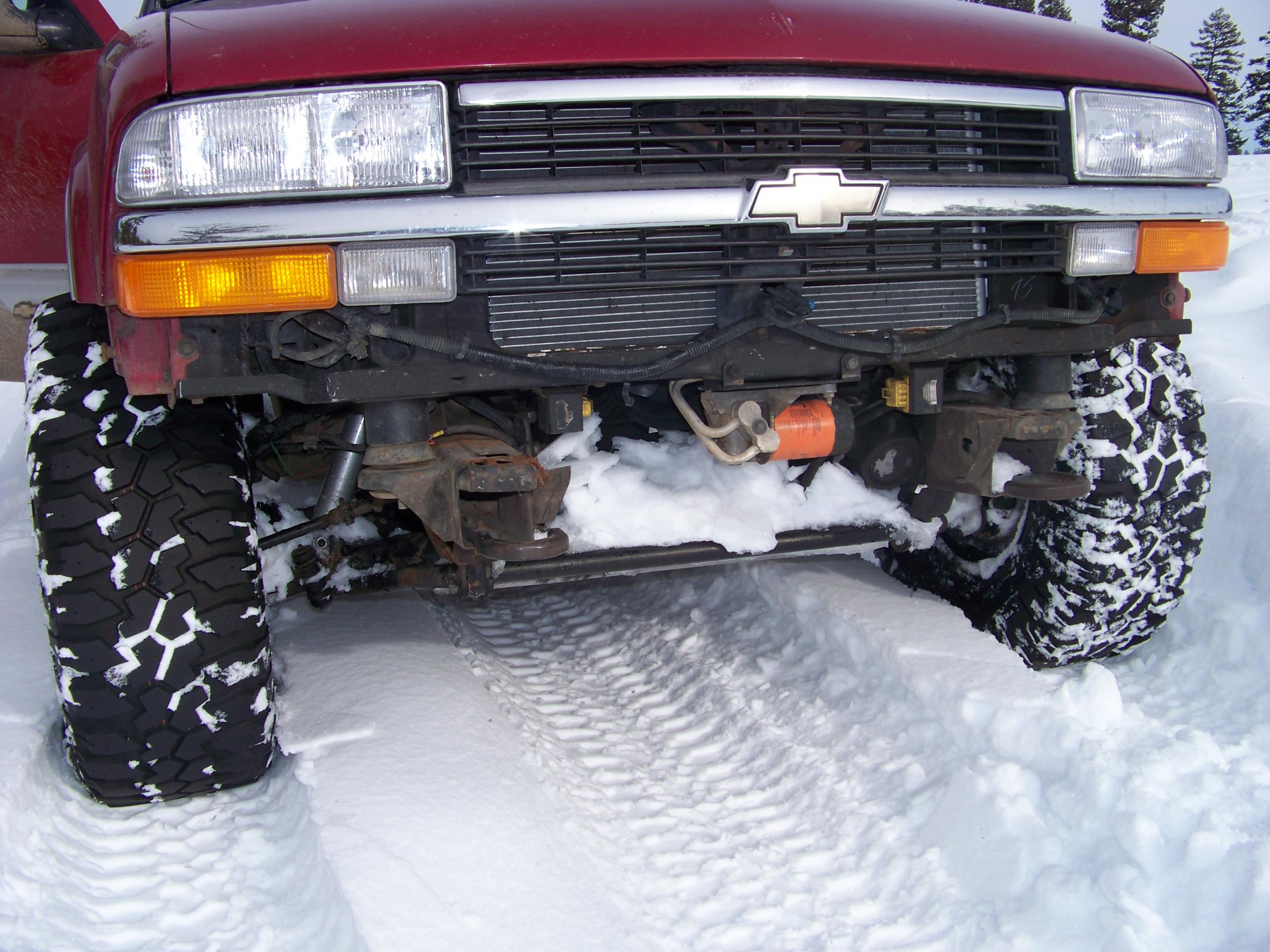

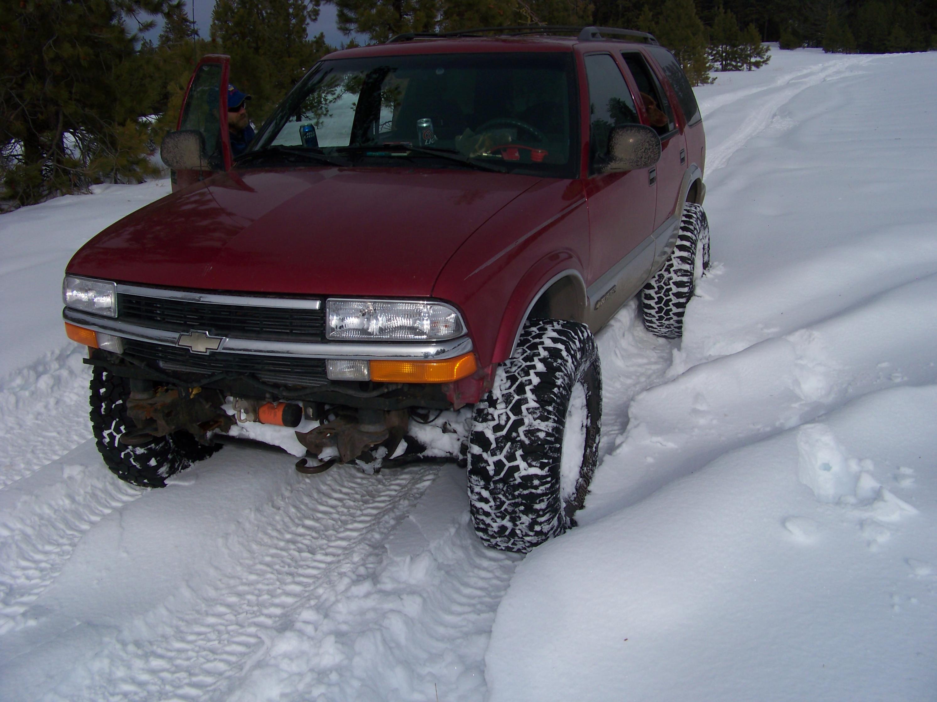

Rough Country  2.5" Lift!!!!-100_1109.jpgjust thought i would update some photos
Rough Country  2.5" Lift!!!!-100_1110.jpginstalled 33" maxes bighorns

also just bought a dana 30 axle and going to be installing a solid front axle, looking a coilspring kit from 4wdfactory

I'd say mine are cranked to the 2.5" mark, the 33" are still tight even with the 2" body lift and the cutting of the front fenders.

In your opinion how much did the diff drop lower it? And got any cv angle pics after? Looks good on 33's, Definitely jealous

I'm going guess that it was only about 1/2". Okay now why do I say that, If you look at the kit the right side shim was probably a 1/2' taper on it. It is used on the passenger side of the diff where it attaches to the frame. I didnt measure the before and after on the drop brackets, and I was suprized on the lack of drop from the brackets. But its a tight area in there and any kind of drop to keep the angles from being to steep helps. Its crazy how we are all looking to improve on looks or function of our vehicles, and now I want more. My next goal is to stuff 35's under there and its not that I dont have something else in my fleet of vehicles to get me to the snow, my 97 ford has 38's under it, and our play toy is a polaris ranger full cab with tracks. So a couple month go by and I should be straight axled up front. Now that's crazy I just put this kit on not long ago.
