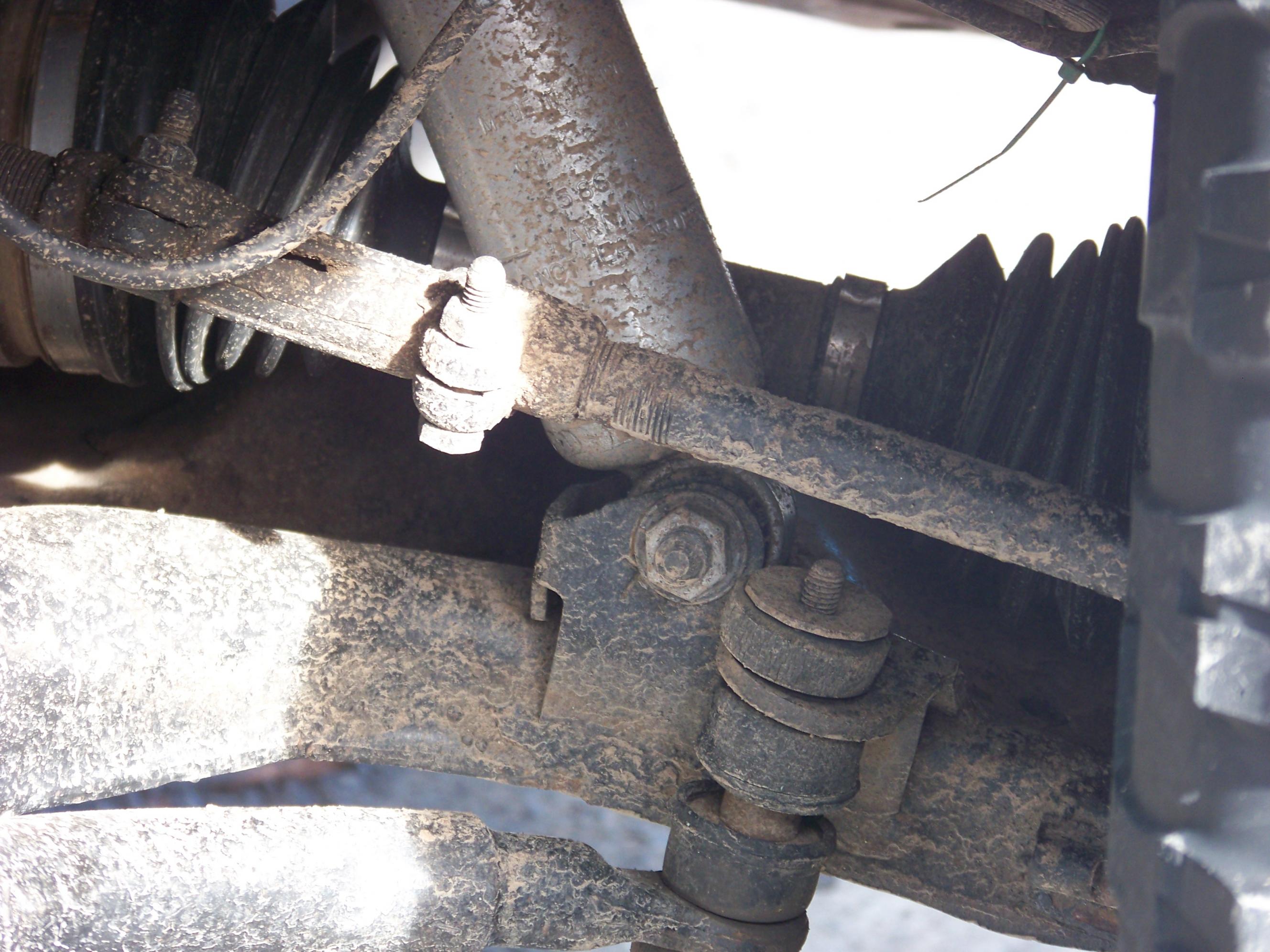

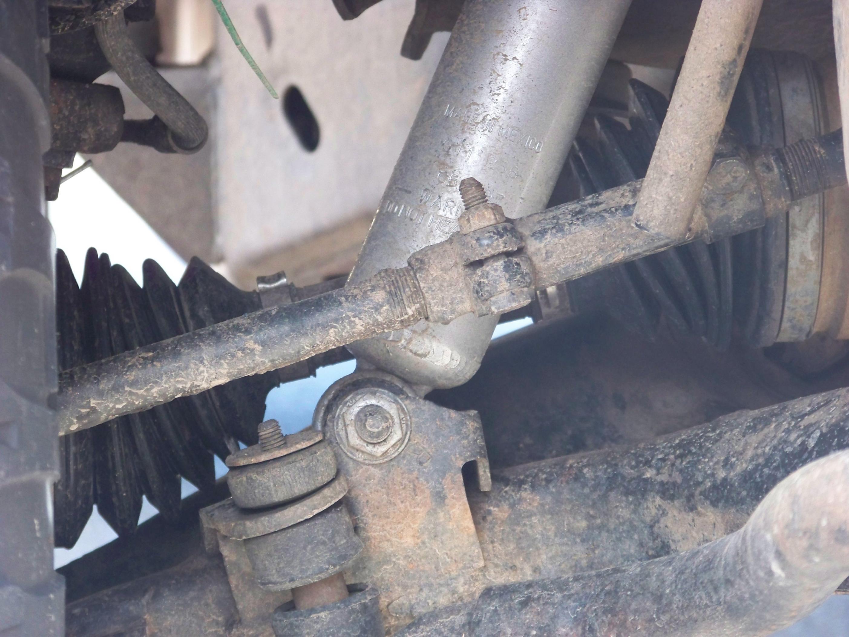

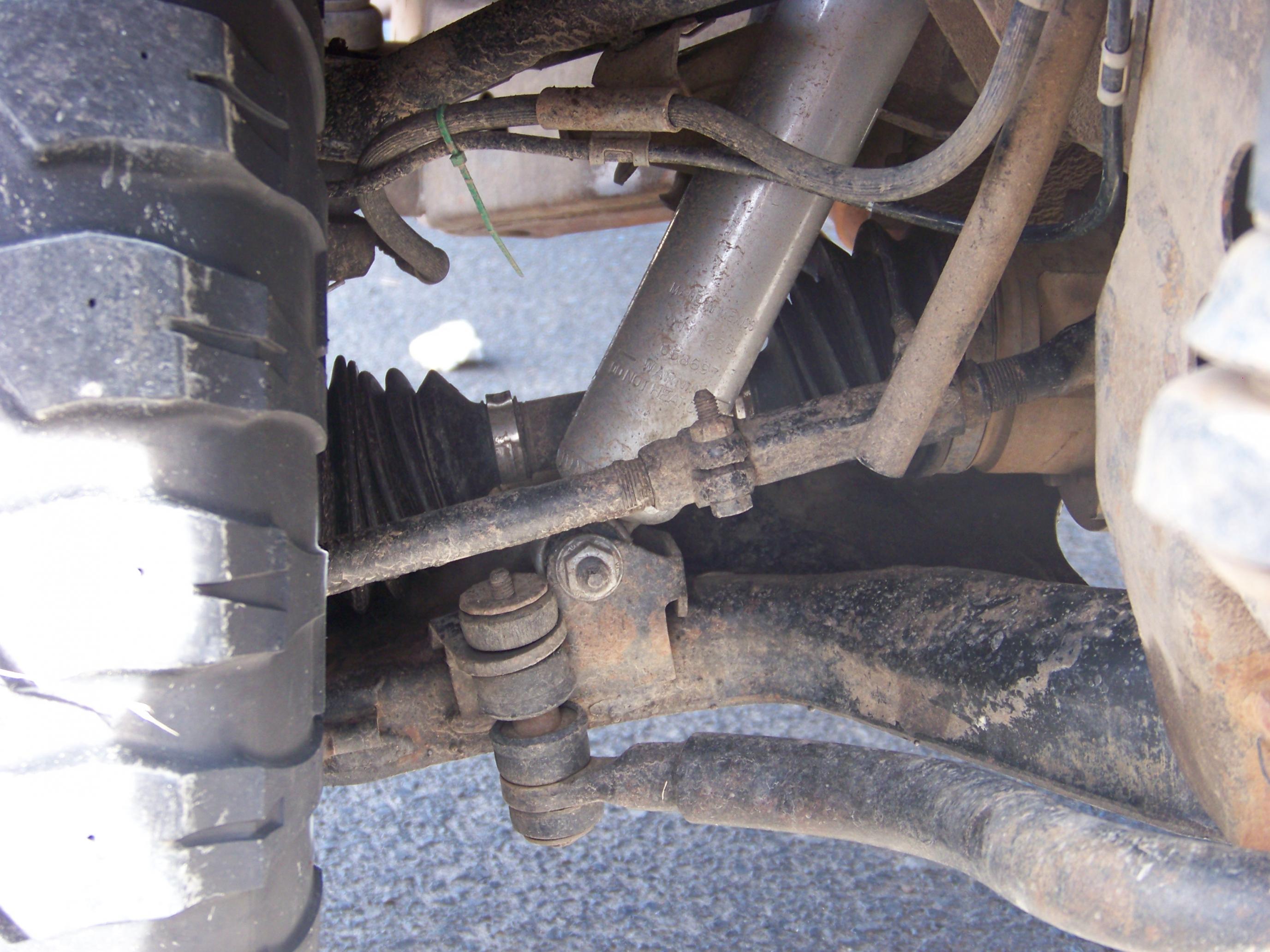

Oh, yeah I'll take pic's today of the angles of the cv's.

Originally Posted by coop22
My cv angles are the same with my tbars cranked hmmm
I was actually going to say the same thing. Not the best of mine but you can see it decently. Im leaning towards not getting it
I bought the kit because all my ball joint were shot, all my shocks were shot and the upper a-arm bushings were shot. Go price all that out see what you come up with. So you buy the kit which it replaces most of those items and get a lift. Oh yeah if you had read all the posts I had done on this lift you would have read that I had cranked up my bars higher than the instructions had recommended. So its whats best for you and your set up. And my ride is far much better now than is was stock.
Ohhh alright I understand. Now my cv angles above are with my tbar crank of about 1.5"-1.75". How far did you crank yours up then? Because im figuring keeping mine this low and maybe the diff drop will really have an affect on it then
