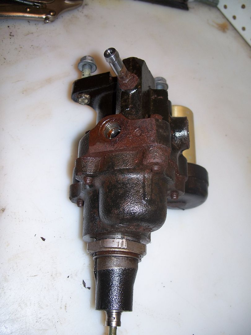

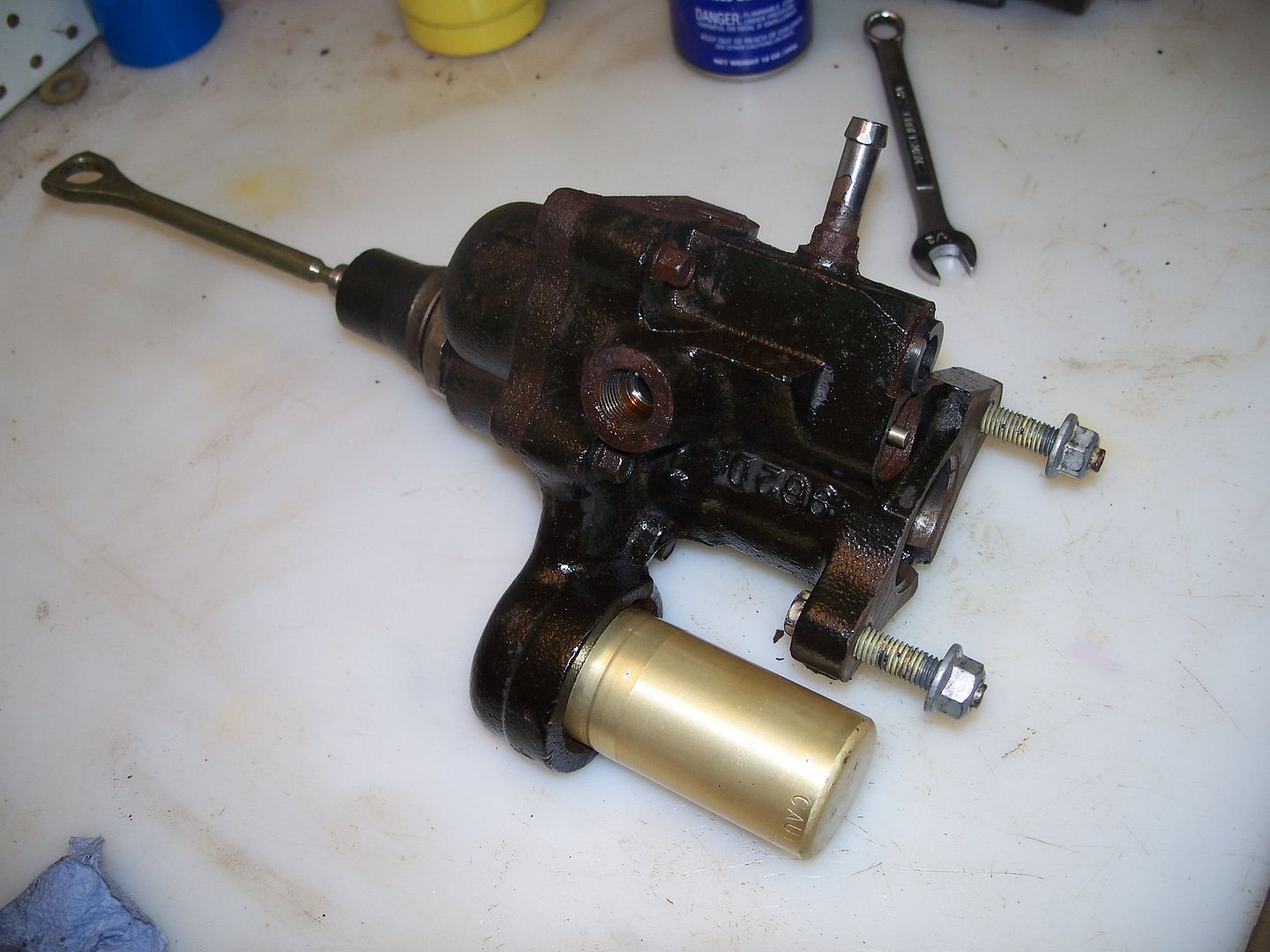

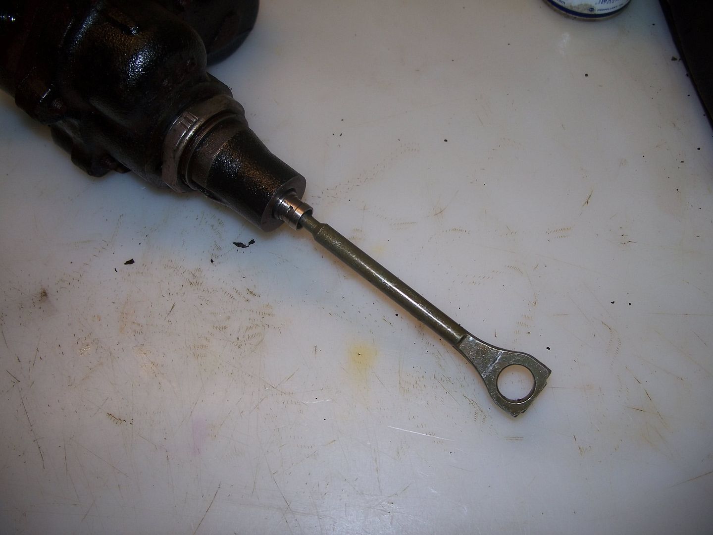

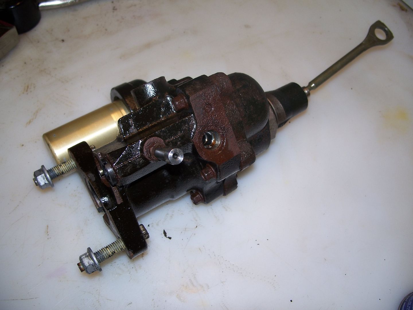

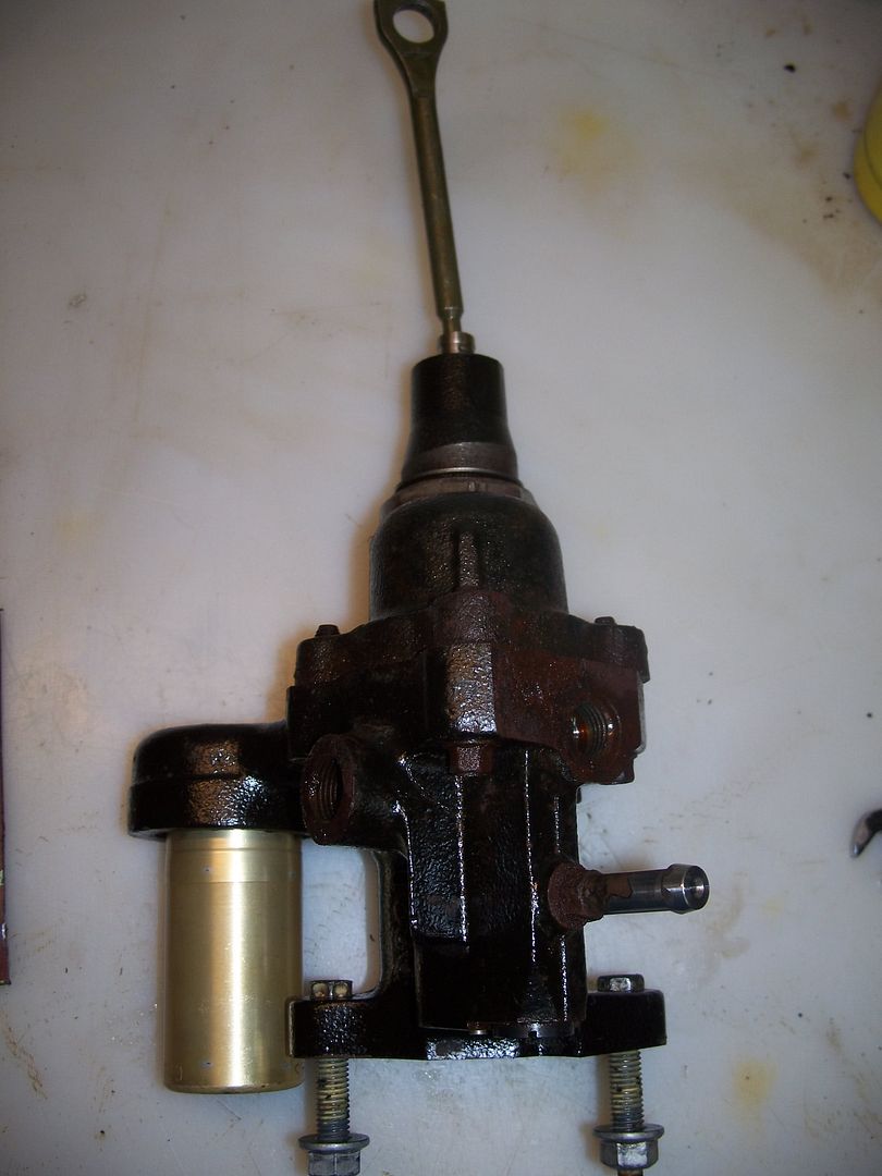

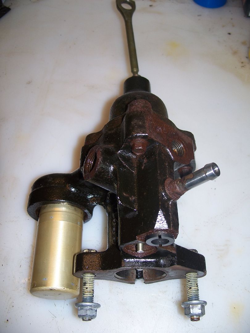

Another update...
I had an AVET class (accident victim extrication training) where we tore apart a 1996 Astro AWD. When we popped the hood off, I noticed that it had a hydroboost setup for brake assist instead of the more conventional vacuum powered booster. A hydroboost setup uses hydraulic pressure generated by the power steering pump to assist the brakes.
It just happened that the chief of my department was the one responsible for the disposal of the van after we were through with it. Gave him a call and he said I could take whatever I wanted off of it. So I grabbed the booster, master cylinder, MAF sensor, TB, ICM, coil, distributor, and other miscellaneous weather-pack connectors.
So now I need to fab up a mounting bracket that will allow me to bolt the hydroboost unit to my firewall. It actually looks quite easy. 1/4" plate of steel and 5 holes! Free power brakes and no concerns for engine vacuum if I decide to go with a bit of a wild cam!!
Here are the pictures:
