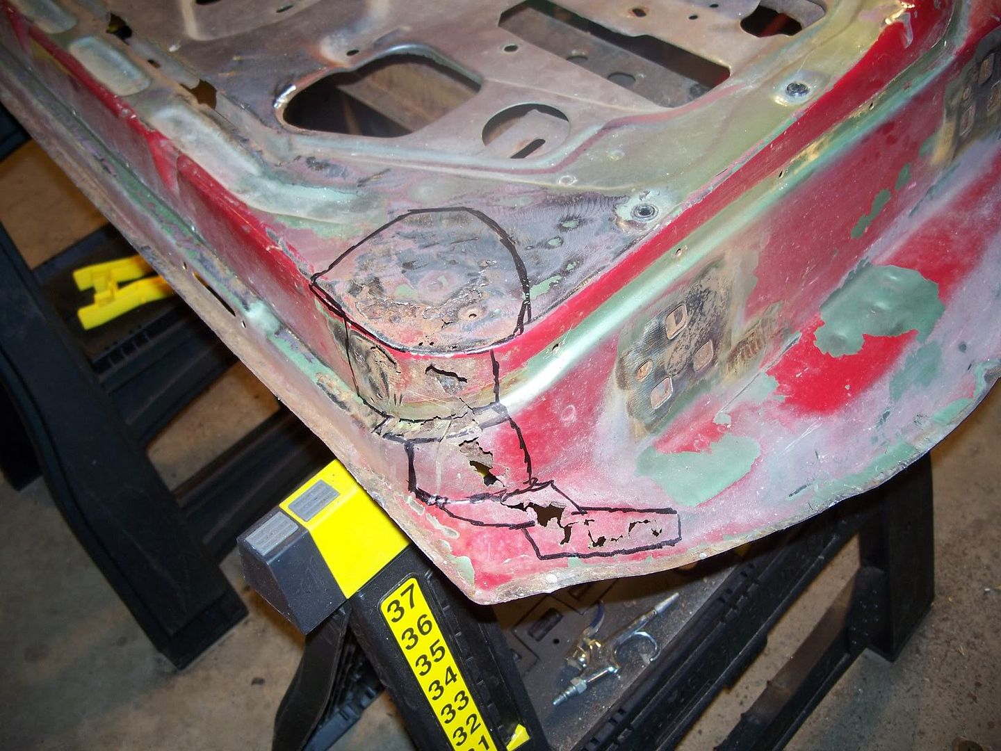

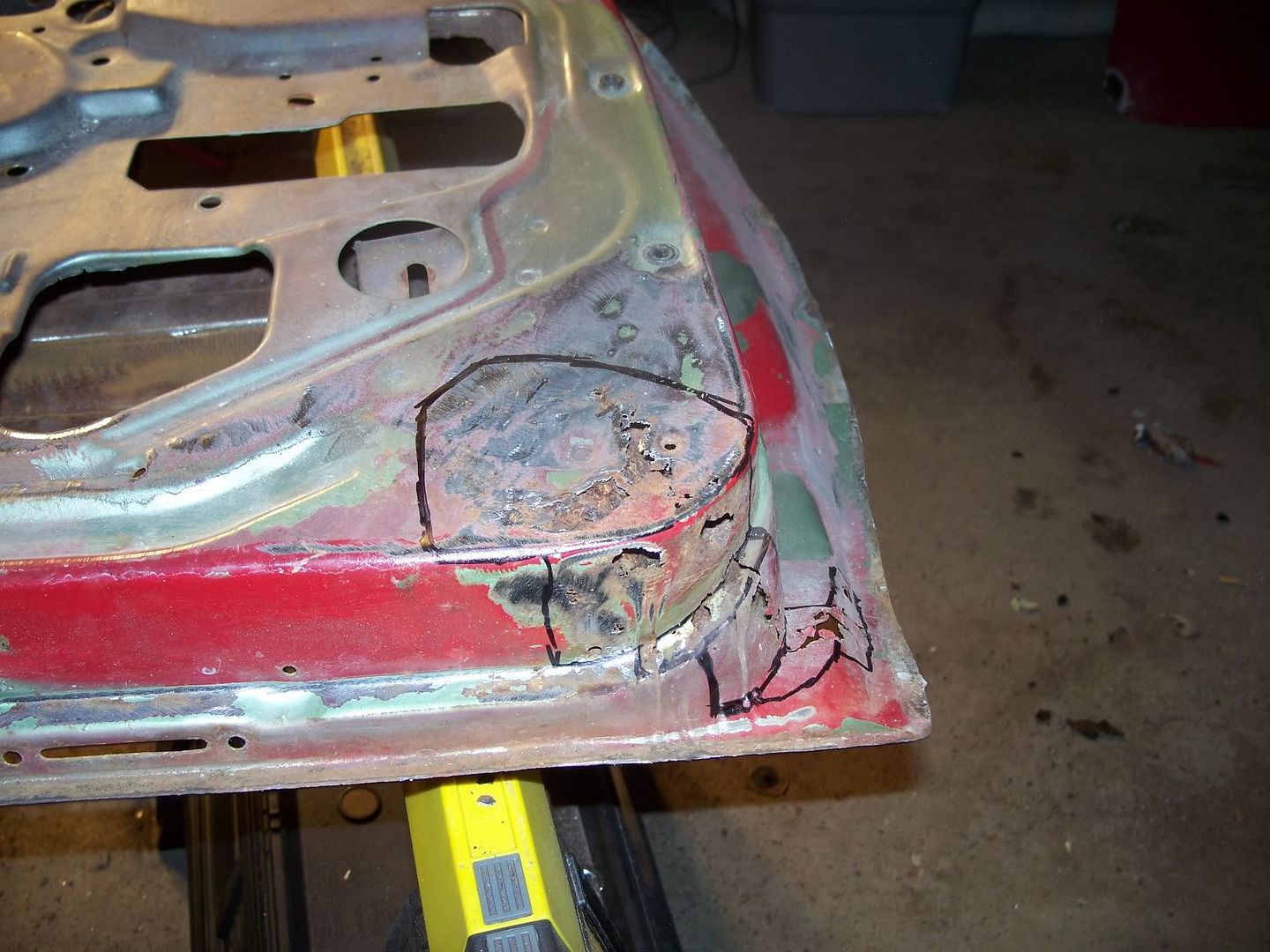

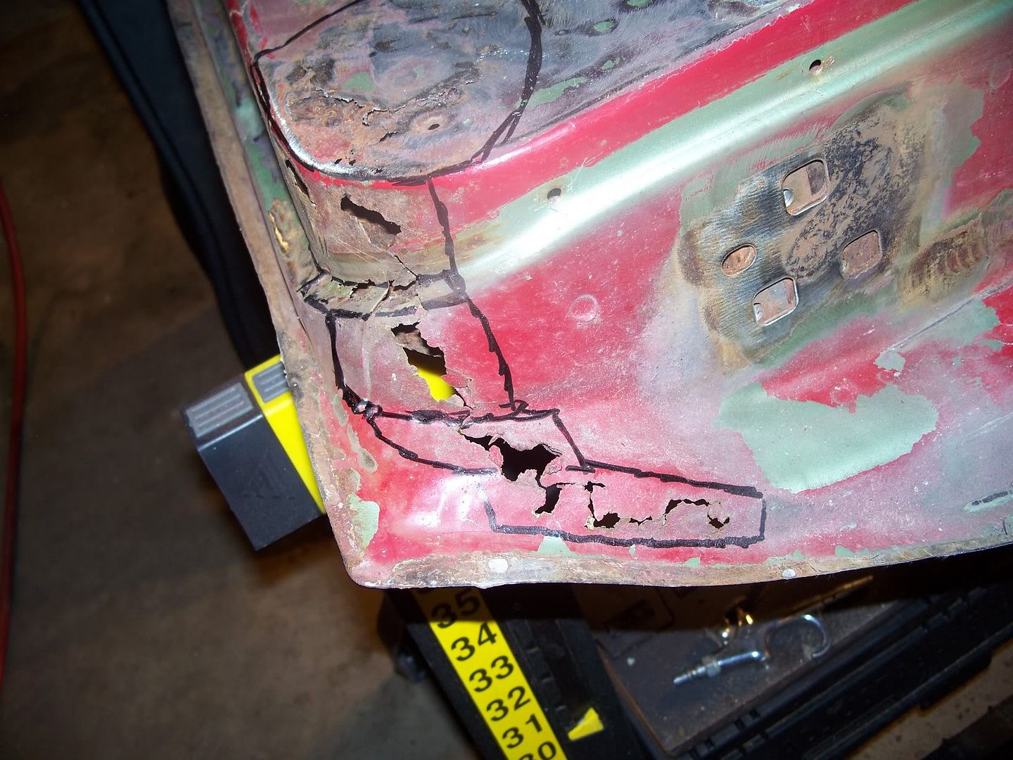

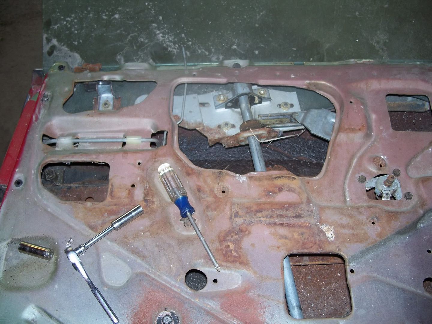

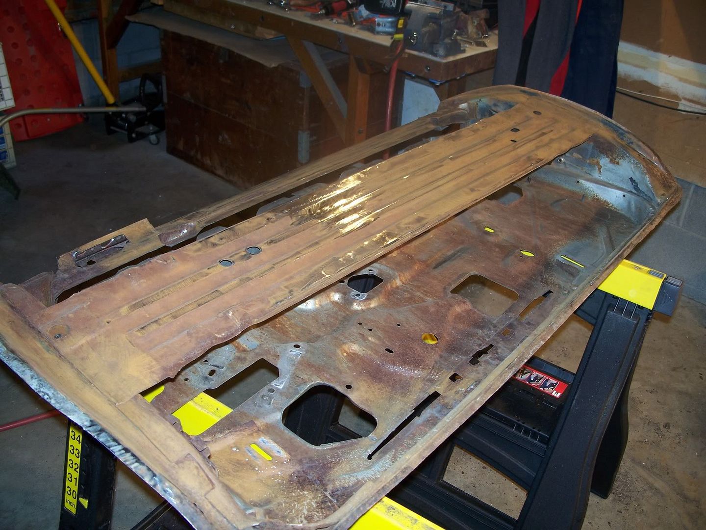

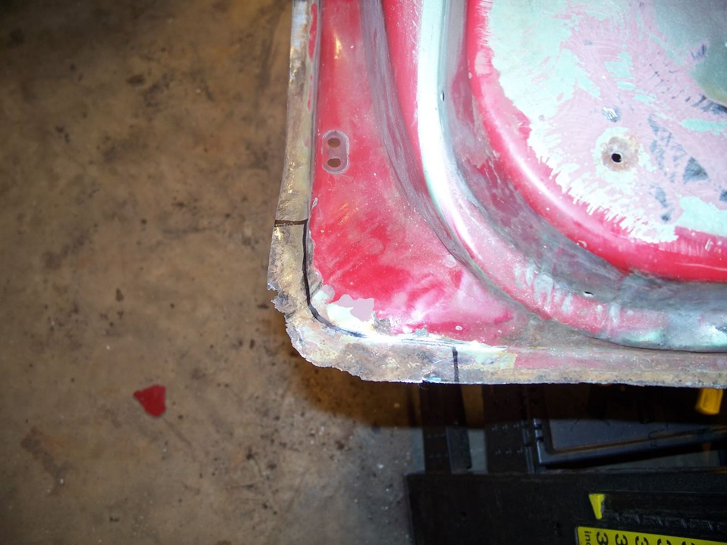

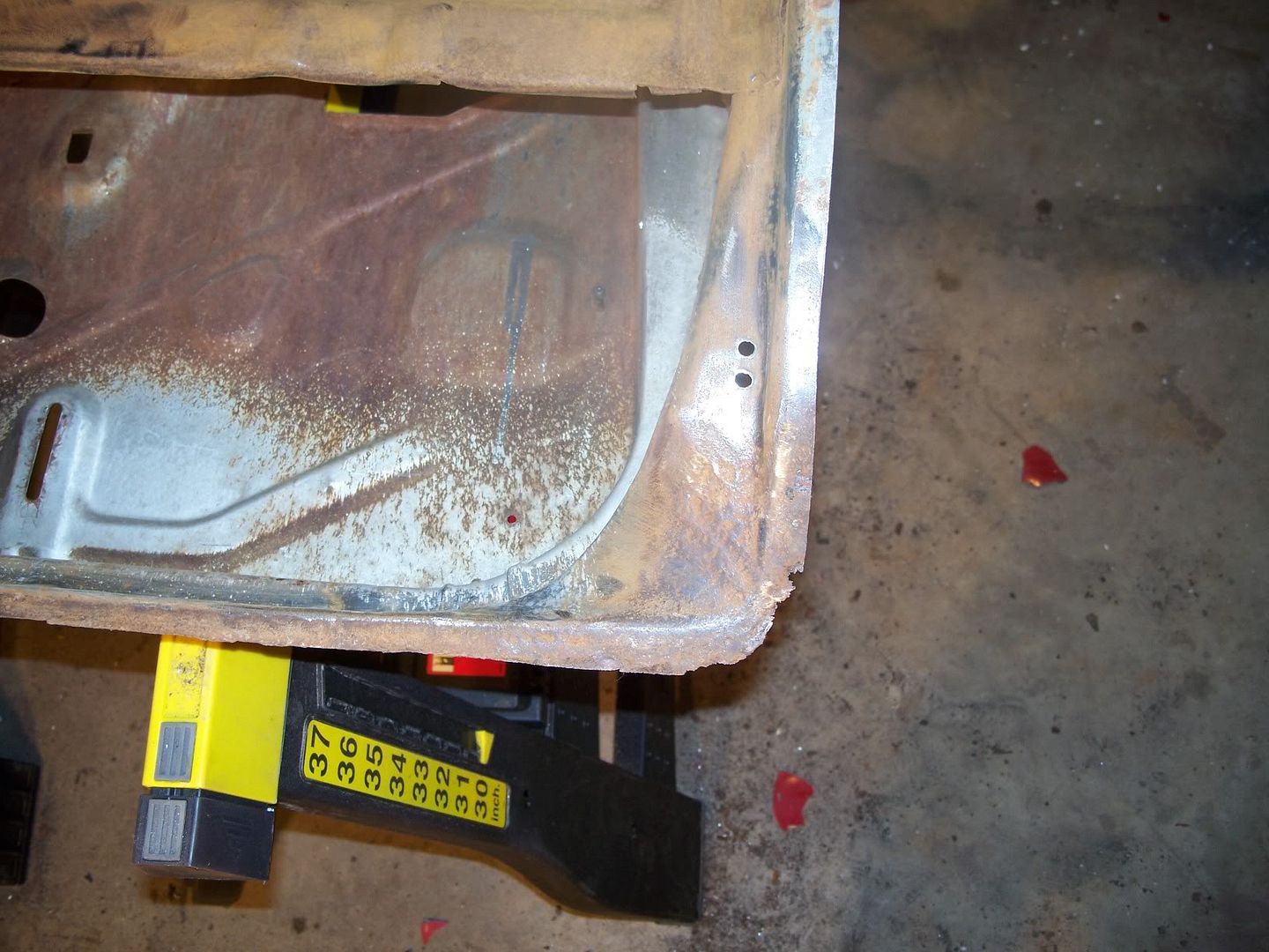

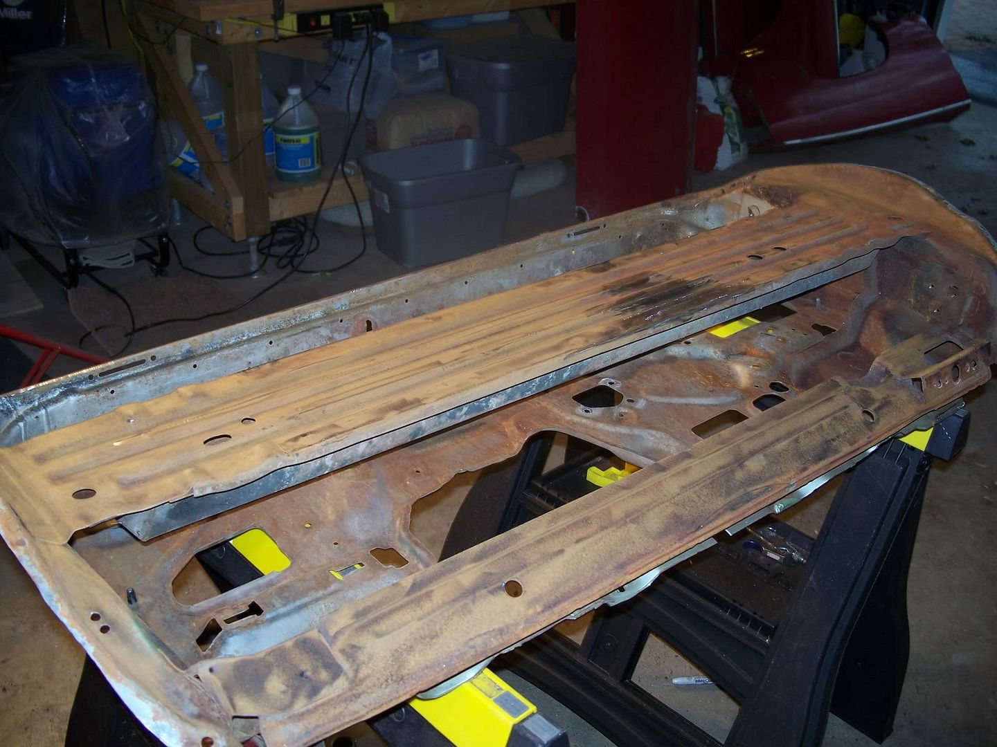

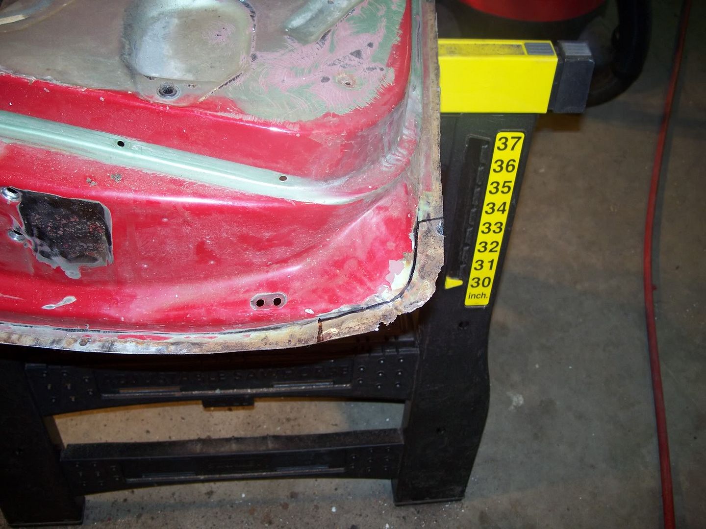

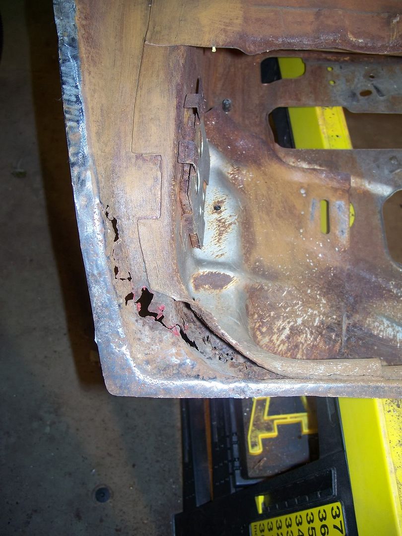

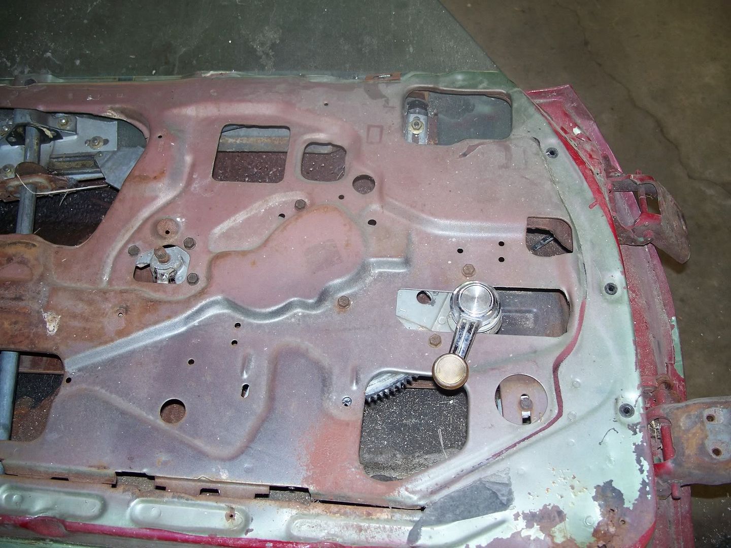

I brought the doors and front fenders to my house to be able to work on them more. Setup some nice (and hot) lighting in my garage so I could see what I was doing and got to work on the driver door today. Skin is off and all of the areas that need patching are marked up. Tomorrow I will be getting some 20 gauge steel and maybe welding some things up tomorrow night!
Here are some pictures of the day...
Documentation of where things go?
Patches to be made:
Patch areas from the outside portion of the door frame:
Frame without the skin:
More pictures can be found HERE. Most are just documentation of where things go and what they look like so I do not get confused when I put this thing back together in a few years (LOL). I will be sand blasting the whole thing before I put anything back together.
Anyway, just wanted to show that there was at least something happening!

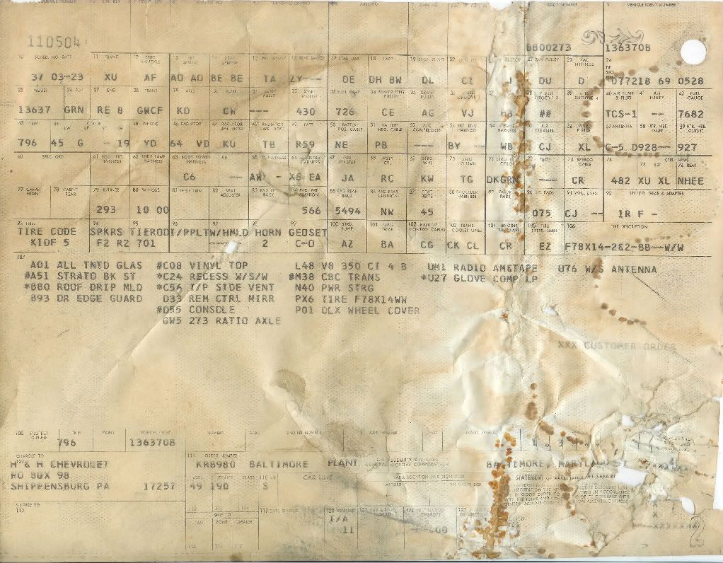

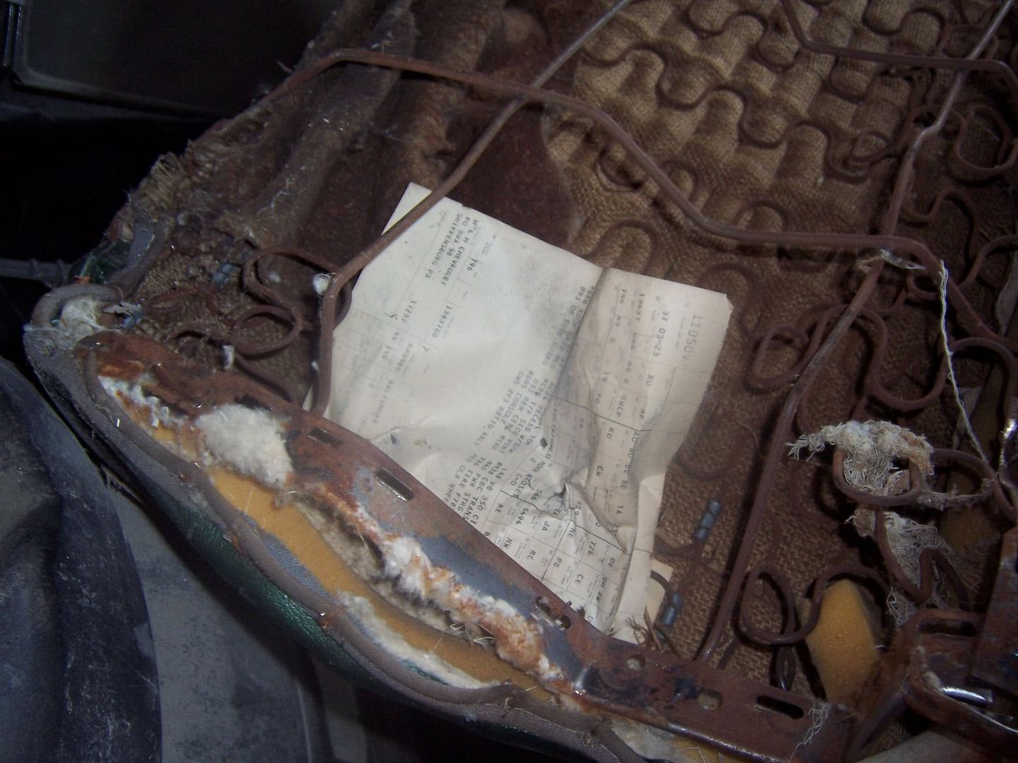

Some more great news! I don't know how I missed it, but today I was poking around in the pile of parts under the barn when a piece of paper caught my eye. I found the build sheet for the car!! It was in the bottom seat cushion actually crimped into the springs on what is the driver side of the lower cushion!! I couldn't believe I had over looked it when I took the car apart initially.
Here are some pictures.
I'm scanning in the build sheet right now and will update the post with that picture. I need to figure out what everything means now!!
*EDIT* - Here's the build sheet:
*caution - large image*

The patch areas on the doors looks like hard places, ( corner and 3 angles) looks like its going to be a tough work. What do you thing about that? are you gonna cut that part from a donor car or produce a patch part? If you gonna produce a patch part how you gonna do that? The reason for asking is I want to learn if there is a practical way to do that.
Im really looking for to see some progress.
Old Jul 7, 2008 | 08:19 AM
  #89
Posts: 41,333
Default RE: So It Starts! - 1970 Chevelle Resto
More good news! I just emailed H&H Chevrolet, the dealership who sold my Chevelle! They are still in business. Now lets hope they have good records and have some stuff they could send me regarding my car!!
About the doors, no, I will not be patching these areas with donor pieces as these areas are VERY common for rot. I have broken the surfaces down to mild contours that I will hand form and weld individually. With both doors, I had to remove the lower support that ties the lower hinge into the rest of the door frame to get at the back side of the rusted areas as well as repair rust in the supports themselves. These pieces will be sand blasted by the end of the week (hopefully).
Once I have the frames complete, I am planning on having them galvanized to protect everything. I'll then install the new skins and
