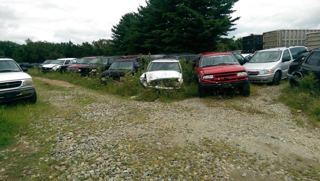

A beautiful day in the salvage yard!
And the $50 score!

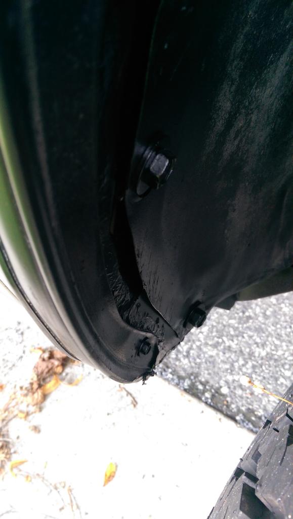

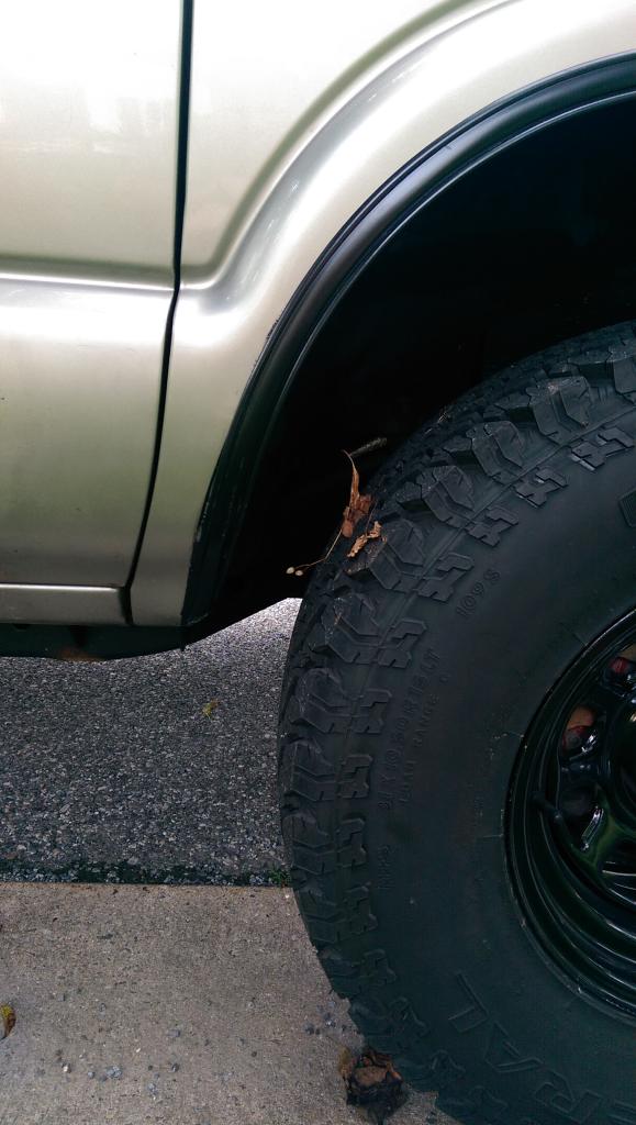

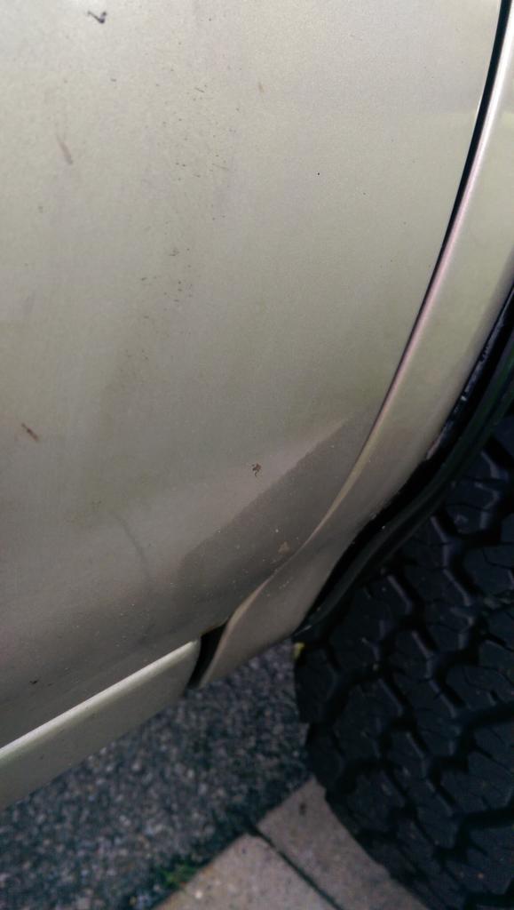

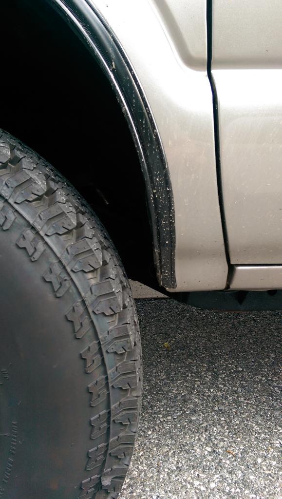

Big fun after the salvage yard. Fender trimming.
I loosely followed Skidz guide. I had already done some hack work under there so I had lost some of the needed metal. A patch piece was made from some old sheet I had laying about the garage. I also stitch welded the fenders back together rather than pop riveting. Still have to work on the fender trim fit. With the new shape of the arch the trim sits out a little. Some relief cuts on the inner trim lip should allow me to pull it in enough to attach with some 3M VHB tape.
Drivers side not trimmed:
Passenger side trimmed:
Attached Thumbnails Stepson Build-imag0190.jpg   Stepson Build-imag0189.jpg   Stepson Build-imag0192.jpg   Stepson Build-imag0193.jpg
