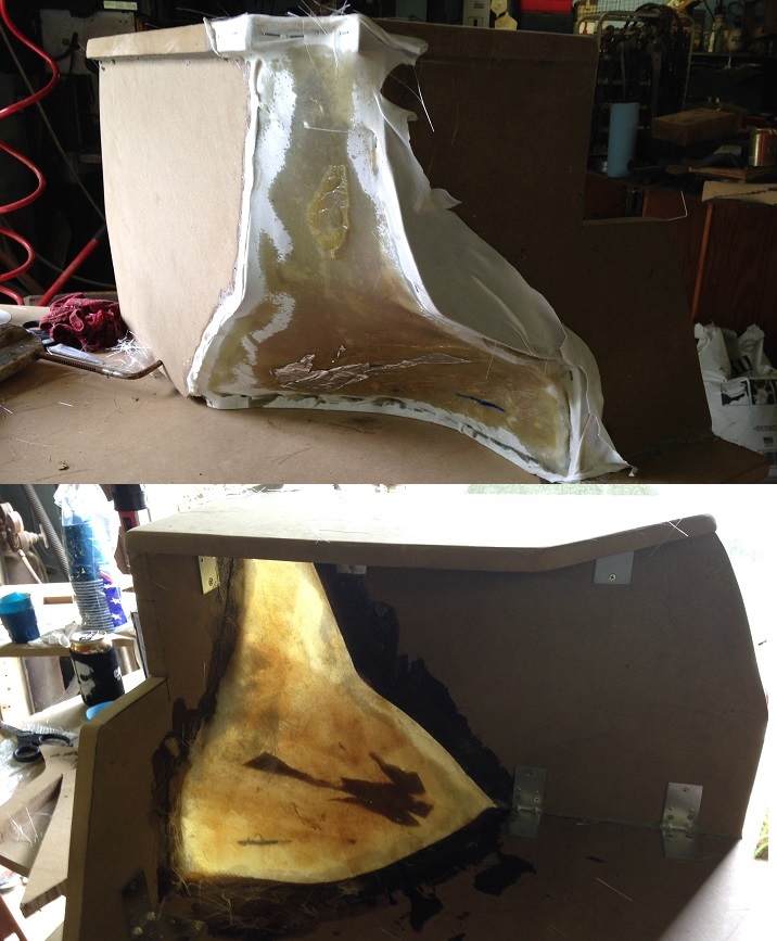

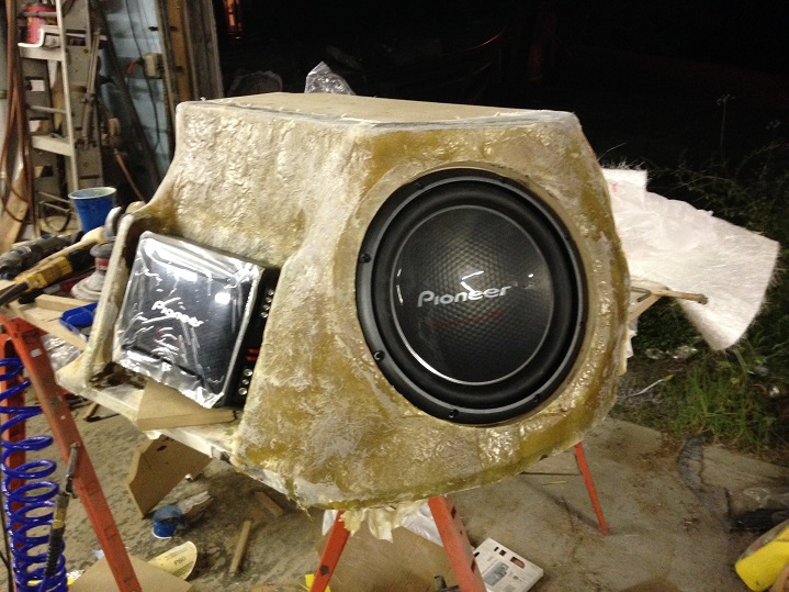

This was the first time I've ever attempted this and it had been about 10 years since I had worked with fiberglass.
That's it for now.

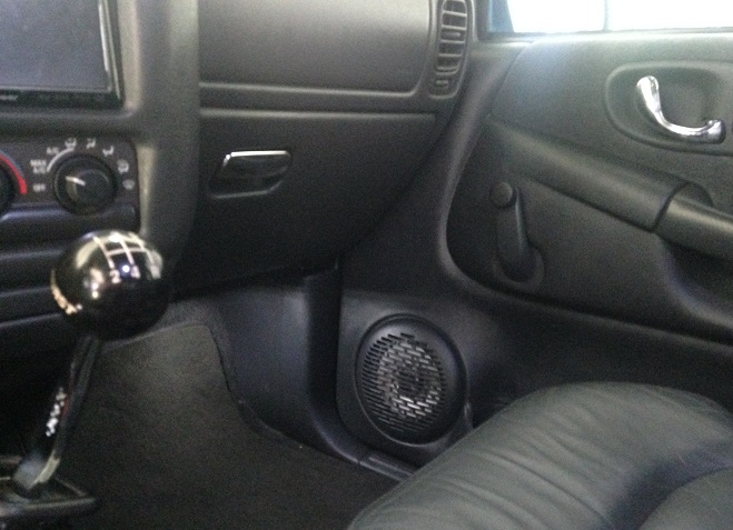

Holt **** where did the time go? Well lemme throw out some updates...
Carpet added

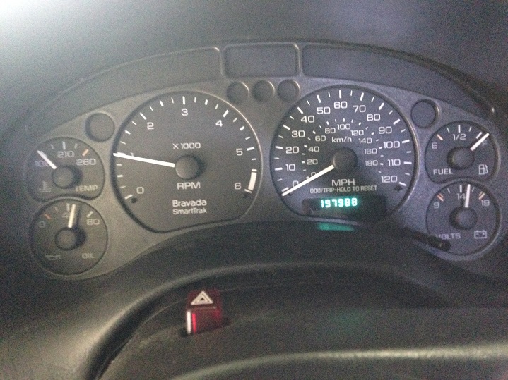

Bravada cluster with the Alero needles
Not many of these flying around anymore

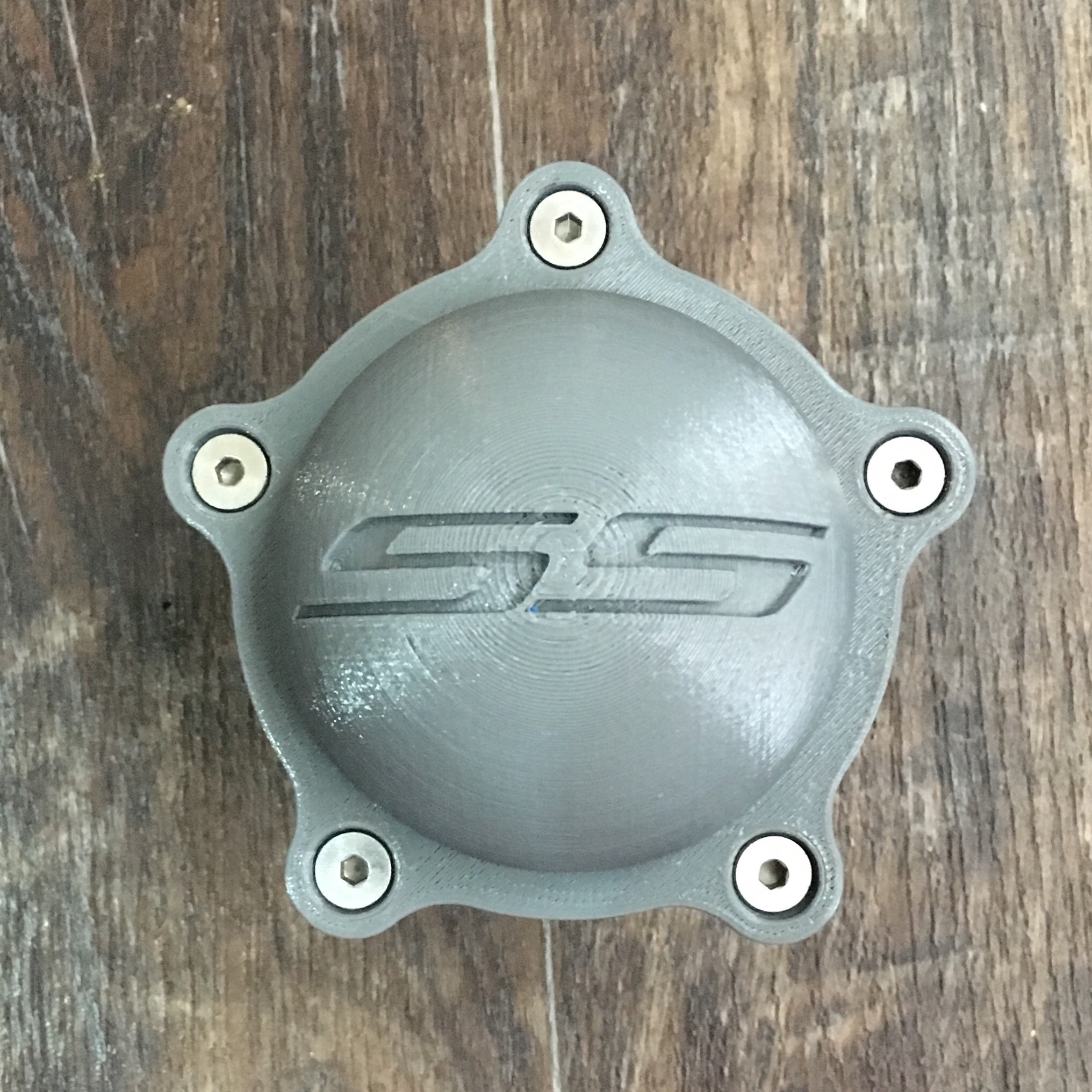

I'm no longer running the Coys anymore because their wheels are pieces of **** and I'll never buy anything from that company again. But I did make these center caps on my 3d printer.

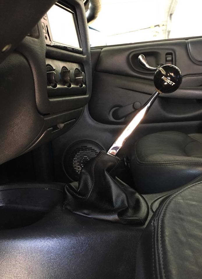

I also printed off a bezel that snaps into my center console to allow for a leather boot.

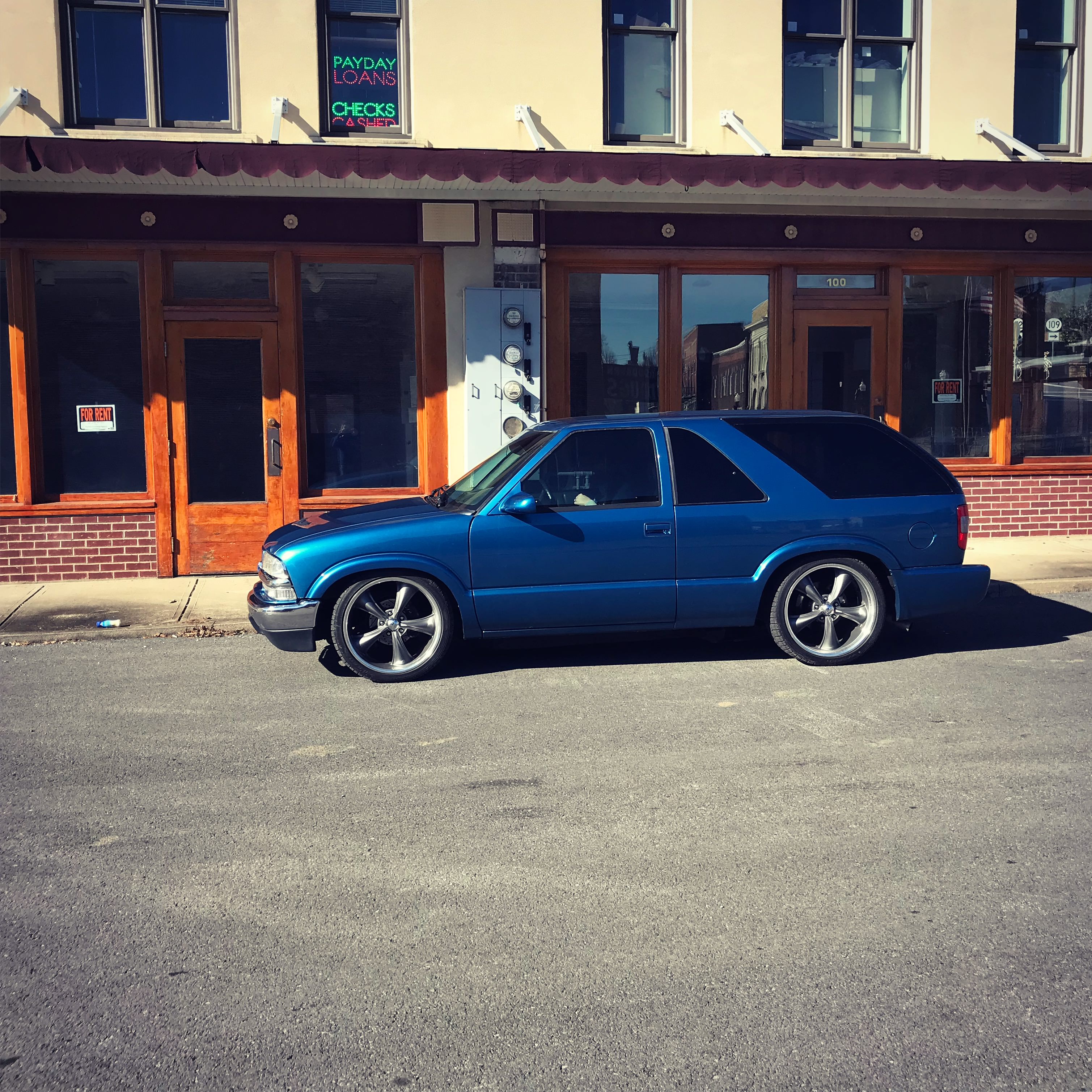

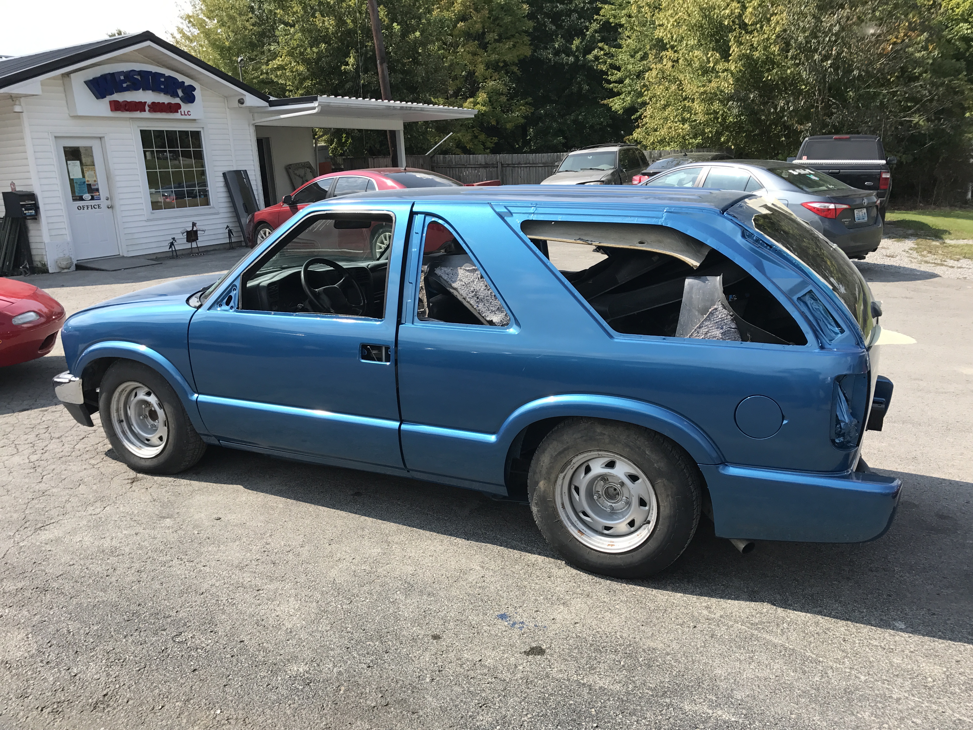

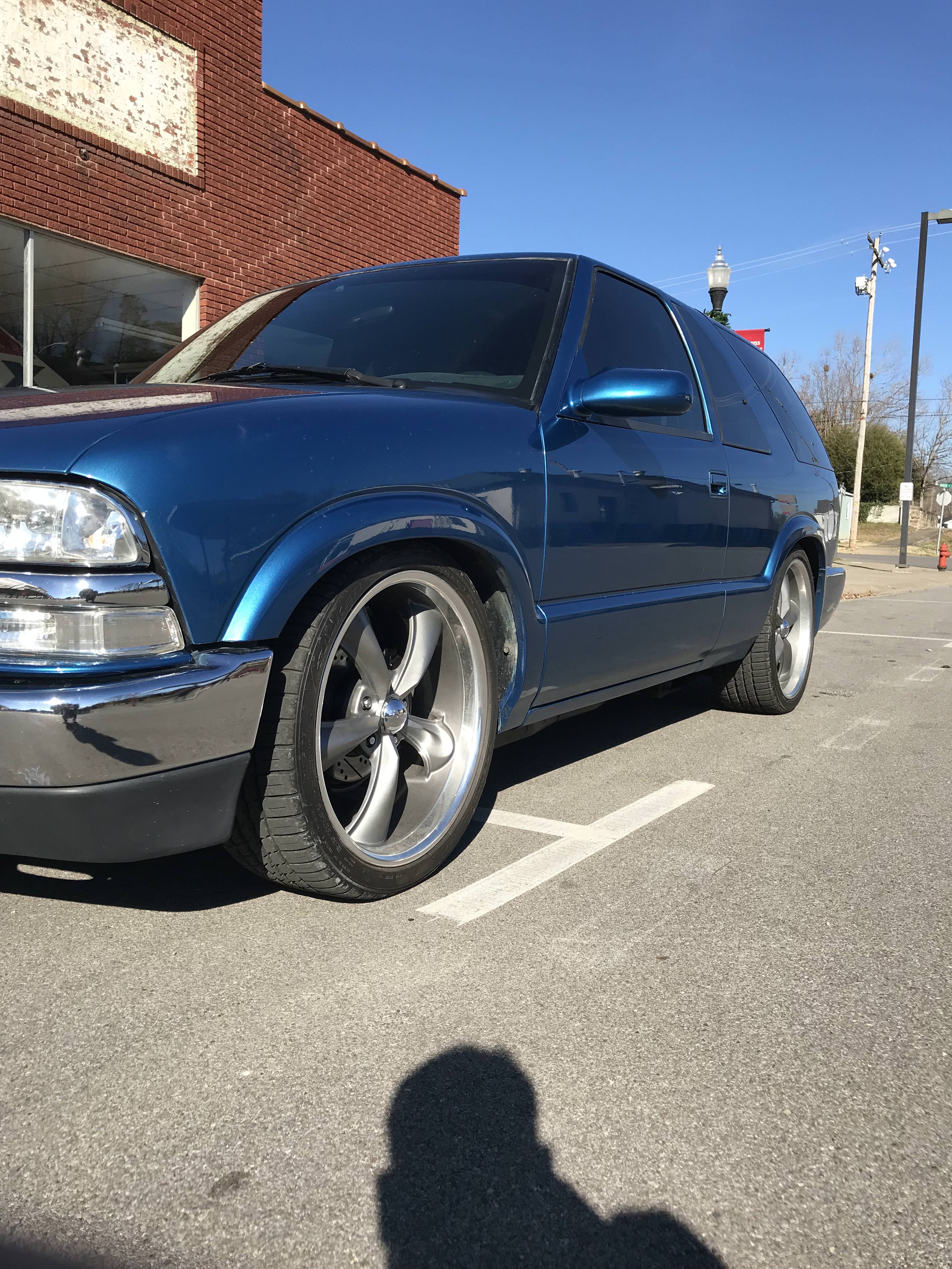

Finally last year it went to the body shop for a full respray.
Similar to the C-5's, but with a polished lip instead of a machined cleared lip.
I had them shave the antenna, hood squirters, roof rack holes, 3rd brake light, tailgate keyhole, license plate light holes, and the spare tire hole. Then they painted the handles, added hood struts, and re sprayed everything. I'm very happy with how it turned out. For some reason I don't have pics of it, but I've also converted to factory power windows and locks including the power door panels as well as adding a new head unit.

-The 3D printed center caps and console bezel, fantastic job sir Did you used ABS for them? (I hope)
-That paint job looks AMAZING!
If you're ever in the market to sell this thing, seriously, send me a message, I may be willing to take the drive to Kentucky to take that beauty off your hands
Thanks! I forgot to mention that I had the shop smooth and paint the rear side glass rubber gloss black too. Shifter is just a Hurst shifter stick attached to a core shifters short throw, handles are from an Envoy, and the glove box handle was one that a member on s10forum was selling over 10 years ago. A guy I know bought a Blazer that had it on it and he doesn't like chrome so he sold it to me. I only print with PLA. ABS is stronger and can take higher temps, but is a lot more of a PITA to print with. I designed the caps on the thick side and had them on there for around 2-3 years in temps over 100 degrees in direct sunlight. When I sold the wheels the caps looked the same as they did when I first made them.
