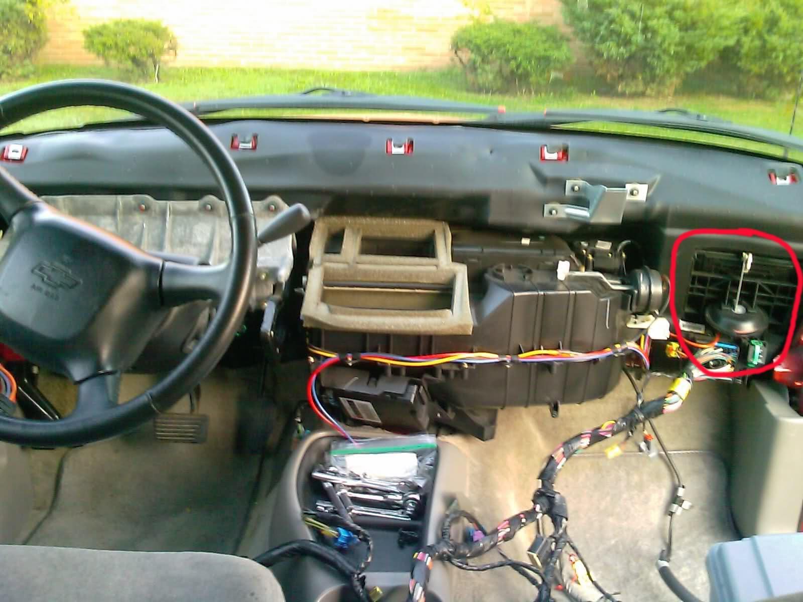

What I would try is spraying Febreeze into the interior air supply inlet while the fan is going. If you have manual control over the the source of air, from outside or inside, then it is pretty easy. If you don't have those controls I'm pretty sure you'll have to put the system into Max AC mode to get it to open. You'l want to cycle all of the air-delivery controls to get the Febreeze through the whole system.
You can get at the air inlet opening which is located behind the glove compartment on the right by releasing the catch the prevents the glove compartment from opening too far which will then allow it to swing down out of the way.
The inside air inlet door is circled in red. Picture found at S10Forum, http://i40.tinypic.com/2m5knro.jpg
