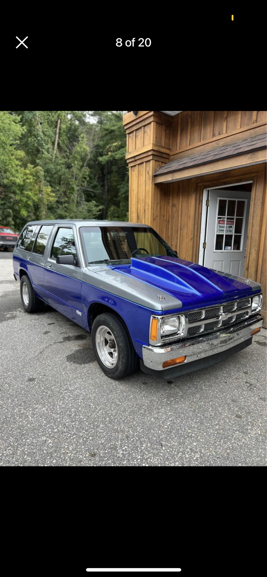

Hello, I just bought a 1994 s-10 blazer roller. The guy I bought it from had it set up for a SBC 350 and a 700r4 trans. I’m planning on putting that same setup back in it, but I’m unsure of what driveshaft to buy. Can I buy a stock drive shaft? If you have any information and/or tips for the build let me know!
thanks.

If the trans is in the factory location a stock driveline should work

You might want to check the modifications section of this forum. Someone could probably tell you if the transmission will be set back or not. Might depend on if an aftermarket V8 swap kit was used or not.
