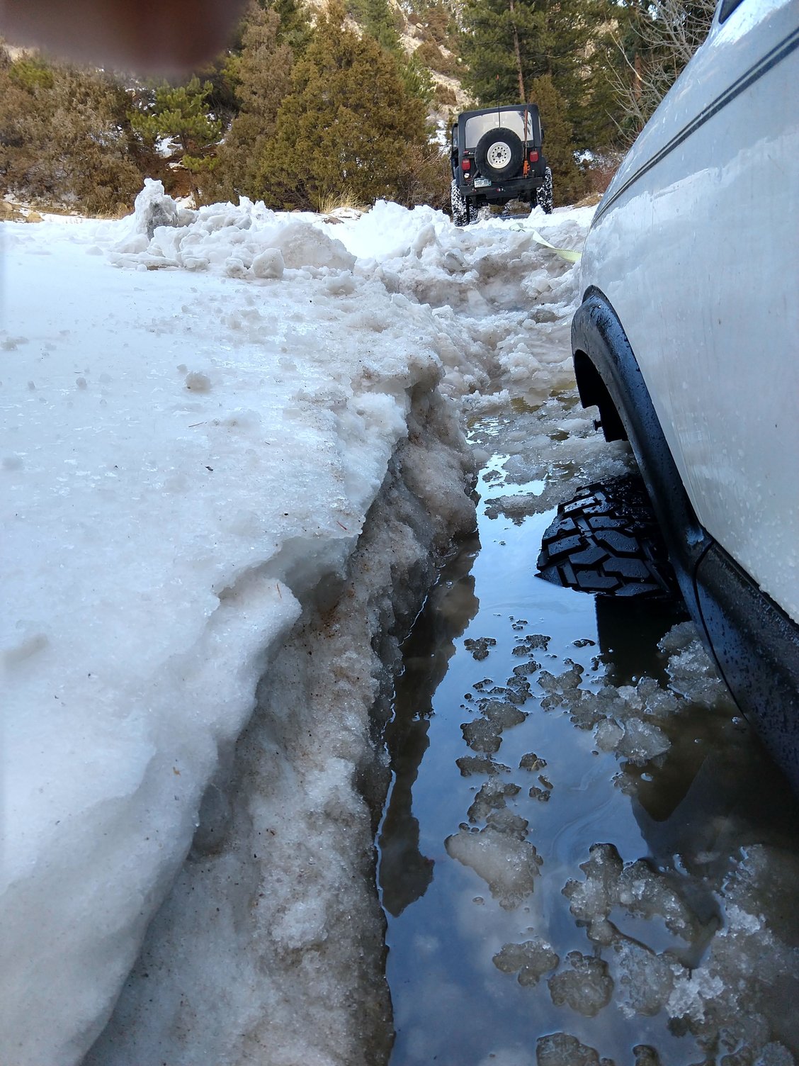

End of winter run earlier this year

Same water crossing from previous pic but headed off trail. A good 2.5' of water. Look for the strap lost my front drive shaft because the slip yoke kept coming off on this run.
