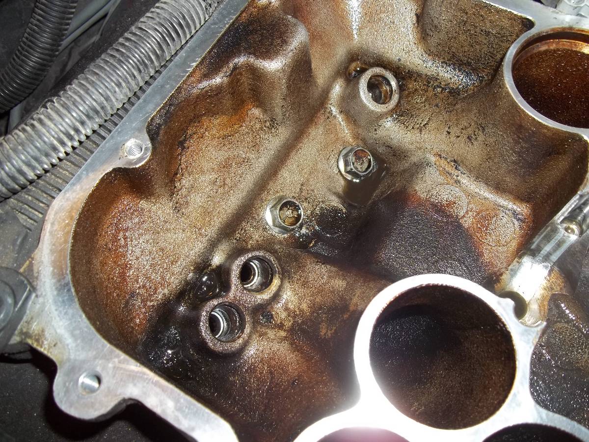

Okay, so I pulled it all apart and there is a slight difference in the passenger side from the driver side. There was also some pooling of what seemed to be oil! The wiring for the injector is starting to fall apart, and some of the poppet clips are cracking, so I will be replacing that stuff.

Avoid airtex like the plague! It will fail on you again probably within a month. Stick with delphi, it costs more but at least you know when you finish the job you won't have to do it again. There should be a discount code floatin around somewhere to. The "oil" was more likely gas that has been turned black from the carbon on the intake.

DO NOT order that part! You cannot convert the older CPI system over to the newer setup. The MFI upgrade only applies to the 96 thru mid-02 SCFI trucks, not to the 95 and older CPI engines.

Thats what I was wondering. I have the generation 2, but I guess it still wouldnt work. So Just stick with a Delco with the poppets still?

Unfortunately, you only have the 2nd gen body. The engine is still the old CPI engine used in the later 1st gens. So yes, you have to stay with the older CPI spider.
When you are ordering parts, do not forget the 'nut kit' (internal lines). These are notorious for leaking after being disturbed. Another item worth replacing is the electrical connector to the cpi spider injector (also called the 'maxi-injector'). It's cheap enough and has caused a few members to pull their hair out and toss countless dollars into other parts after they were sure that the fuel system was good. The part number for the connector has been posted before and a search for "cpi+injector+connector+part+number" (without the quotes) should turn it up.
