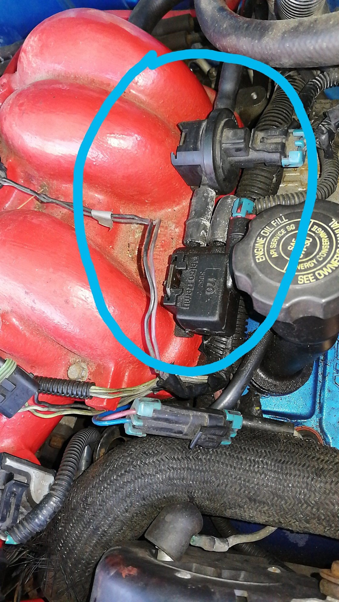

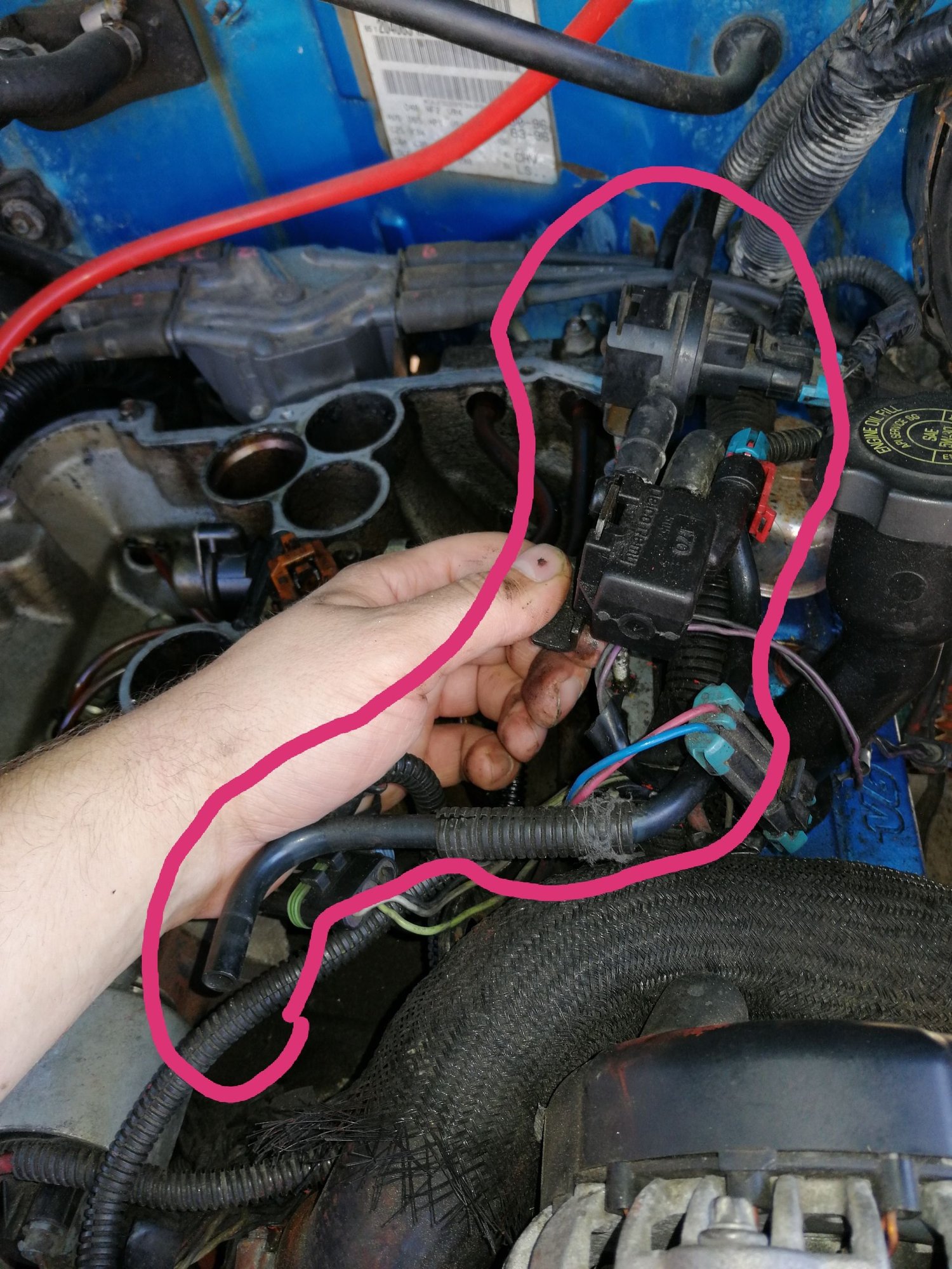

And the last thing is the question, what are these parts with the hose? They are mounted on the drivers side of the Intake Plenum.
