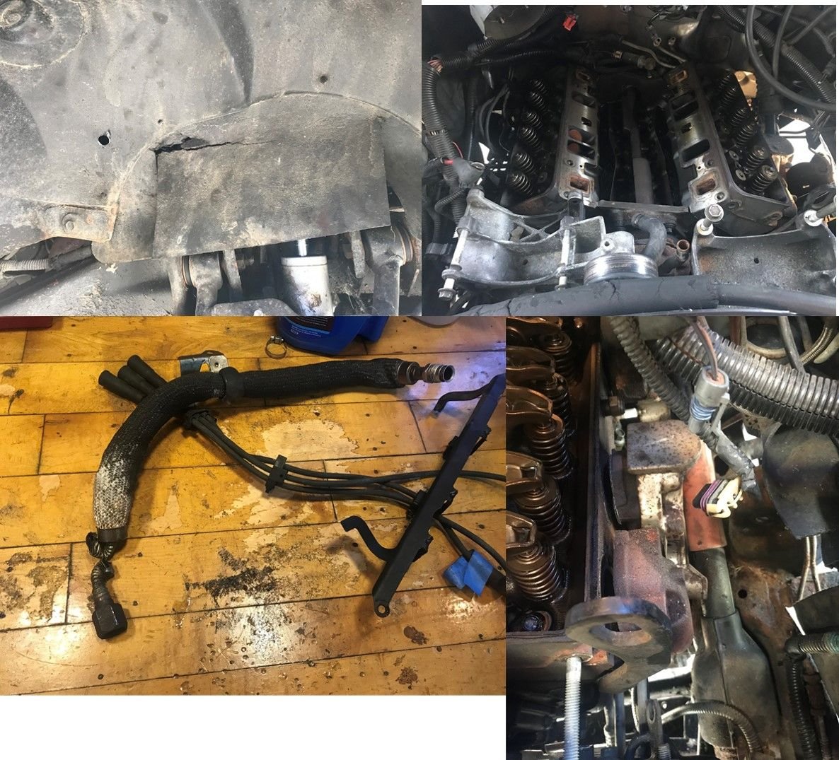

@LesMyer - Once again thanks for the advice.
We did dive in to the next phase. Lots of problem solving and head scratching. We got 90% of the way there. The biggest issue now is that there are 3 head bolts absolutely buried directly under each of the 3 exhaust ports. We put in about 5 hours yesterday. This morning is to noodle hose to get clearance on the drivers side - On the pax side there is enough room to move the exhaust manifold outboard and get to the head bolts. On the drivers side the manifold hits the steering shaft.
All in all pulling the engine would probably have been the right call "prior" to pulling the intake manifold. Now (time-wise) it's a toss up. A couple of problems we solved. For the very rear exhaust manifold bolt on each side we drilled an access hole in the fender well to get a straight shot. You don't need to drill it "socket" sized, just big enough to pass the extension through. On the driver's side, try as we might we could not maneuver around the EGR pipe so that had to come off. Unfortunately it was so corroded that we ended up killing it to remove it. The flare nut would not rotate on the pipe. The good news is that Rock Auto has them for only $37. The rest of the exhaust manifold bolts came loose working through the wheel wells.
Other tips I have read include pulling the P/S pump pulley off in order to get the A/C bracket removed from the long stud in the front of the head. Not necessary. The stud has a female star head on it and I just pulled the stud.
Just gotta solve the 3 remaining head bolts issue today - two top theories are remove the exhaust system or remove the steering shaft - both appear to be a royal PITA.

Sadly my son and I have reached a come to Jesus moment and have decided to sell the Blazer as a "mechanics special" project. He's got about $1200 invested in a RC 3 inch lift and 4 new Milestar MT tires + the base investment of $1800 for the original purchase.
I did a bunch more research on getting the heads of and it is still technically doable in place - I watched a video of a guy who did it. But efficiency wise he pulled the inner fender wells and the exhaust system. The exhaust on my kids Blazer is truly frozen at the manifold. This runs the risk of breaking studs or maybe needing to cut the exhaust. We also discovered that the timing chain cover has like an 8 inch open crack - don't know when that would have happened.
The other issue is that my kid and I have different schedules - he works weekends and it would basically be up to me to do the whole job. My hobby vehicles are my Bike, my classic British MGs and my 32 foot RV so I would rather not be in the Blazer business.
So that's where we are at. Anyone have an idea what I should ask for the project, considering all the parts are already purchased for the head gaskets and intake manifolds, including all new studs and a tune up kit (plugs, rotor, dizzy cap)?
