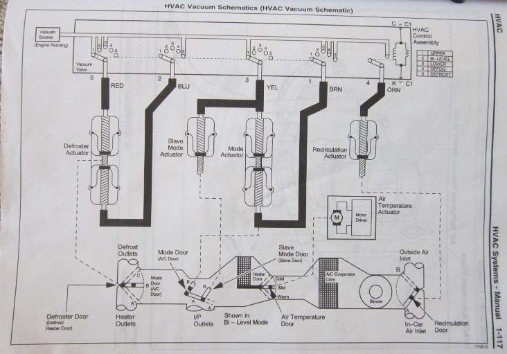

Originally Posted by mrspeedy69
Do you know if it is actually switching the actuator door between hot and cold? If not does your 4x4 work? I say this because if it doesn't work you might have a vacuum issue.
That door is operated by an electric motor. But regardless, it's a good thing to check out.

Originally Posted by 05BlackJimmy
The door that changes between cold and hot is actually vacuum operated....
See "Air Temperature Door":
Attached Thumbnails 2004 Chevy Blazer Not blowing Hot air.-hvacscematic-732x511.jpg
