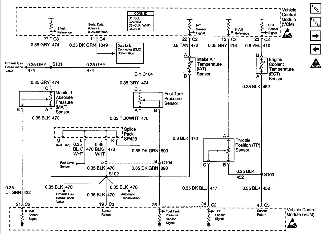

i am still wondering if there is a common grey wire or does each sensor have a grey that runs to the pcm?
Old Feb 12, 2009 | 07:35 PM
Posts: 41,336
Default RE: 4.3 worked great for 15 minutes, low voltage?
Not a common wire, but a common +5V bus in the PCM. Here is the schematic:

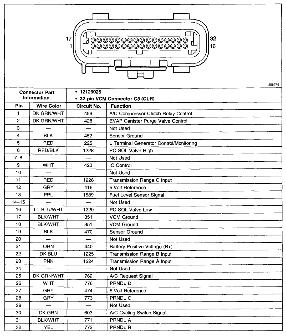

And here is the connector layout which has the two +5V reference terminals:
THanks for the diagrams, they helped a lot!
I just checked (with an ohm meter) the wires coming from the TPS and MAP and they all are ok.
Could it be the VCM? how is that tested?
Can i test the MAP sensor?
do you think you could post the 3 other connectors to the vcm? thank you

I would start by disconnecting both the MAP and the TPS sensors and then testing the 5V reference. If it is still low, then it is likely that it is a PCM problem, but before jumping all the way to that conclusion, I would disconnect C3 and test continuity from the appropriate pins to the connector on at each sensor. Also check for continuity to ground. If there is continuity to ground, then there is a short inside the wiring harness somewhere. If not, then the problem likely is in the PCM.
