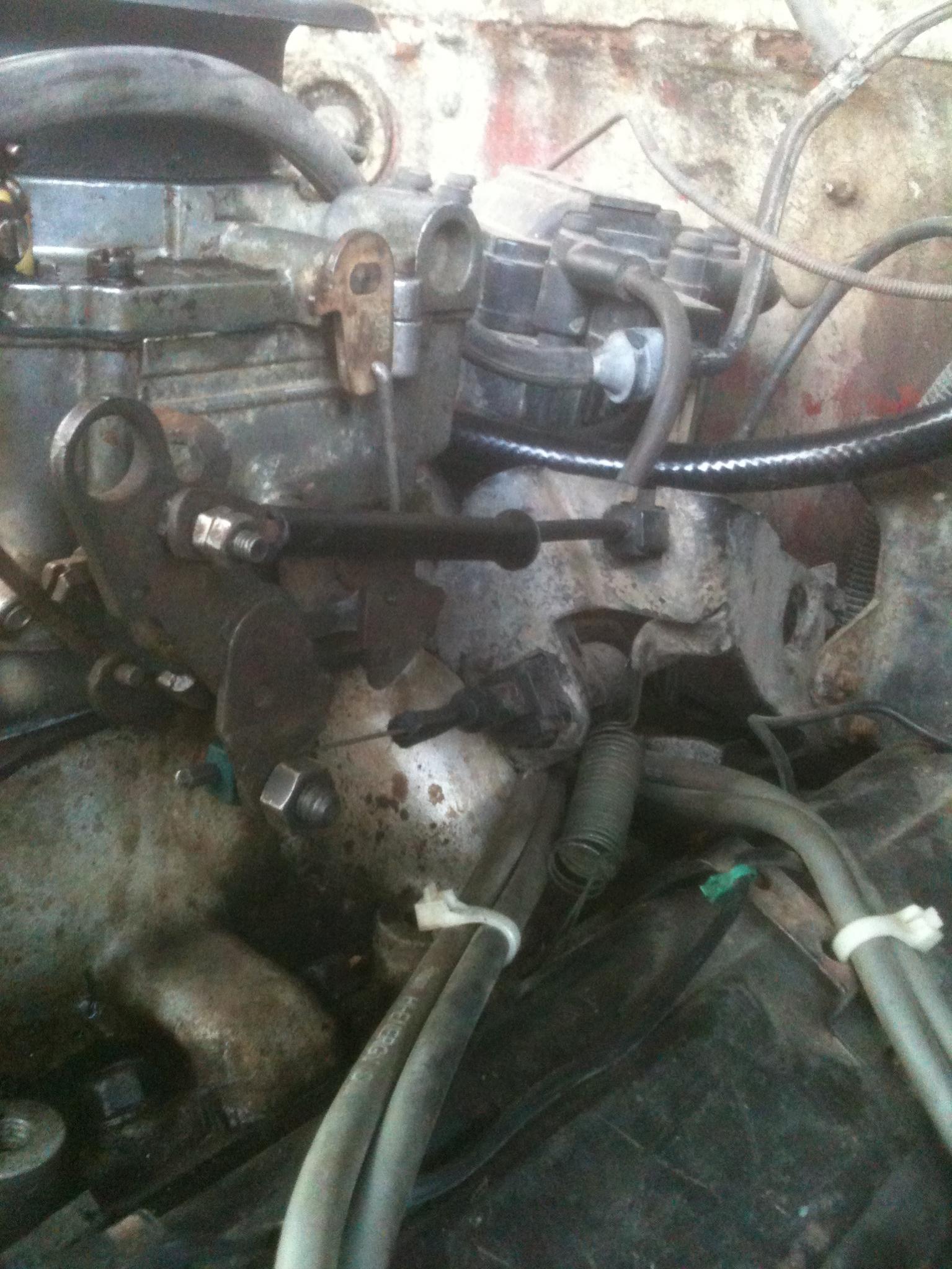

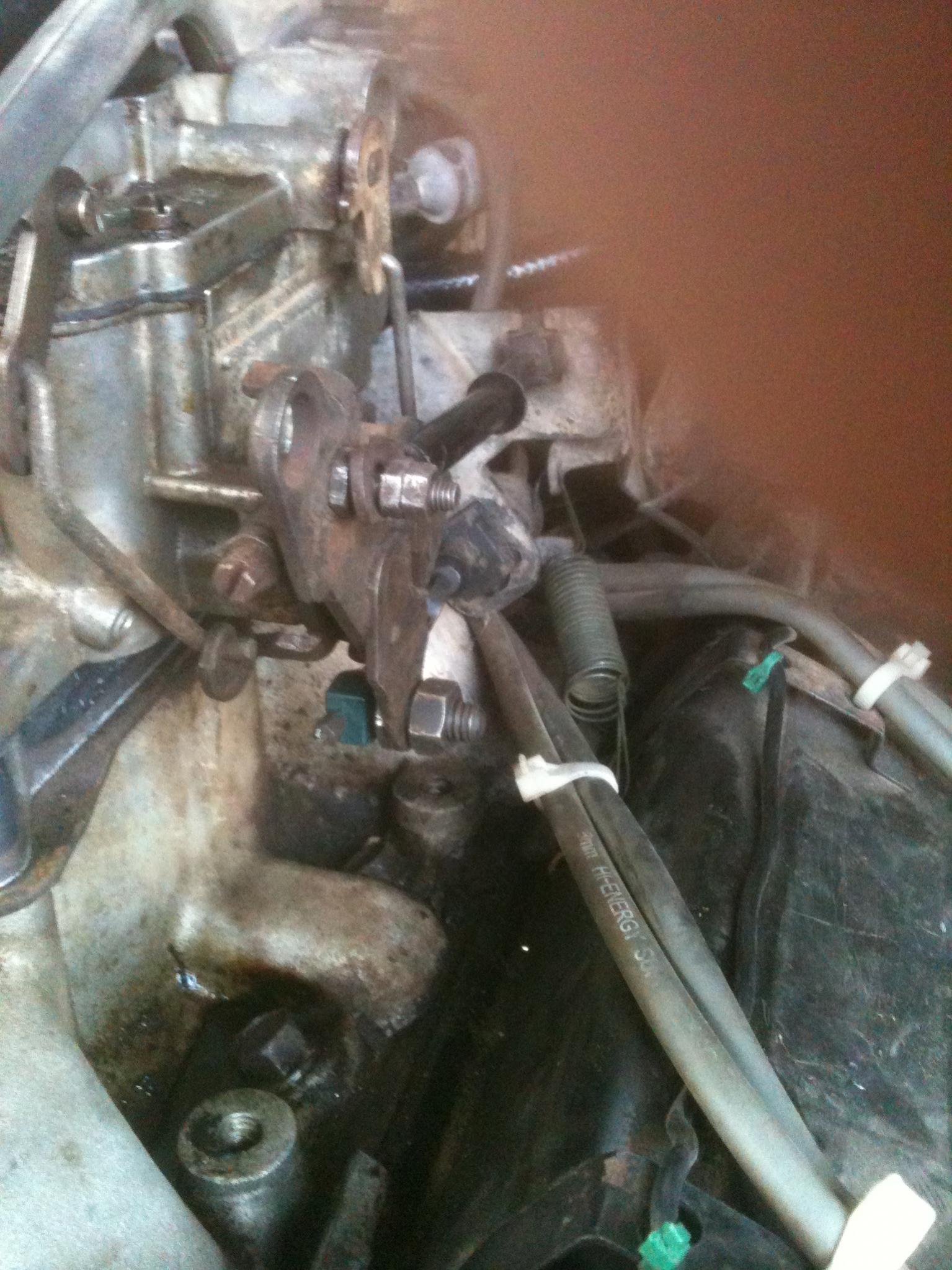

I got a correction kit but it will not work. It puts the cable out to the drivers side and that is too much of an angle.700r4 shifting-picture-011.jpg700r4 shifting-picture-010.jpg
