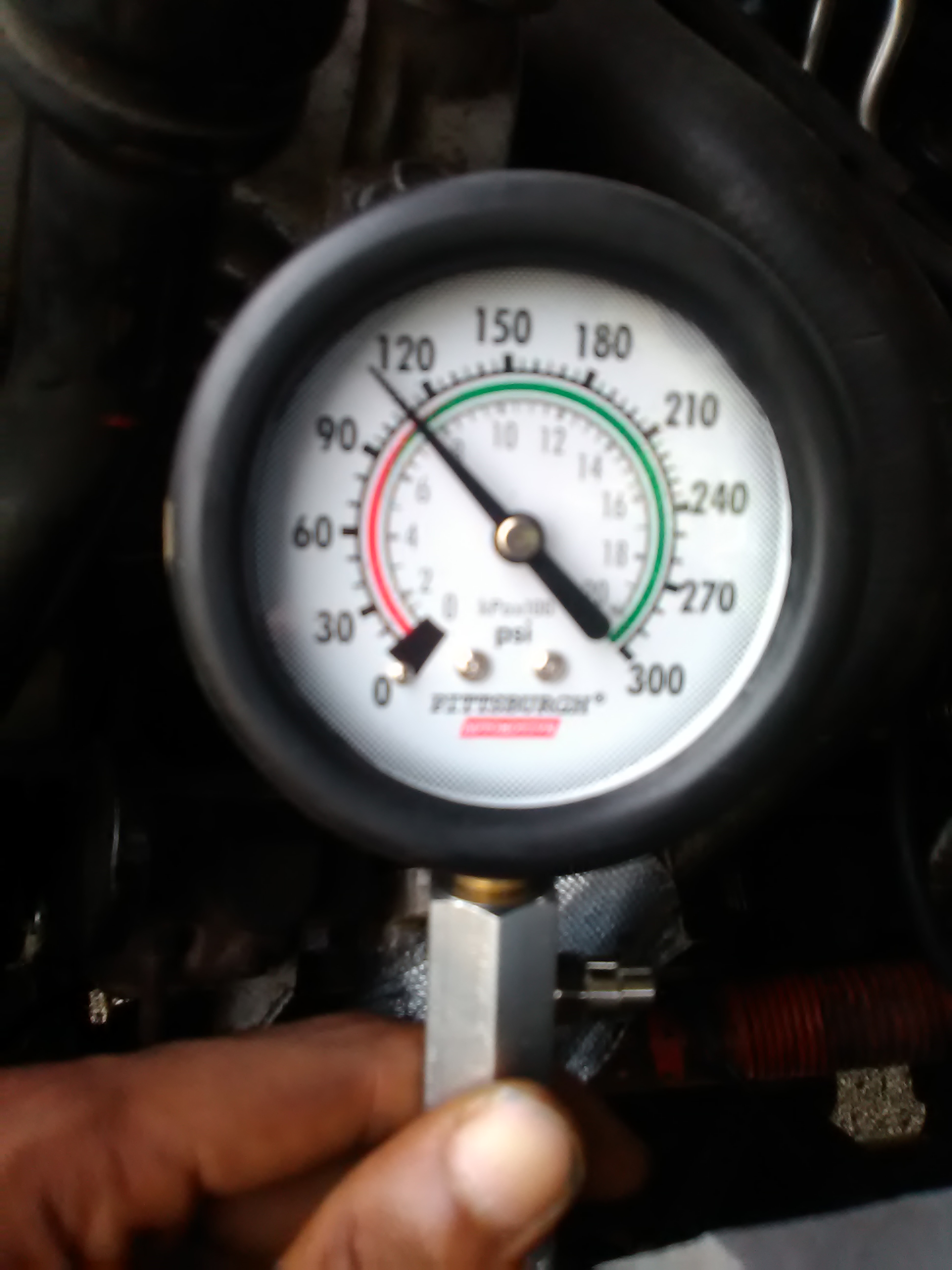

OK, I loosened the rocker nuts and did the compression test on those cylinders. Did it on cylinder # 2 and read 120 psi. Did the same on #5 and it read 115 psi. Went to torque them down, starting with #5, and tested five again, and it stayed at zero again. Pics are the readings...Also discovered my passenger side upper intake gasket is blown/broke, also in pic. Could that be a problem too ?

Originally Posted by Tynan Tha Real Dill
Yea I'm really anxious to drive it, its my first SUV. First day I bought it (March 6), it started up and I reversed it and pulled it up the tow truck, seller told me it was a blown head gasket and it was leaking coolant around the drivers side bottom intake and valve cover. They also said it ran fine then died all of a sudden. They never started it up again and sit for 2 weeks before I bought it. When I made it home, I drove it to my apartment checked the oil etc. Drove it outside the complex to do an oil change ( put 6 QTS of oil in �� ) along with Bars Leak Blown Head Gasket Fix to try to seal the head gasket...hasnt started since. Took it to a buddy's and pulled the intake. Found the valve cover gasket wasn't on right and the drivers side intake was really loose ( I twisted the bolts loose with my fingers ), allowing coolant to leak and with the gap between the valve cover and the head on drivers side, coolant was draining into the head, sealed it up, with new intake gaskets, and screwed my distributor up by not aligning the shaft with the oil pump shaft and I started it up. It had a really loud bang when it ran this time. So I shut it off, went to set TDC using a screwdriver in plug hole and pinched the screwdriver tip and broke it in the head, seizing my motor. Took to grandpas to pull head to get the screwdriver tip, then decided to change that gasket while I had the head off. Put it all back together, tightened the valves to 40 lbs, and hasnt started since...and this where i started posting for help. But Im going to try to do whatever I can to get it running before I quit on it !
P.s. I didnt mean to post a new thread, I thought I was replying lol
Now we are getting somewhere!!! I would source 4 rocker studs and stop nuts for those on cylinders #2 and #5 (these are quite specific for vin W 4.3 engines in late 1990's /early 2000's - so don't try to substitute anything generic), install them, torque them, and recheck compression to make sure you still have it. You may later want to replace all 16, but I think right now we just want to get it running for minimal cost. The orange gasket is damaged from installing the plastic part of the intake. You will definitely need a new gasket, so might as well buy the upper intake set. Coat with Vaseline and take care when installing the plastic past of the intake. There may be other things to fix before it runs, but that is all for now. Install and report. Any questions about installation please ask.

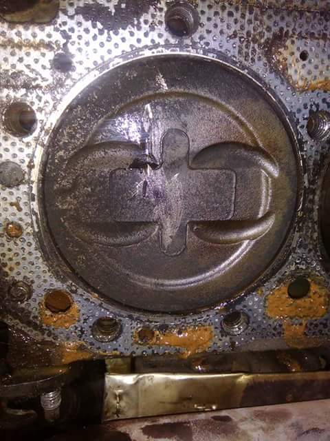

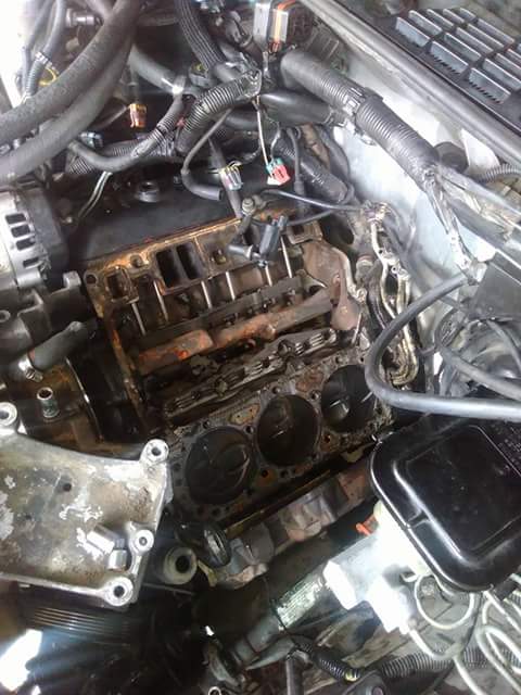

"Was there any observable marks in the piston from the screwdriver tip? If so please describe.
You had mentioned a new distributor at one time - did you get oil pressure after install, or hasn't it run since install?"
Oil sensor broke, replaced it and has oil pressure now. The pic is cylinder #1 where the tip was jammed. In the other pic, are #3 and #5 open or closed in the position there in ? And do I need to tighten the rocker nuts in open or closed position ?
Ouch, looks like the piston got pretty beat up with the screwdriver tip. Definitely not good, but shouldn't keep from starting. Guess it should be a try it and see if it lasts type thing. Maybe the piston gods will shine on you and you will get away with it!
Can't see any valve train for #3 or #5 in 2nd photo to say anything about. Only thing there would be the lifters and I can't see them.

Now after I did this, I have no compression in any cylinders, even with the nuts backed off. Though, I think my compression gauge isn't working, the pressure release button is stuck pushed in. So I'm either going to unstick it or exchange it for another. On hold until then, but I'll remove/replace those 4 studs until then.

[QUOTE=Lesmyer;677136]So please do the tests I described in post #17 (backing off the rocker nuts a couple of turns on those two cylinders) and report./QUOTE]
Ok I fixed my compression gauge, the air release button was stuck. Backed off the nuts on them and ran another compression test. Had compression 120+ in all but 1 cylinder, it had 60 psi. But my battery was dying by the time I was getting to that cylinder. So I'm charging my battery and jump starter tonight to insure it doesn't die during testing in the morning. Due to those cylinders not getting compression while torqued down, I still need to replace the studs, correct ?
PS ... As long as I have at least 100+ PSI in every cylinder and there is none less than 75% of the highest cylinder, she should fire up and run, right ?
If you have no compression on #2 and #5 with rockers torqued to 20 psi, but compression returns when you loosen the rocker nuts - then the stop surface on the studs and nuts are damaged and they need replaced. The nuts are turning down past where they should stop when torqueing and this is holding a valve open. Make sure you replace the rocker nuts too
