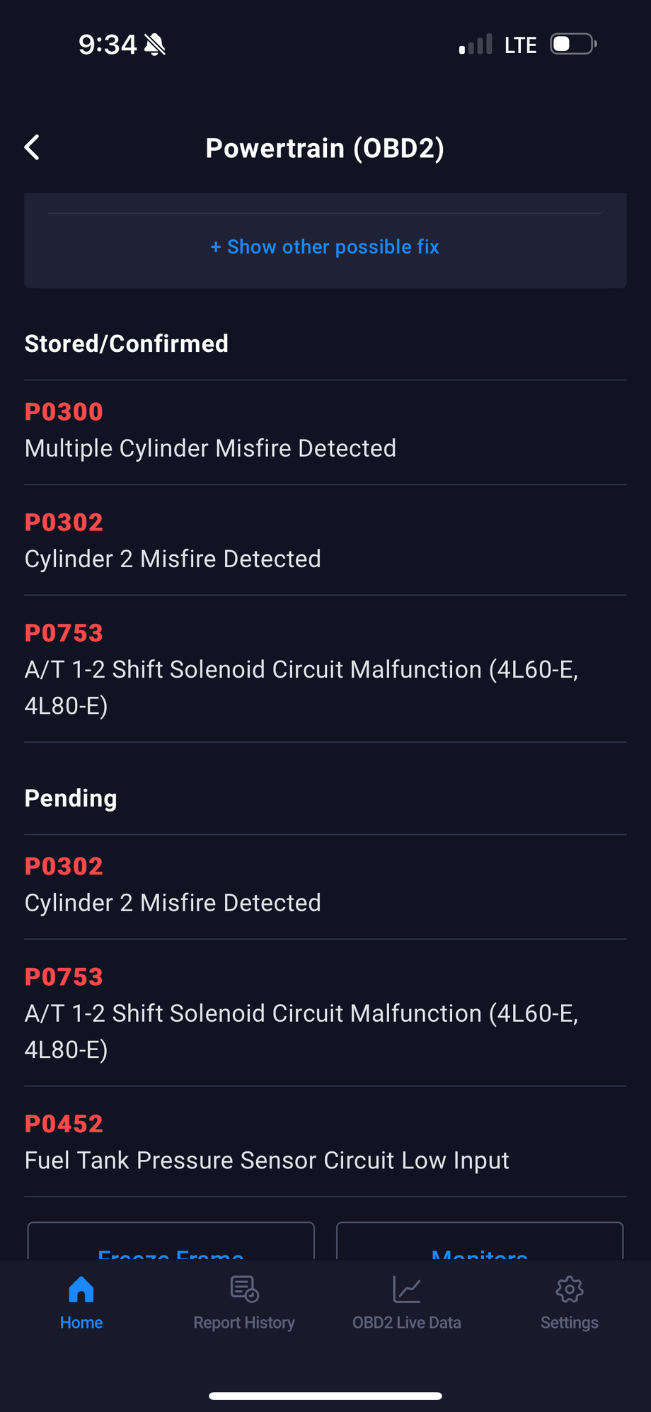

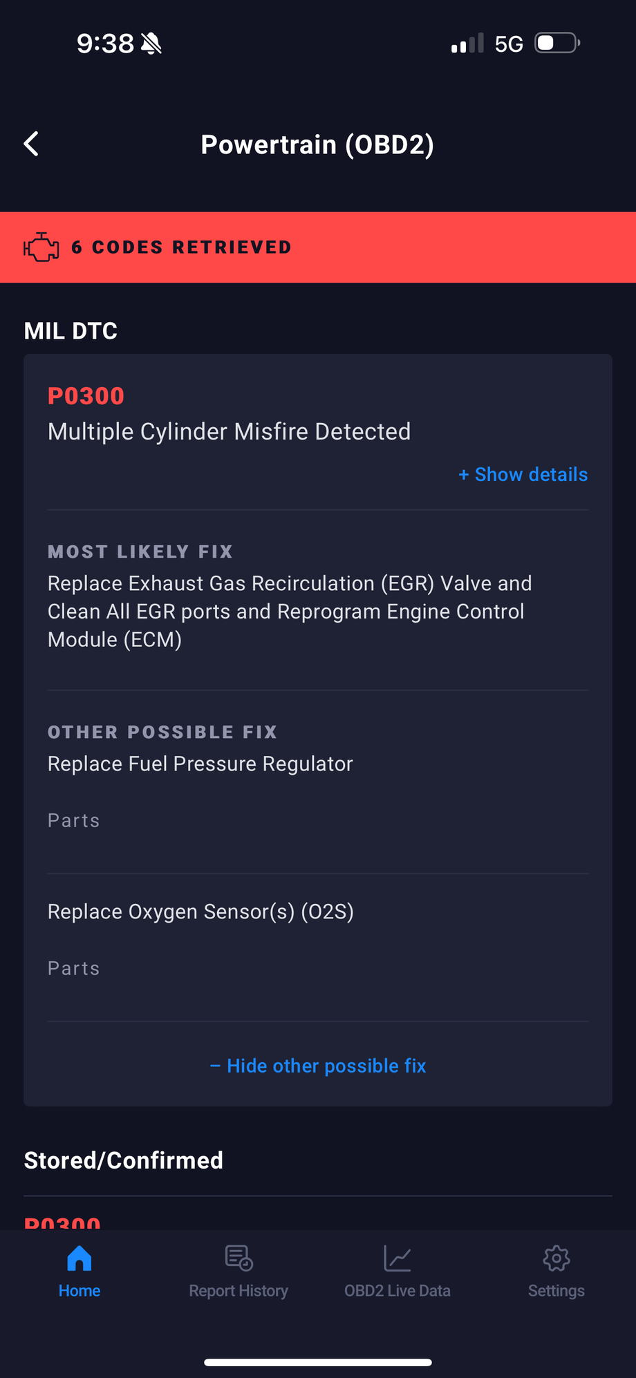

Codes thrown with maf plugged in

the P0300 and P0302 codes are misfire codes. Run compression check and look at spark plugs (carboned up, not carboned up, etc) before proceeding with anything. Report please. Also be aware that a P0300 or P0302 misfire code present can prevent PCM from getting to a mode where other codes may or may not show up. When diagnosing you ALWAYS start with the lowest numbered code.
Unplugging MAF sensor prevents PCM from operating normally. Doesn't mean that P0300 or P0302 or any other code that goes away when MAF is unplugged is fixed - they are just ignored.

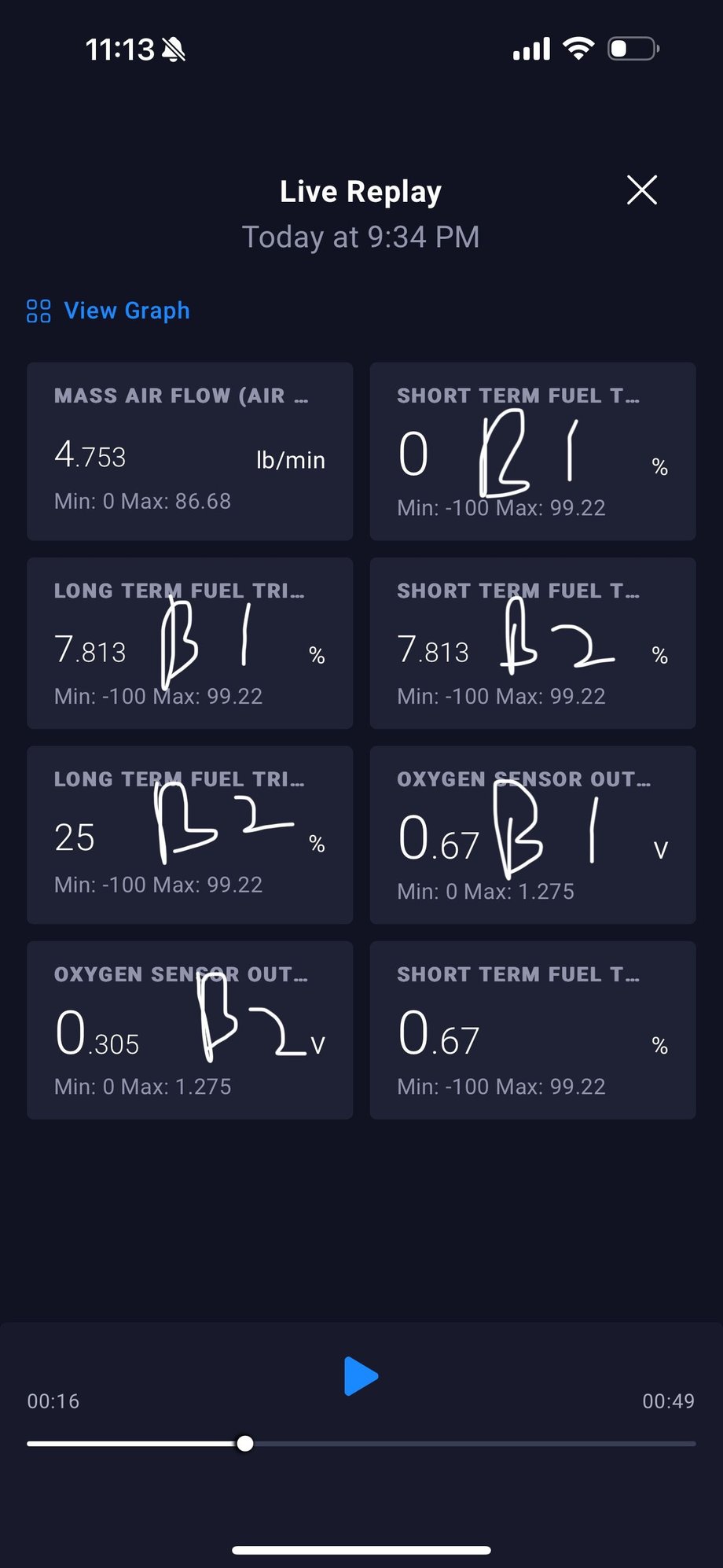

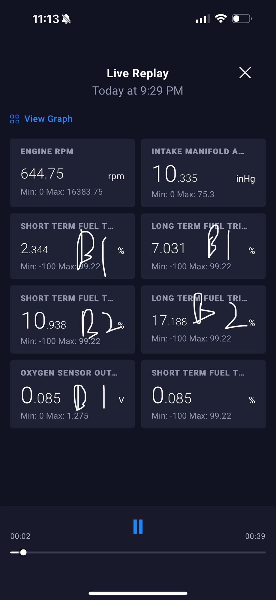

Here is why static one-time O2 sensor and fuel trim readings are worthless in my opinion. This is normal operation with fuel mix being controlled at optimum. Cycles back and forth across 0.41V. This also causes fuel trims to cycle. What good is knowing the voltage at one point in time.
The air system does appear to be the lines that are unhooked on the exhaust system. The mechanic or whoever put in weld over it after cutting it off after the check valve.
If I’m understanding correctly you’re saying the way I sent the live data is a hard way to judge. Which is understandable. Sorry I’m still fairly new at understanding the data myself I do have new to provide so we can see the fluctuations if that’s what you mean?

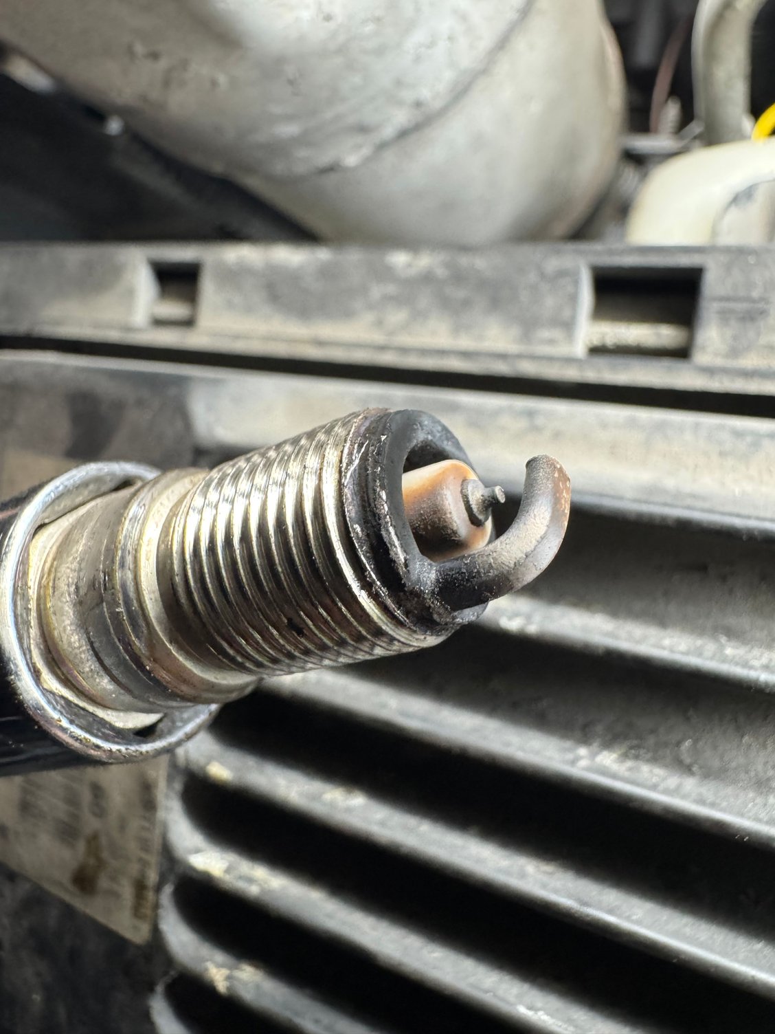

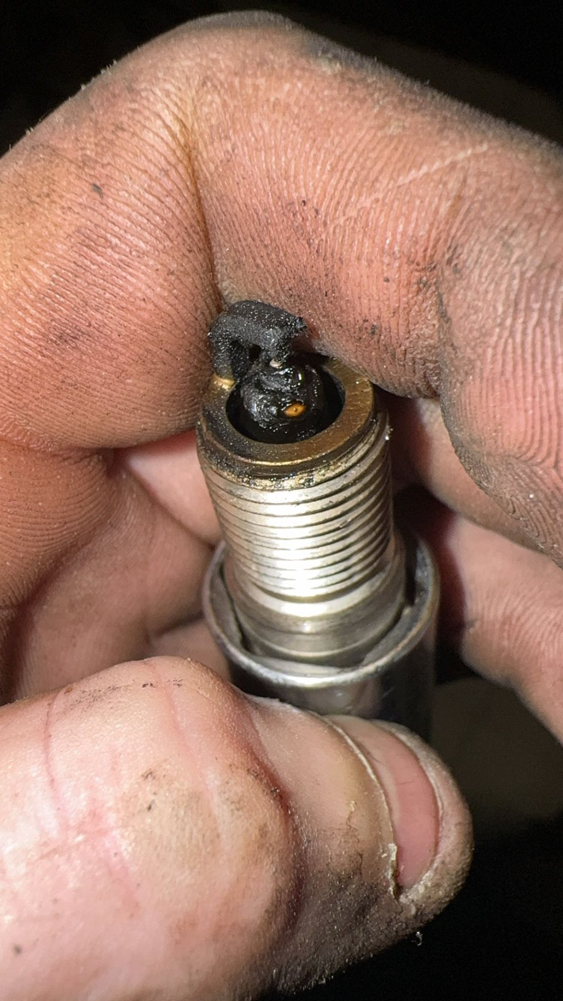

Spark plug for cylinder #2 had some signs of firing but probably not recently. It was covered in black I’m honestly not sure if it was carbon. Oil or fuel. Was slightly wet and I tried lighting it and it light after a second or 2 but only for a second. Wiped it off
other plugs looked normal other then some
otherwise it read like shown.

Spark plug 4.  Cylinder 6 was just slightly darker then this
Cylinder 2 spark plug

Sorry my mistake - oil fouled plug was #2 (not #4). Makes sense with the P0302 misfire.
