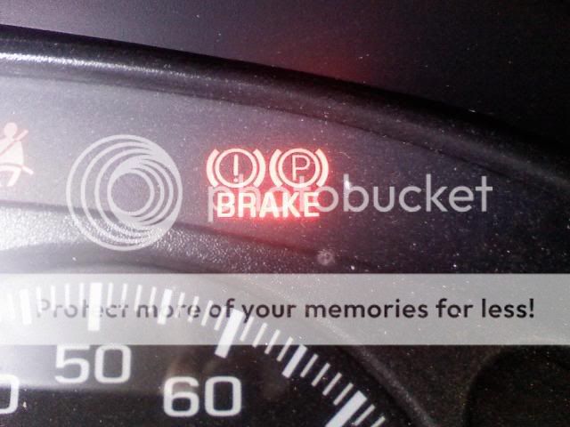

Here is a pic. I am sure you believe me I just want to be as clear as possible for everyone.

Originally Posted by willjones
Mine has ! and P in the same light.
Mine is the same way..it's the ! and P in the same red light. I assumed it was the parking brake light as looking at that diagram you posted I don't see any other brake related lights...Either way, it turned off when the ABS module was replaced, and came back on as soon as I pulled the fuse.
