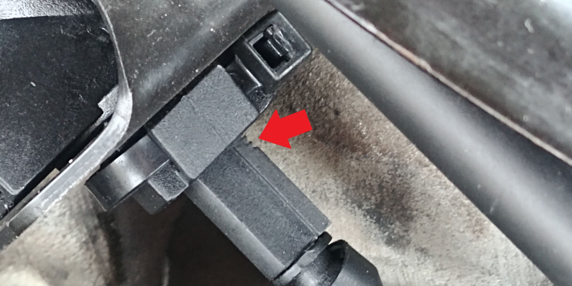

I took it back and they replaced the TV cable. Now at least the cable causes a change when I adjust it. Problem is, it only seems to have 2 modes. I have found a spot on the cable where if I adjust by 1 tooth, it will completely change the transmission's behavior. See the picture for what I mean by "teeth".
You can see there are 2 teeth visible. At this length, the trans will always 1-2 shift at 10mph, 2-3 shift at 20mph, then skip straight to OD at 35mph. The only time it won't shift like this is WOT. The engine will rev out to yellow line 1-2 but short shift at 3500rpm 2-3.
If I have the shift lever in D instead of OD, it will shift into 4th around 45mph and I can feel the truck lurching forward and back as if it wants to shift into OD but can't.
If I pull the cable out so there are 3 teeth visible, it will operate in this mode initially then go into hydraulic fail safe mode where 1-2 is at 20mph, 2-3 is at 35mph, then it stays in 3 until OD is reached at 60mph.
If I pull the cable out so there are 4 teeth visible, it will operate in hydraulic fail safe mode right from the start.
Any idea what's broken in this thing?
