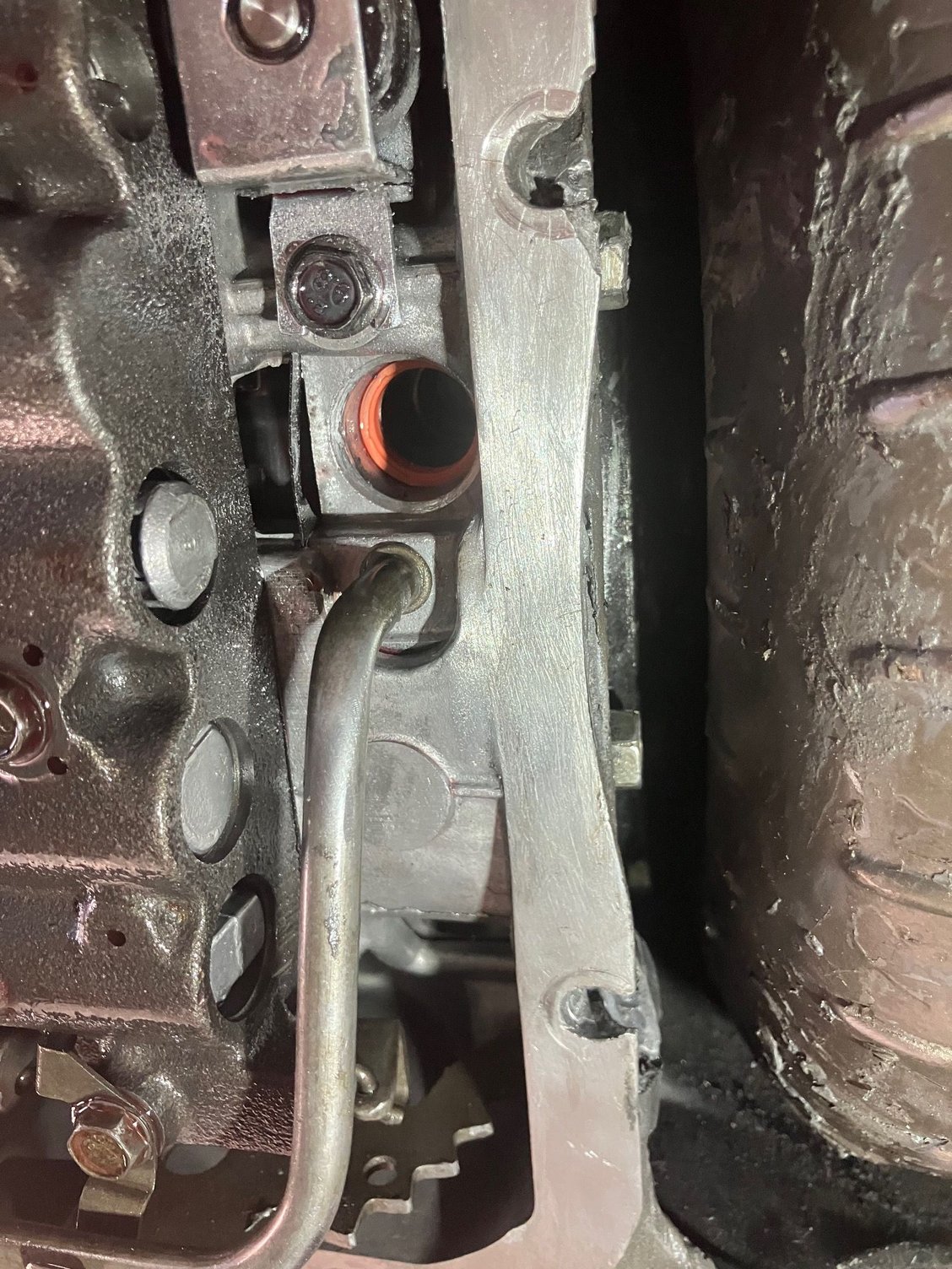

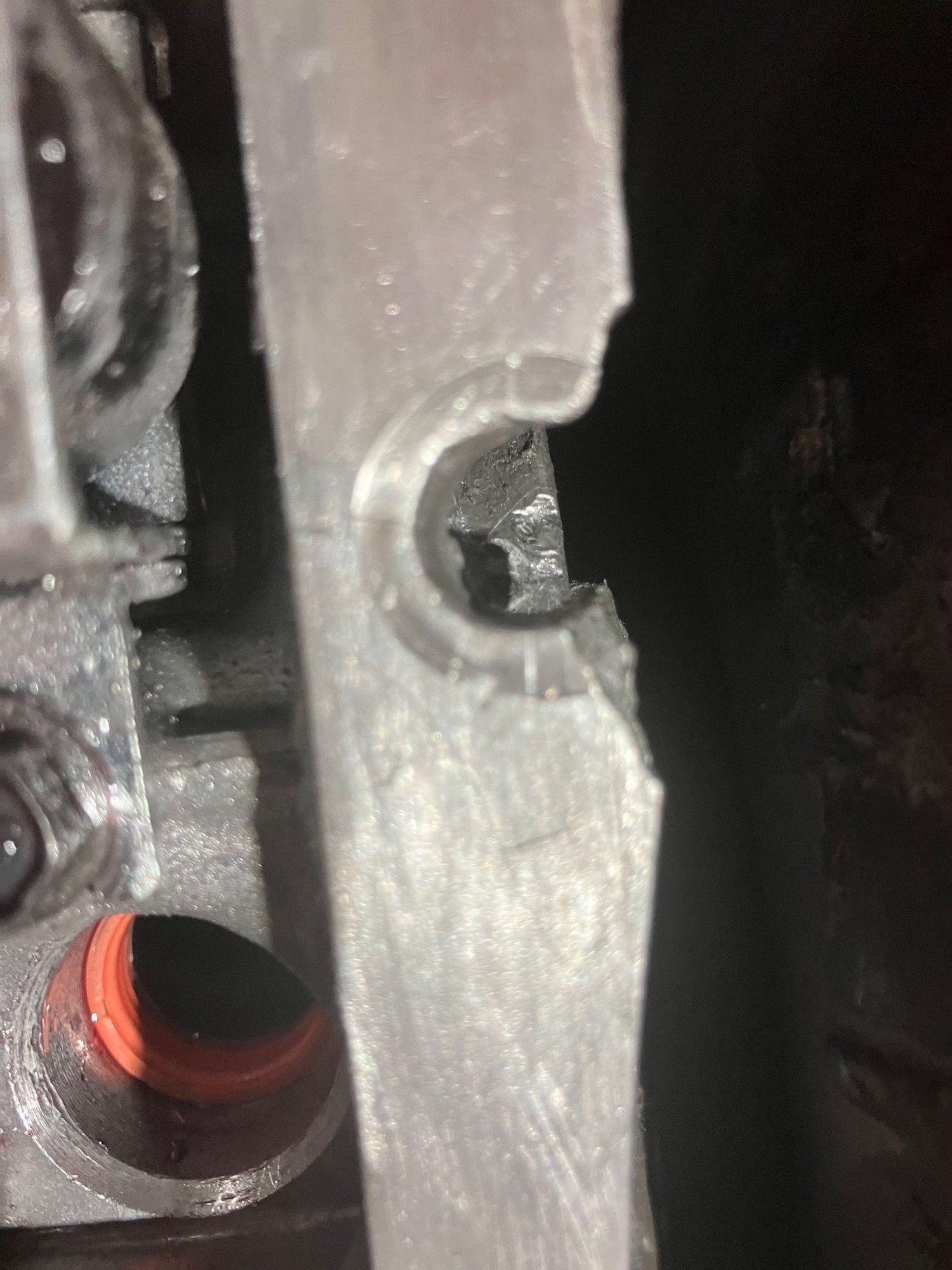

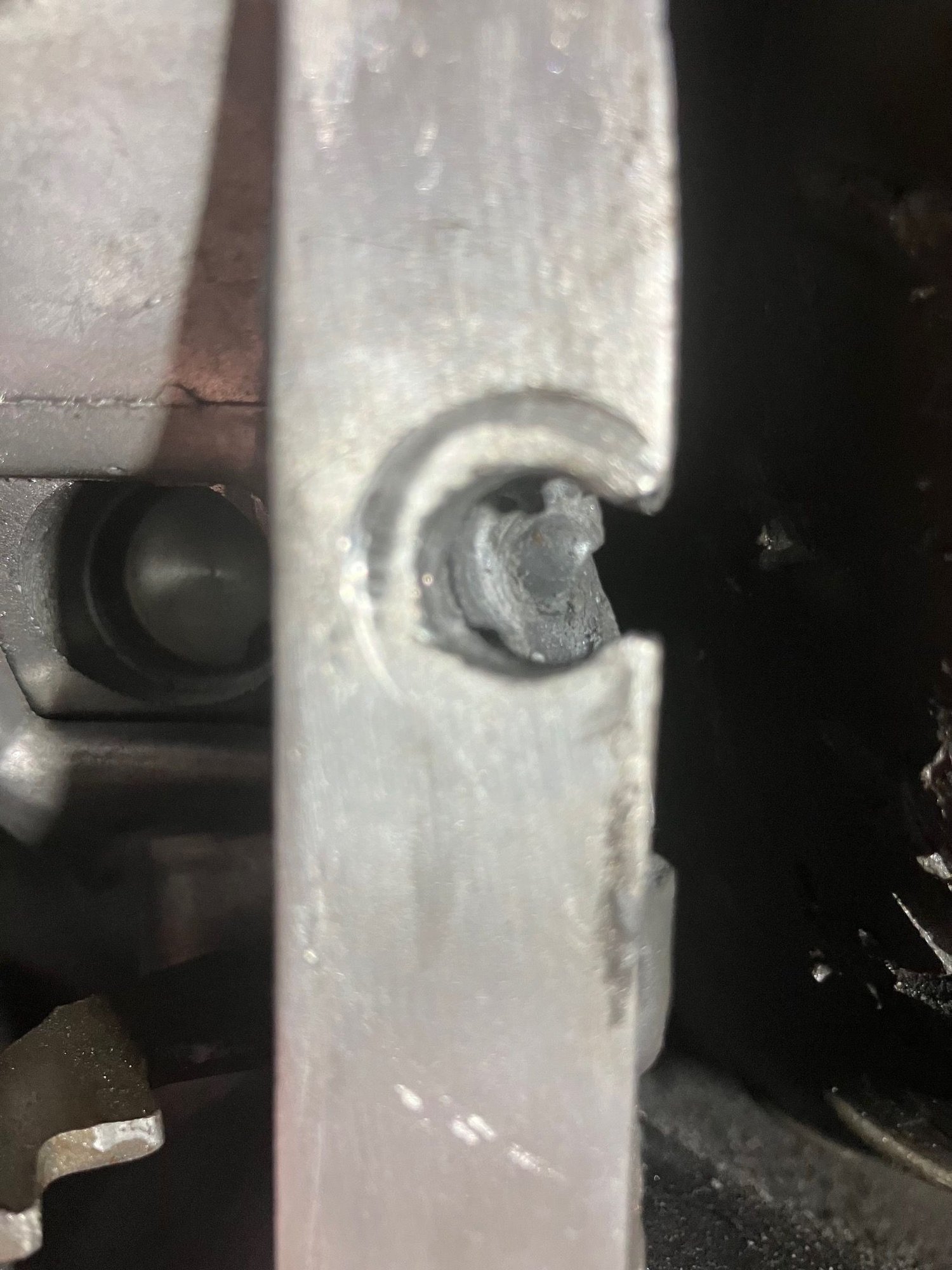

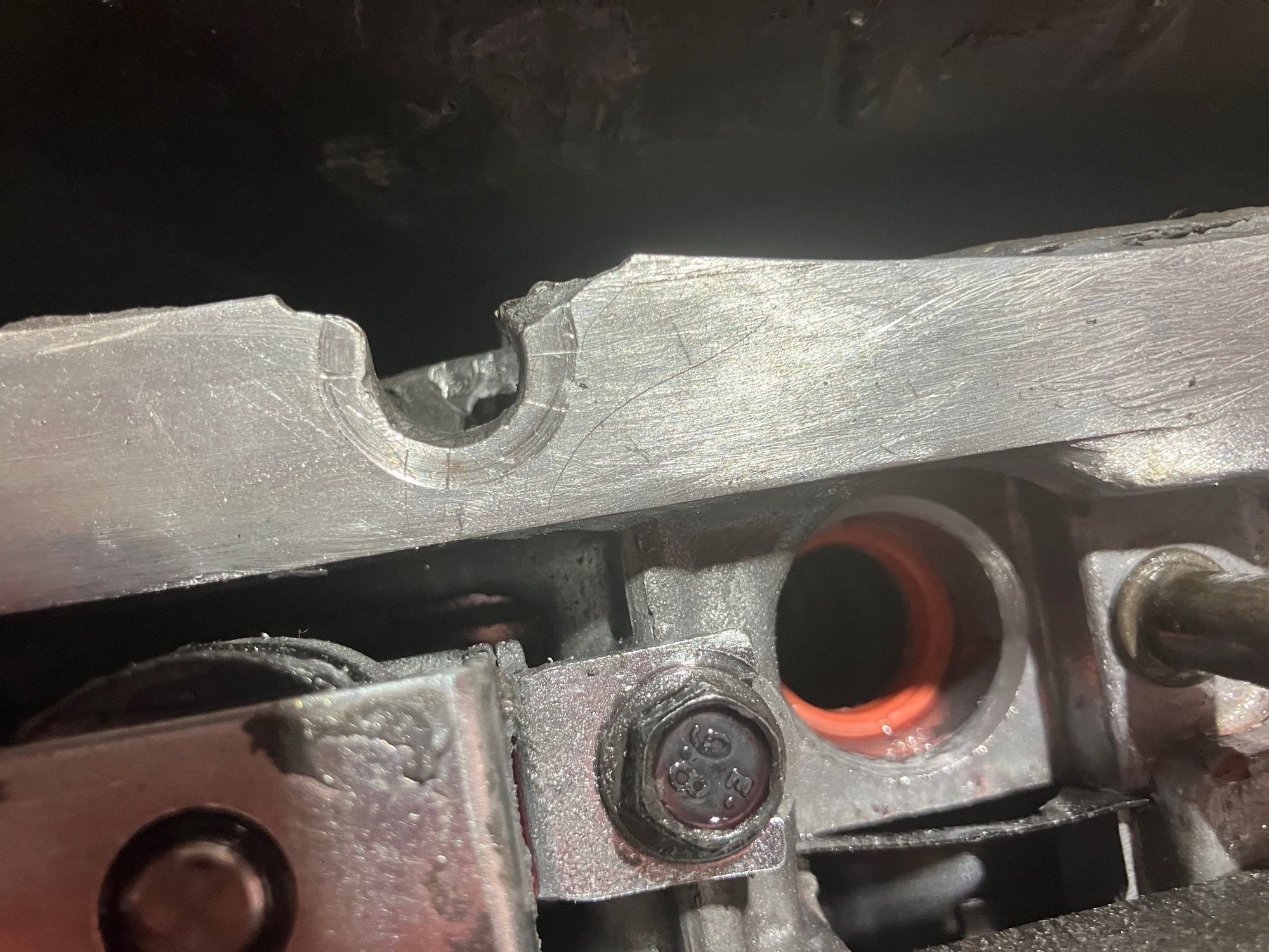

I managed to bust open the face of 2 of the transmission bolt threads on the transmission side. The bolts were the 2 forward center bolts where there is a curve for the transmission meets the dust cover. This is on my 89 S15 700R4 Trans. This mating surface is machined cast aluminum., The proper fix would be a new case or find a weld shop that would tackle the repair. I wanted to find a way to a home repair. I tried drilling the 2 holes out for a Helicoil but the spring would not work with part of the face gone. I tried JB Weld but I could not make it work at all. What i finally did that worked was a hodgepodge of an Idea. 1lb of Devcon Steel Epoxy Putty, 18 Gauge Sheet Metal, I piece of steel tubing from an old blow gun. JB Weld Epoxy Putty (Tube), 1/4-20 black Oxide stud.

Step 9. Wait 14 hours. Attached are pictures of the blown out holes. I did not take any pics of the completed repairs as i was just trying to figure something out. The repair is a success. The repair piece is now a monolithic block of steel epoxy from the back of the case to the face of the mounting surface. The pan is attached and all bolts are torqued equally with no leaks. The only issue is if someone wanted to rebuild the trans and remove the pump some of the epoxy would have to be cut back. I consider this a permanent repair/
