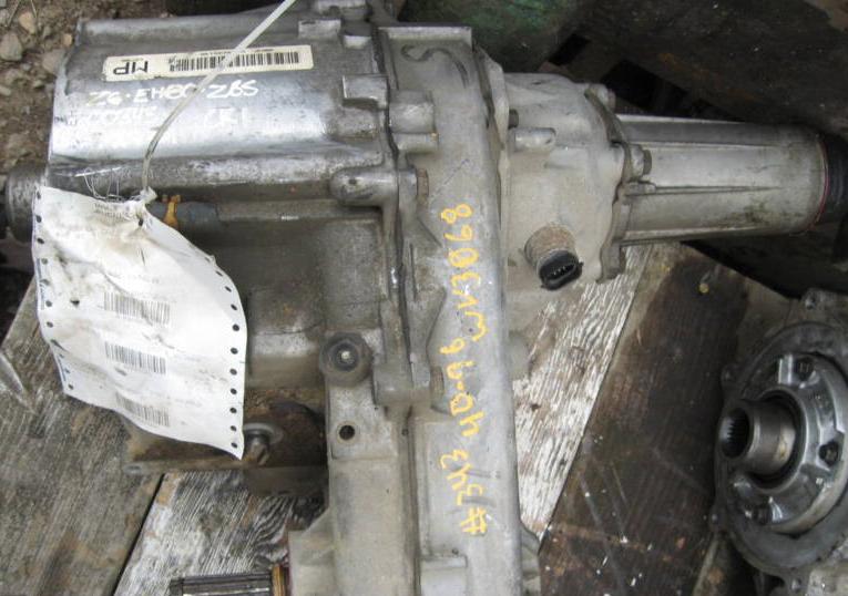

The sensor is likely the one that you removed already. I would not expect to see a code for a malfunctioning VSS. When it starts to screw up, it will likely push other codes (ABS most notably) and will really cause driveability problems that are quite pronounced...
If replacing the sensor does not work, then you'll likely have to dig into the wiring from the sensor to the PCM to get it figured out. I can post the pinouts tonight (can't from work) if I get a chance.
Here is an image of your transfer case (NV233) from the top showing this sensor:

Thanks alot swarlkk that will be great and then i will start from there.!
