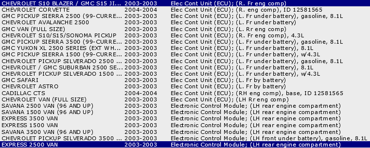

It's the same computer that's used on a ton of GM vehicles, so they're a dime a dozen in junk yards. The picture below is what my interchange system at work says has the same computer, but I'm sure there's actually more that will work. For instance, my 04 has what's known as the "411" computer, and those are used on everything from S10's to Corvettes, just different programming...
