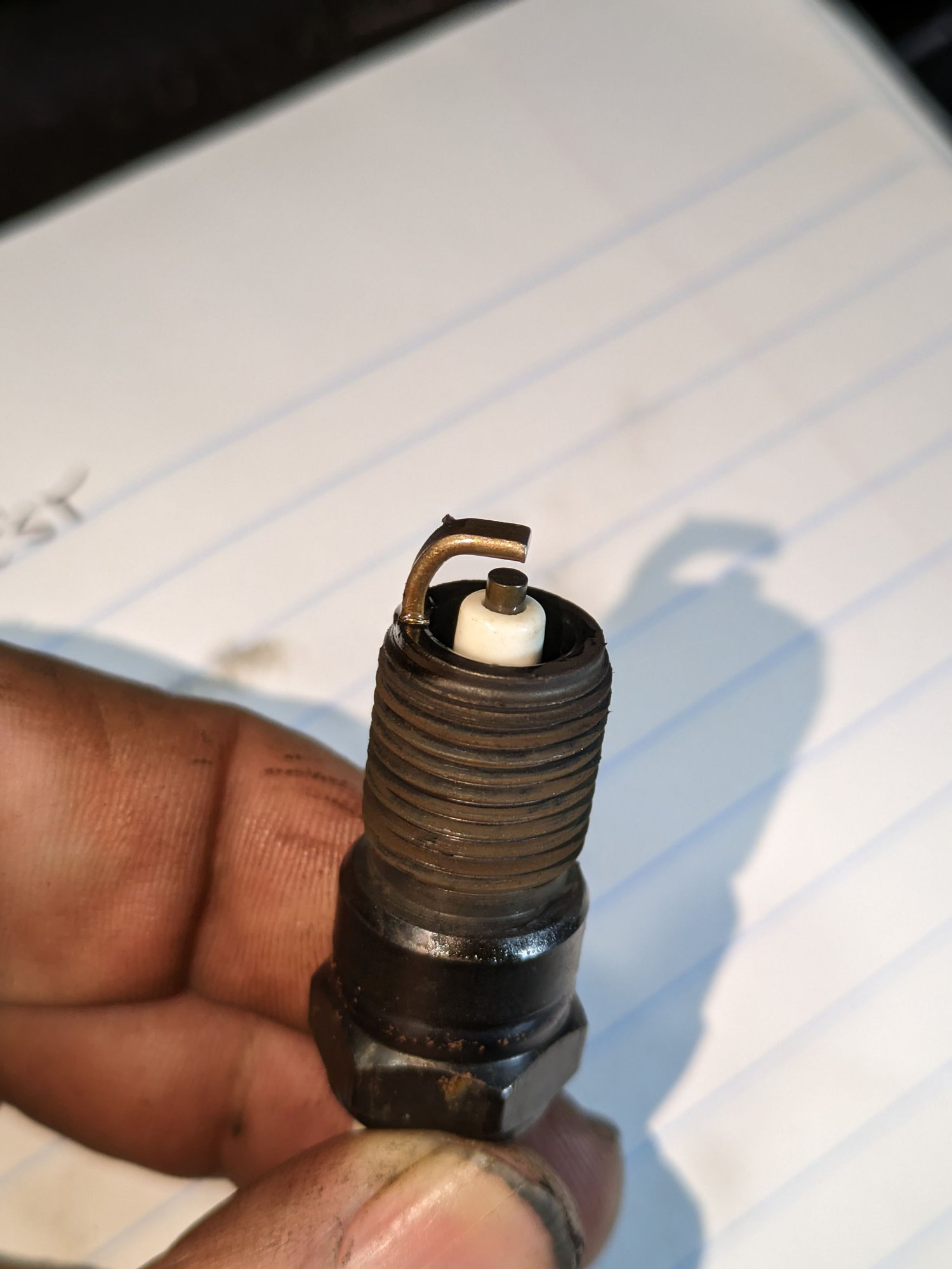

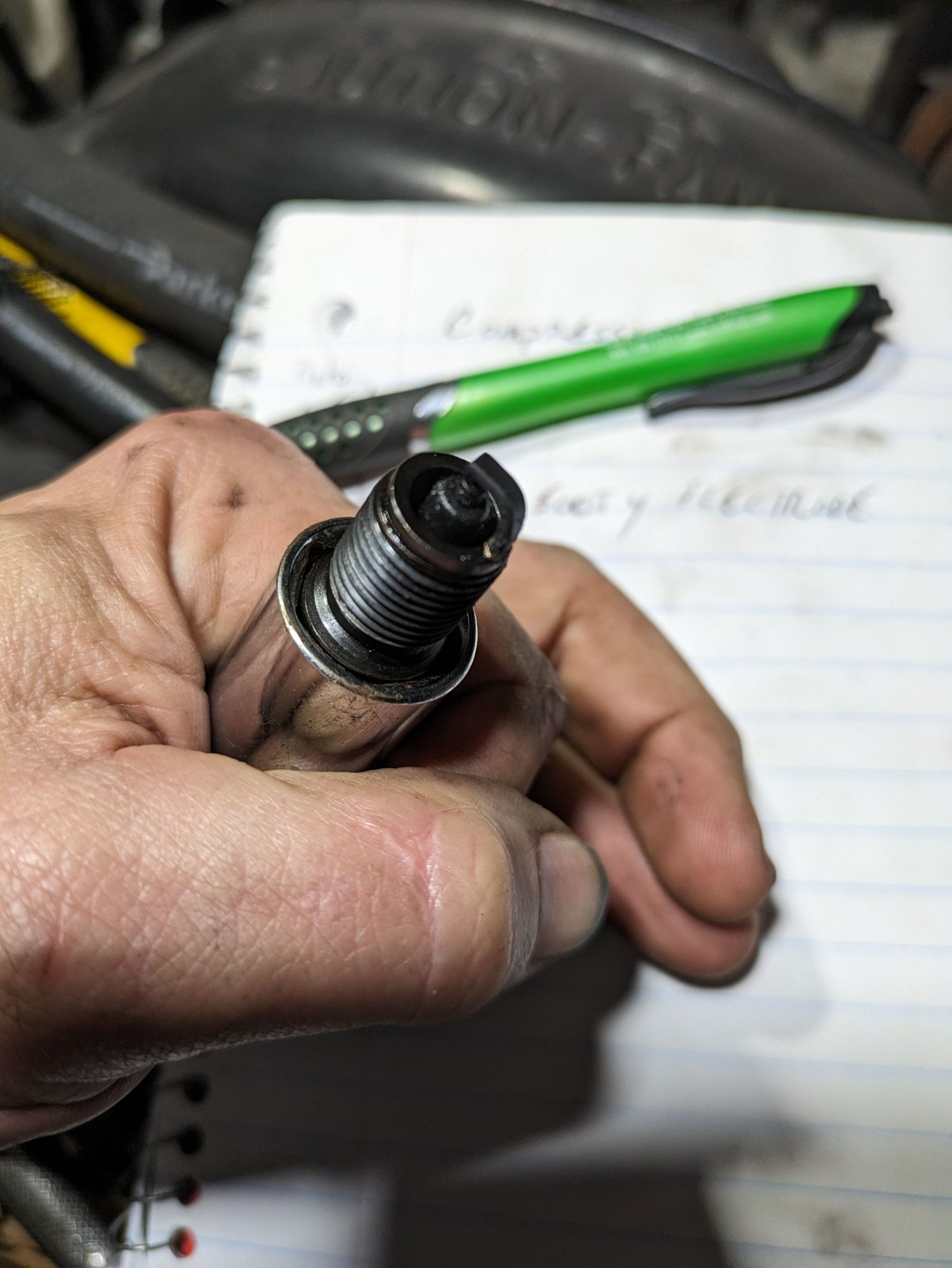

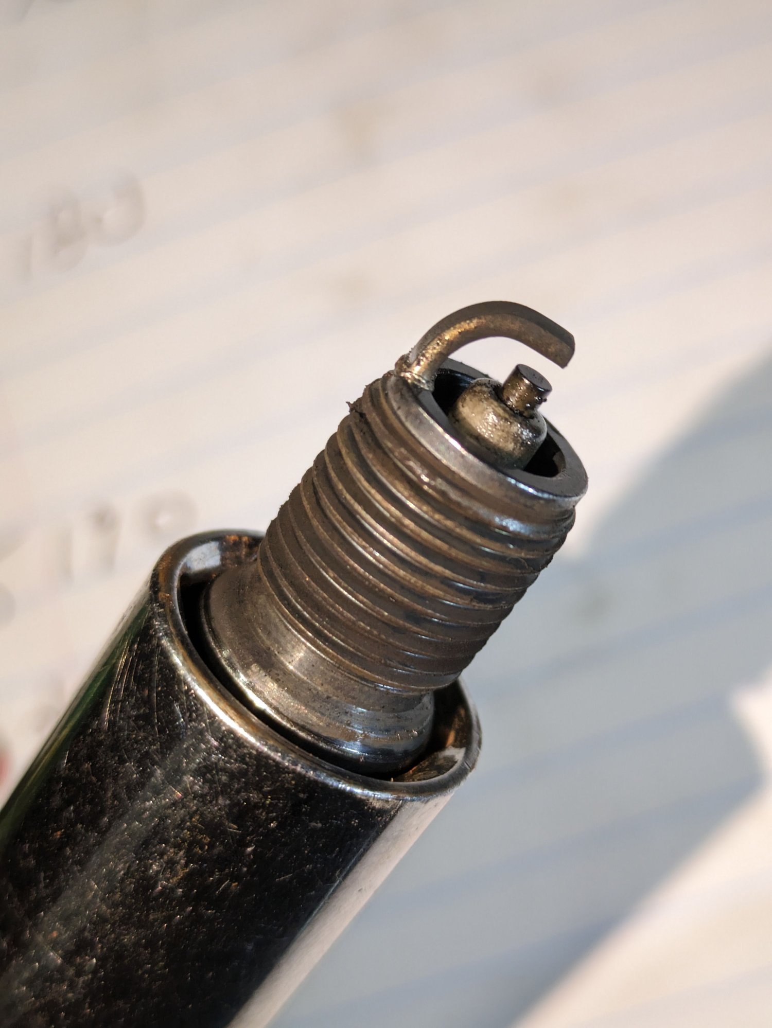

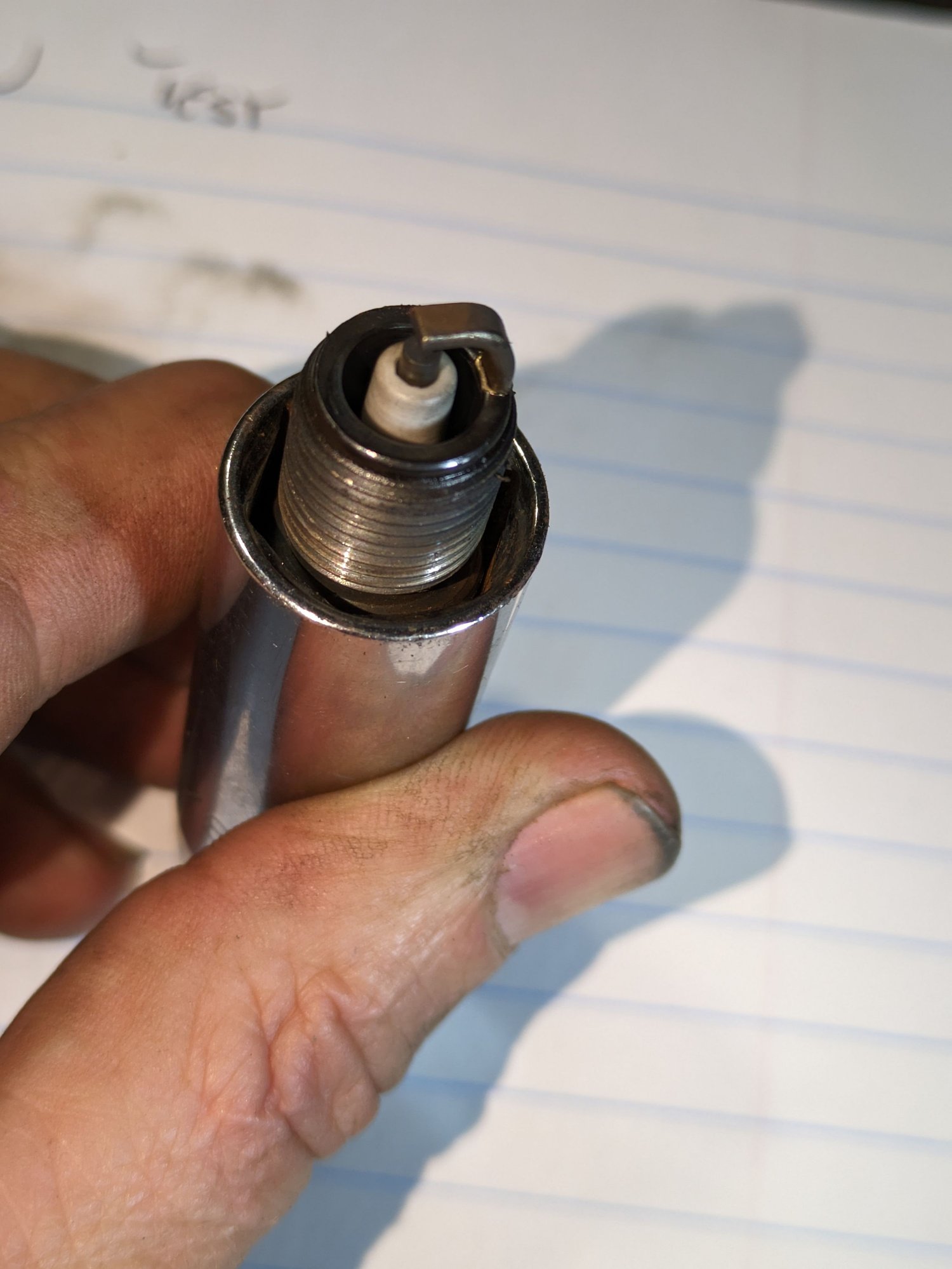

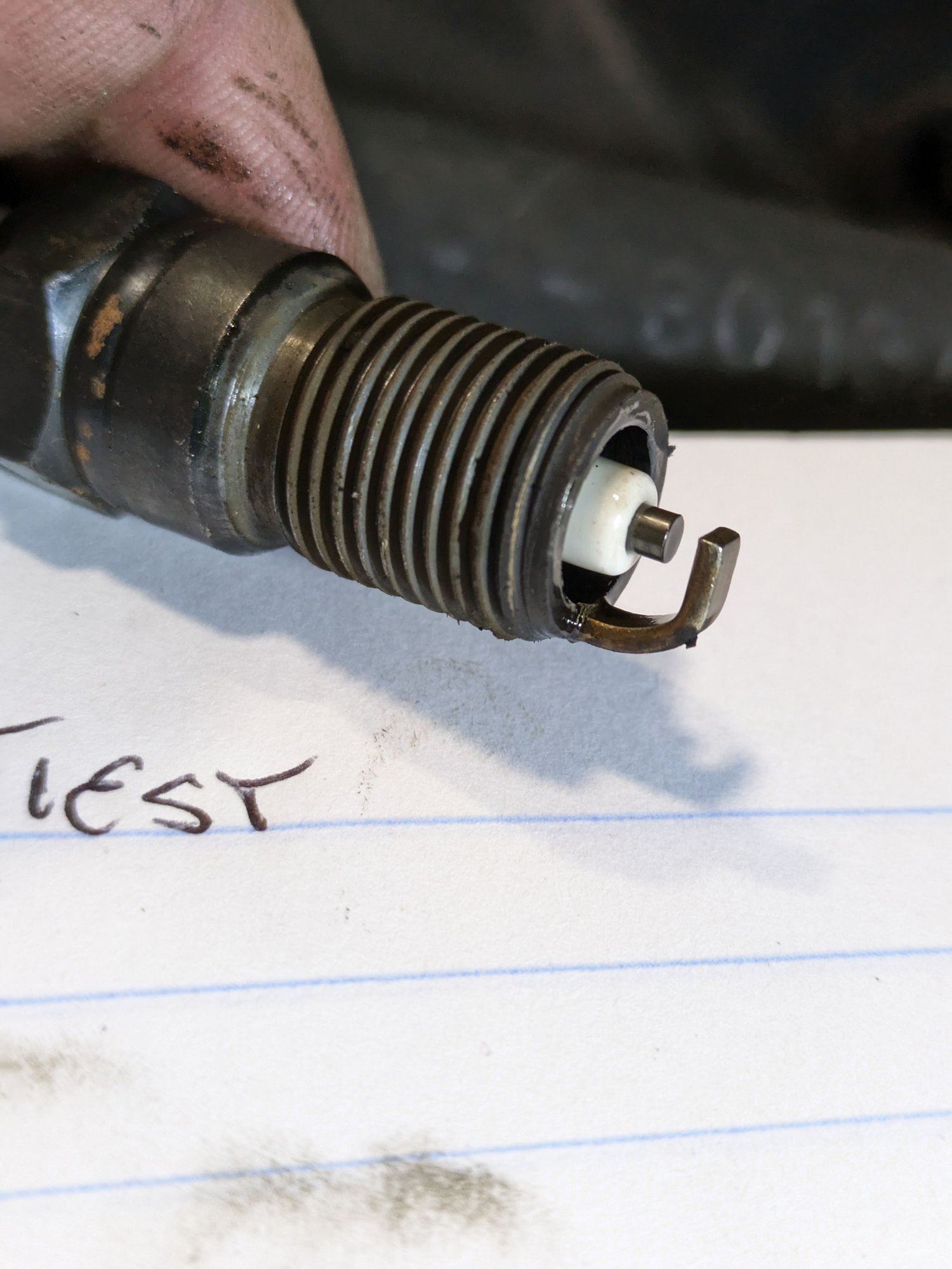

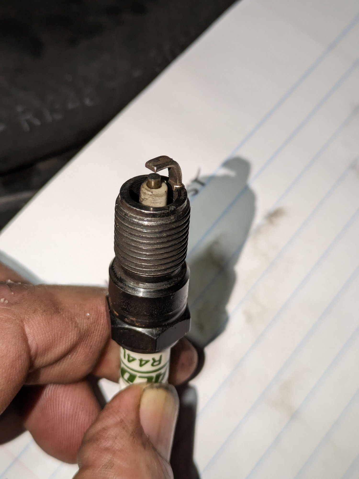

Next I want to see compression check values for all cylinders (no oil), and sharp reasonably close up photos of the business end of the 6 spark plugs. Note if they were wet when removed, and if wet how long it took for them to dry @ temp (no blowing on them)? Also note if there was liquid blowing out of cylinders during start of compression check.
Please provide this info and we can go from there.
Yes sir as stated earlier the Blazer stopped running in the first week of Sept. So 9 to 10 weeks.
Your next question was on cylinder compression.
If the spark plugs were wet and length of time to dry. Accompanied with photos of the the electrodes.
No liquid blowing from cylinder.
Cyl 1 @ 170 psi. No concerns with plug
Cyl 2 @ 180 psi. No concerns
​Cyl 3 @ 180 psi. No concerns
​​​​​​Cyl 4 @ 185 psi. Soot covered/ wet /dried quick
Cyl 5 @ 190 psi
Cyl 6 @ 185 psi Soot coveref/ wet/ dried quick

To me, those spark plug gaps look wide and what do you mean by this line?

Yes sir, on the distributor at the bottom there is a small mark with a number 6 that I understand to mean for 6 cyl vehicles. Its also the point at where the rotor should be pointing at #1 cylinder tdc. Is that correct or ive been misinformed.
Btw... Is it. 050 or. 060 gap. Ive read both and i also read different plugs may use different gaps. I have them at. 060 but I used an old disc gapper that may be off.

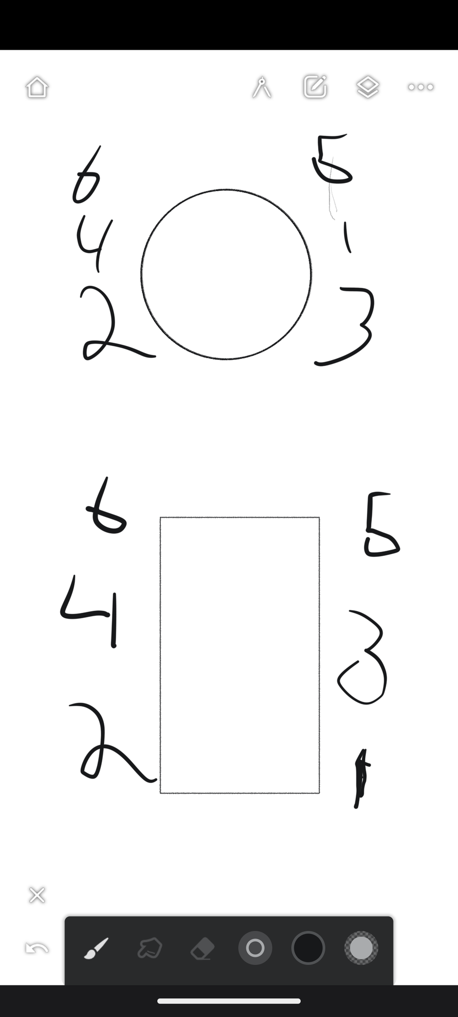

Yes sir thank you again. Im helping my parents today and will follow through with your instructions as soon as i return. But I wanted to go ahead and confirm my wiring is correct before I put the gas in the throttle body and attempt to start it.
This is how I run the plug wires.

Wiring is correct as drawn.
