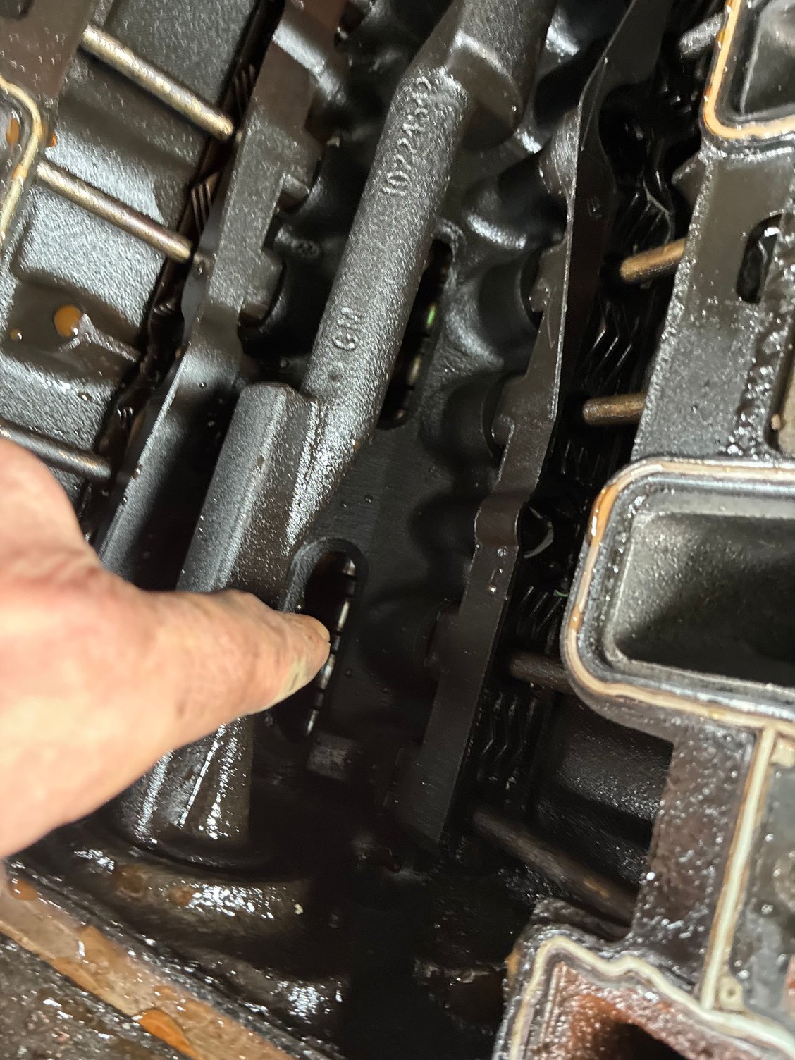

I droped the one of the nutts that holds the fuel line to the spider injector i dropt it in one of the holes on top of the cam chaft it mabe siting on top of a lobe or did it fall in the pan? Or stais on to of the plate underneath and will fall in the pan i dont know what to do went fishing for it cant get it should i just leave it and hope for the best?

You got a 50/50 chance. But even if it hit the pan, I would pull the pan and try to get it out for piece of mind.

I'm sorry Rabith, this must be upsetting.
You definitely can't see the nut anywhere? If it can be seen you might be able to reach it with a 3-prong grabber tool.
I wonder if it would be a good idea to turn the engine over a few times by hand to get the nut to drop into the oil pan if it hasn't already. I wonder if it would be a good idea to use compressed air to help it move into the oil pan.
One time I dropped the spider nut into the intake manifold. After removing the manifold, I could see that the nut had bounced into drivers side head. I was able to use a hooked pick to pull the nut into view and then remove it.
It is a good idea to lay rags across the lifter valley so if a nut drops it can be retrieved. Same thing with the intake manifold, coolant ports, intake ports, and exhaust y-pipes if they are open.

Ditto. You risk the moon shooting for the stars. You gotta get that nut before you crank that motor....

It should fall into the pan when the engine is cranked. Probably stick to a telescopic magnet fishing through the drain plug hole. Or maybe use a good drain plug magnet and try to retrieve it later. You have limited options without pulling the engine. Good luck!

Les makes a really great point, maybe the nut could be retrieved without removing the pan.
After draining the oil, you might be able to find the location of the nut by hitting the pan gently with your fist or a rubber mallet and listening for a rattle. Then maybe you reach the nut with something like a coat hanger.

If you have an aluminum pan and can find one of those really strong magnets - if the nut is in the bottom you could probably drag it to the oil drain plug hole by working the magnet on the outside. might be worth a try.

Do you have a video boroscope for your phone?
