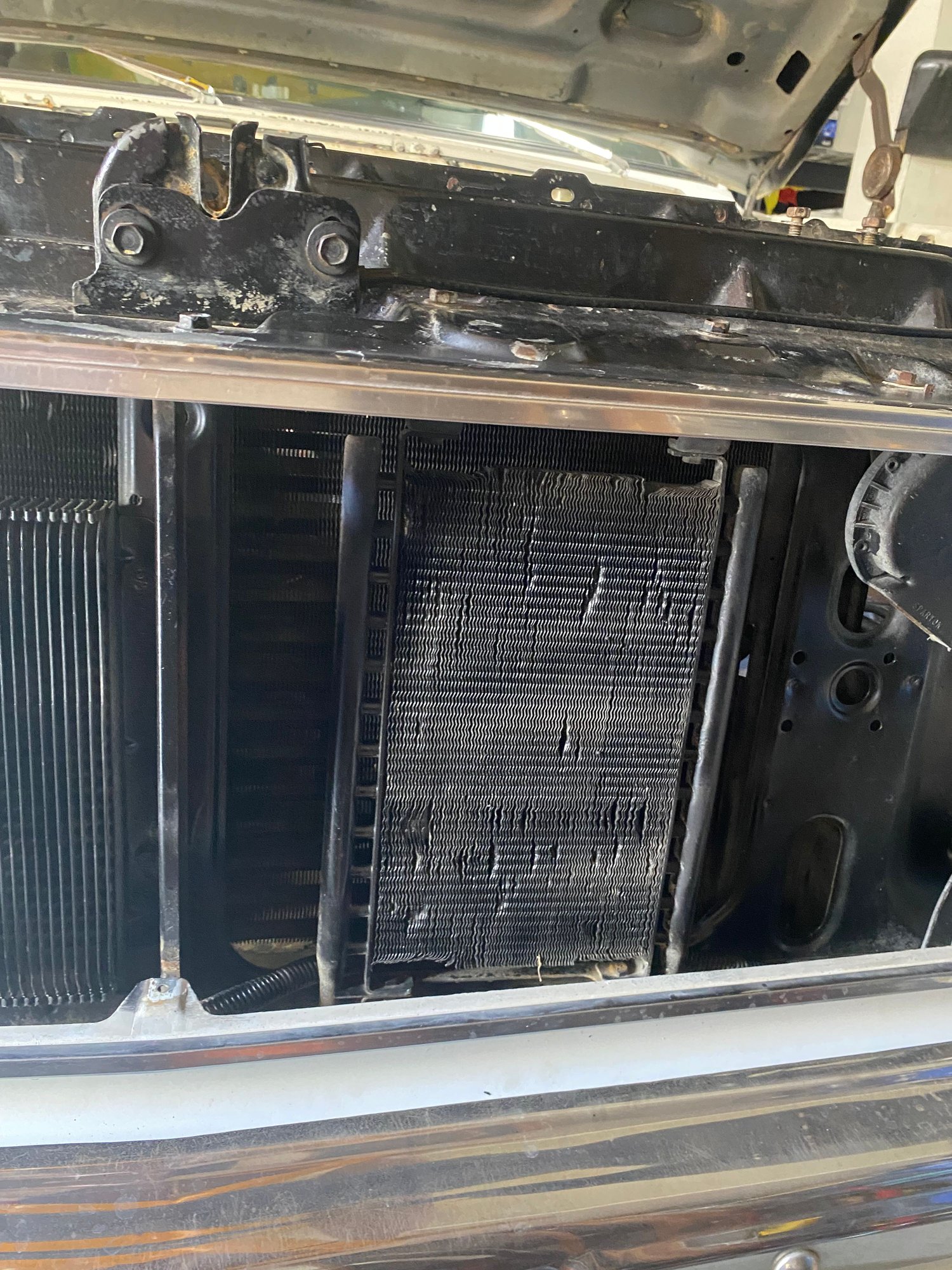

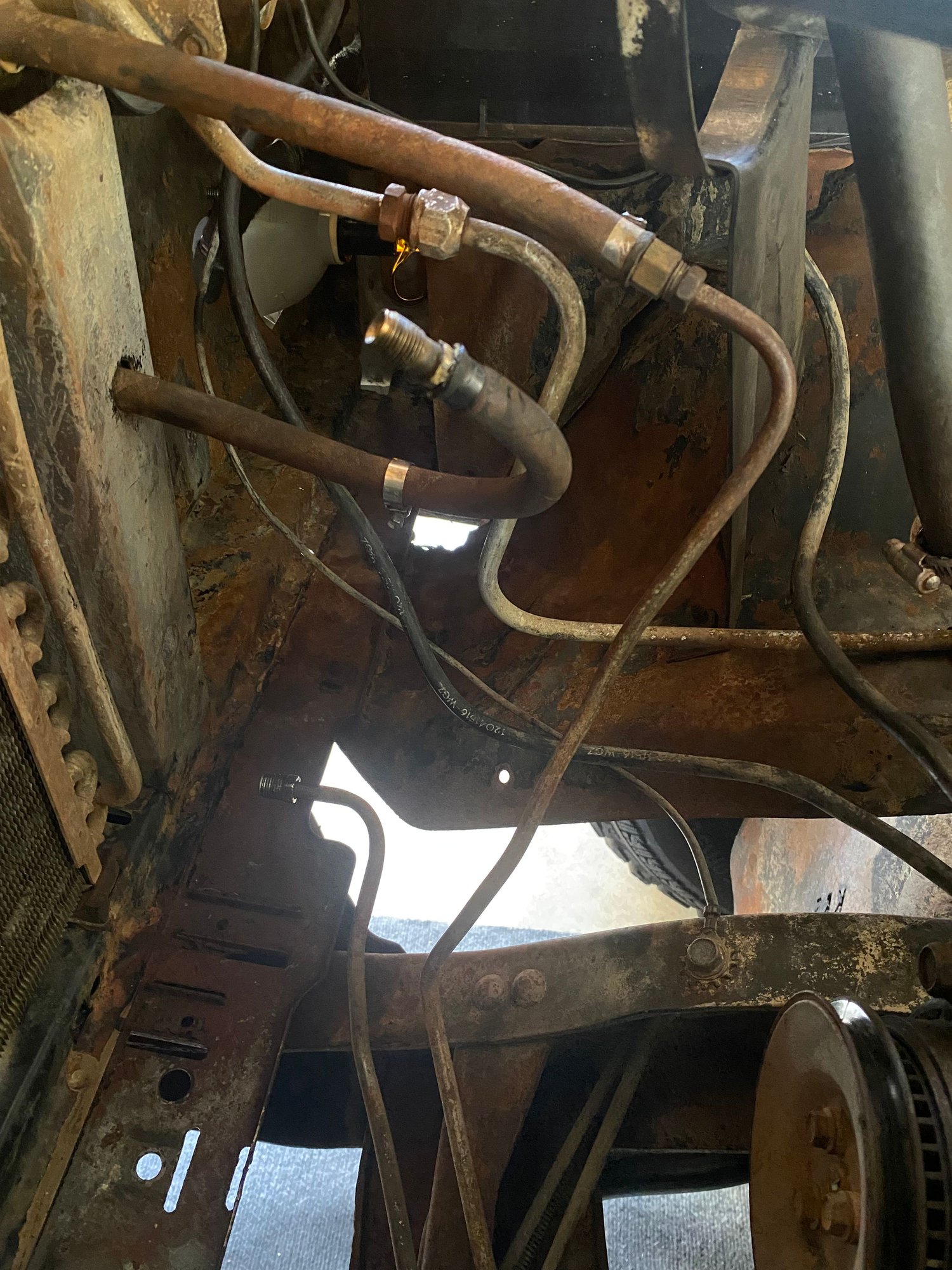

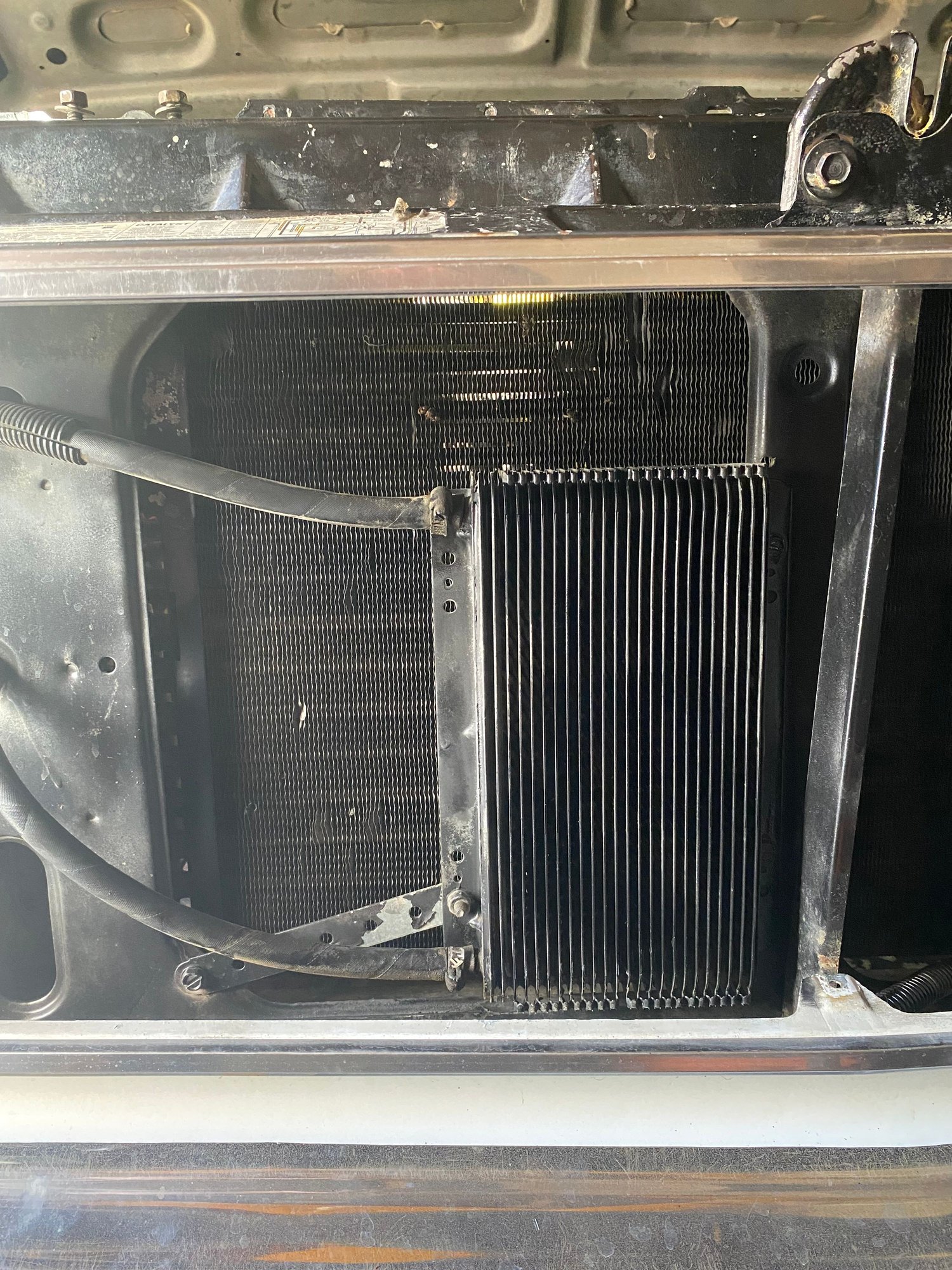

Old radiator.
Old radiator.

The cooler on the passenger side looks more modern than what would have been there from the factory and typical factory piping would have been all hardline for the transmission. It very well could have come with an auxiliary cooler that someone replaced or upgraded sometime in the last 40+ years. The stacked plate cooler likely has a low temp bypass built in.
The cooler on the driver side is likely for the power steering. You can trace the lines and see where they run.
