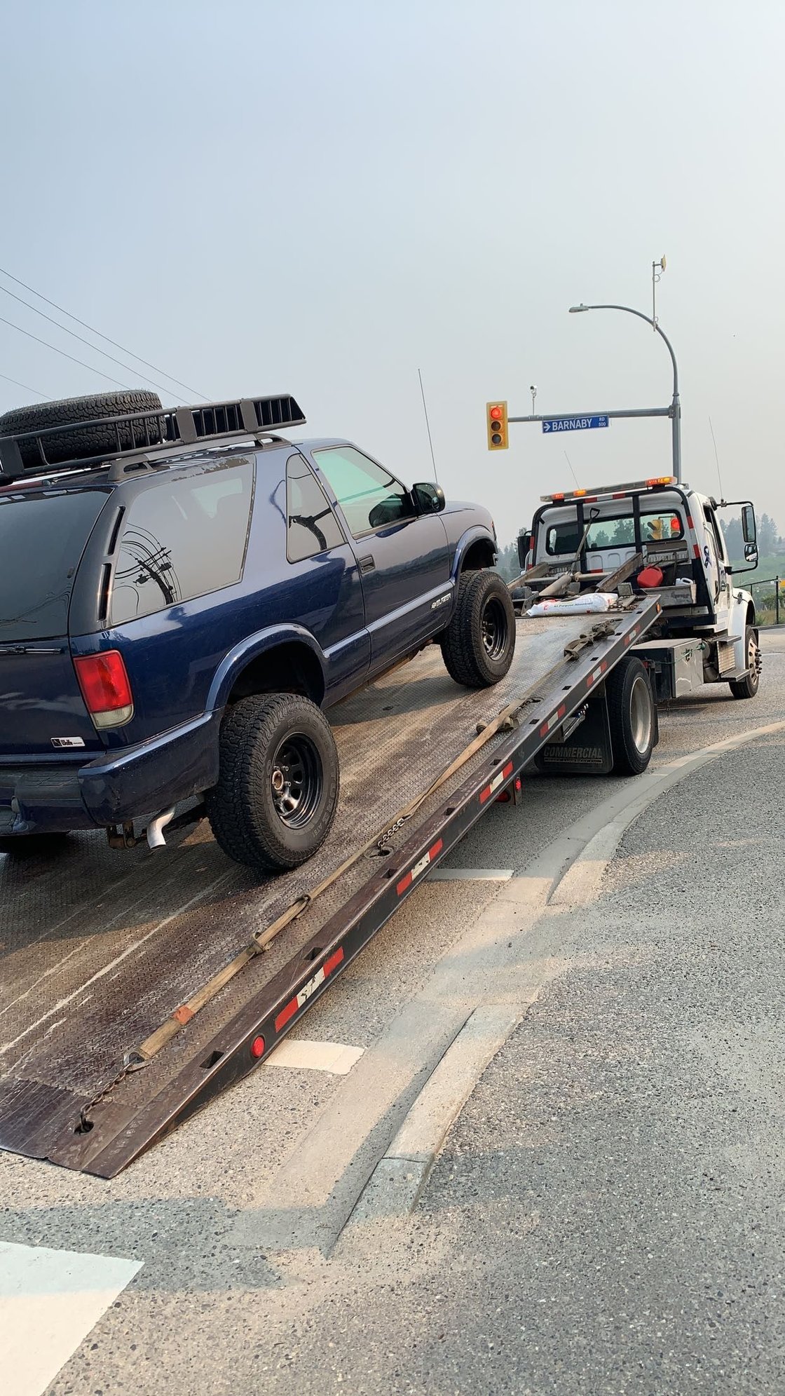

Well guys, the hits just keep on coming! I've been slowly working on a cold start problem lately, the blazer would always start up just sometimes it would take a long crank in the morning (getting worse as of lately). This morning when I started the blazer up I noticed it dipped 2 times right when it started, like it was close to dying. It hadn't done this ever before and my mind went straight to possibly a fuel delivery issue, however, it seemed to be running great after those 2 dips so I proceeded on my way to work. The blazer made it 3km from my house before I stopped at a red light and it died, I tried starting it again and it ran very poorly and then died when shifting into drive. I got it towed home then tried starting it again, and this time it was running flawlessly and the computer confirmed by telling me no misfires and the fuel trims all looked in check, sensors all looked good with it running in closed loop. After work I started it up again and took it for a drive to get it up to operating temp, all was great. I will test the fuel pressure when I get a chance and report back (I'm thinking tomorrow morning since that's when I've been having problems so far). I'm kind of suspecting the fuel pump since the rest of the fuel delivery system is new, I will need to run some tests and see if I can catch it acting up to confirm though. Les, George, and everyone else, I'm looking for your help to get this one sorted out and get my blazer back on the road quickly! Let me know what you guys are thinking.
