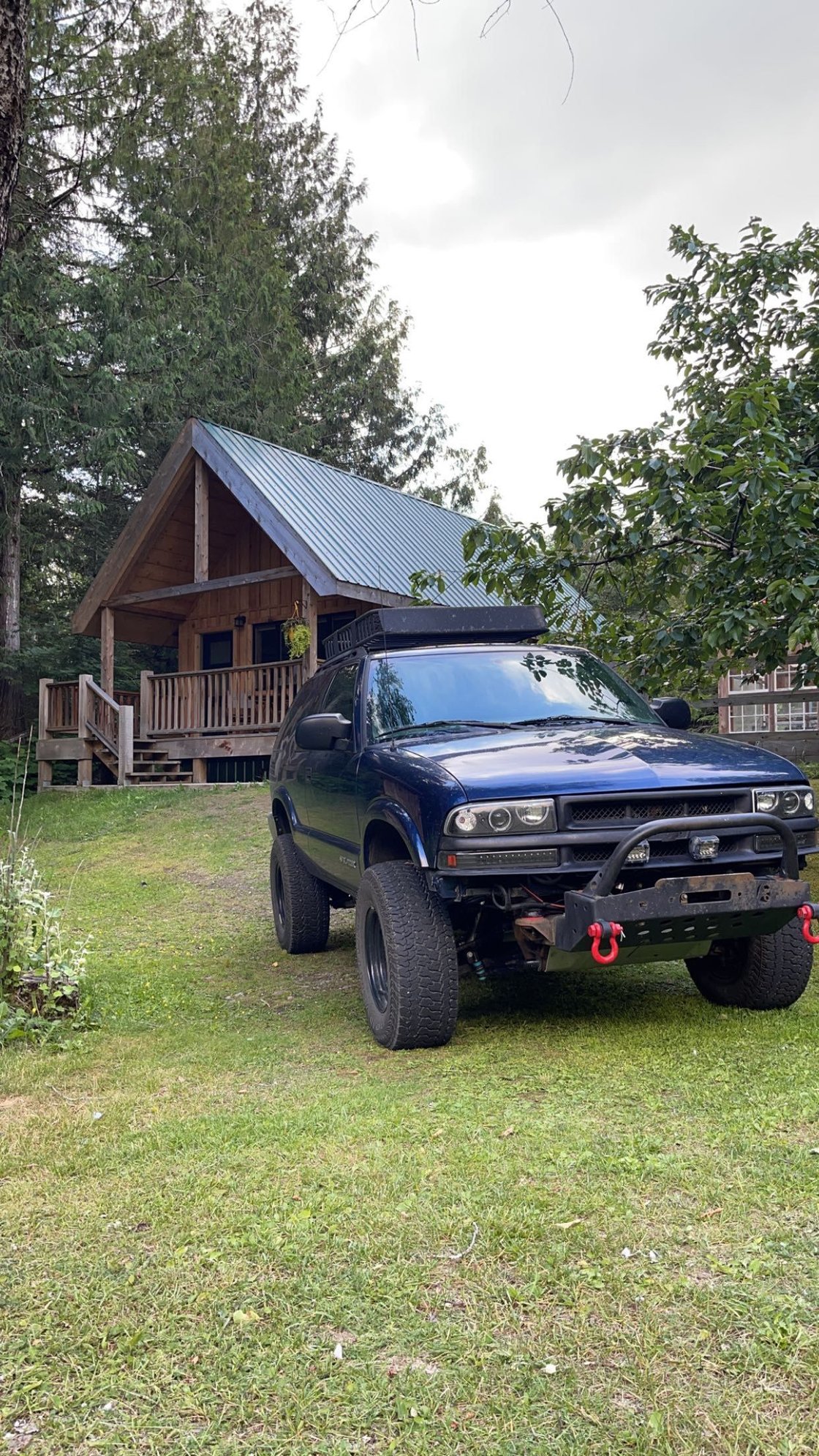

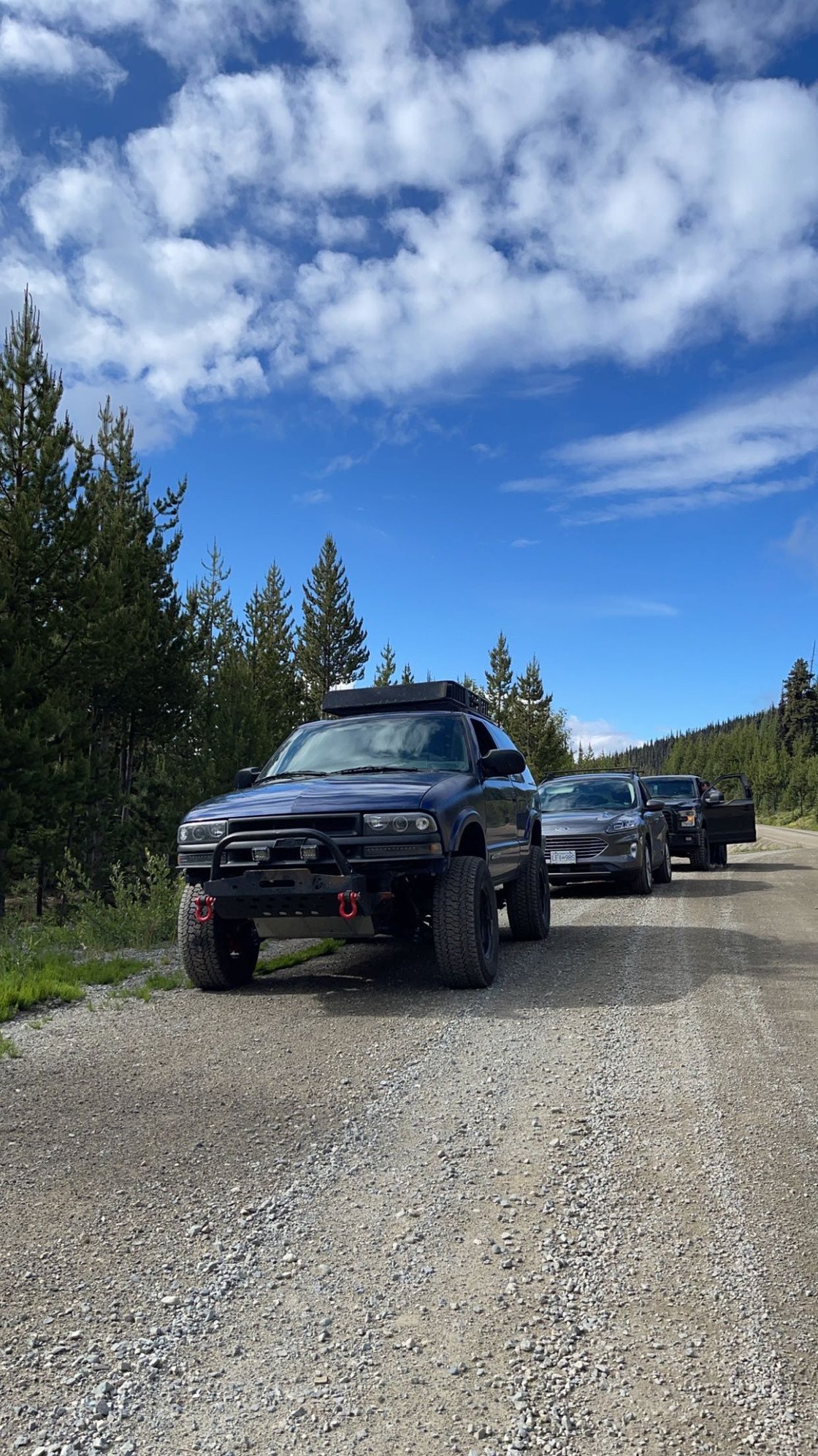

Thanks Les, I got the rear pads done Thursday after work and was off Friday morning on the trip! It felt surreal making it 900km there, with 90km of dirt road named one of North America's most dangerous highways (read here), me and the blazer shredded all 900km like kings! Then again 900km today on the way back with NO issues whatsoever. She kept good temp the whole time even going over passes and the suspension is dialed, I had her pegged at 120km/h all day and she feels amazing no shaking or anything as there has been before. Really happy I shimmed that bump stop it worked a charm the whole way even off-road, the new axle was never binding. The self-pride I feel right now is amazing, I have built a beast! She can go 800km on the highway then lock the hubs in and do another 90km of dirt road with no hassle! I even shed a few tears when I got to the dirt road on the way there, very proud of myself! I'm very thankful you have been here Les and willing to help me with all of these things, from the engine to when I crashed it to putting the front axle back together and countless other things you are always there and willing to help me make things work!
