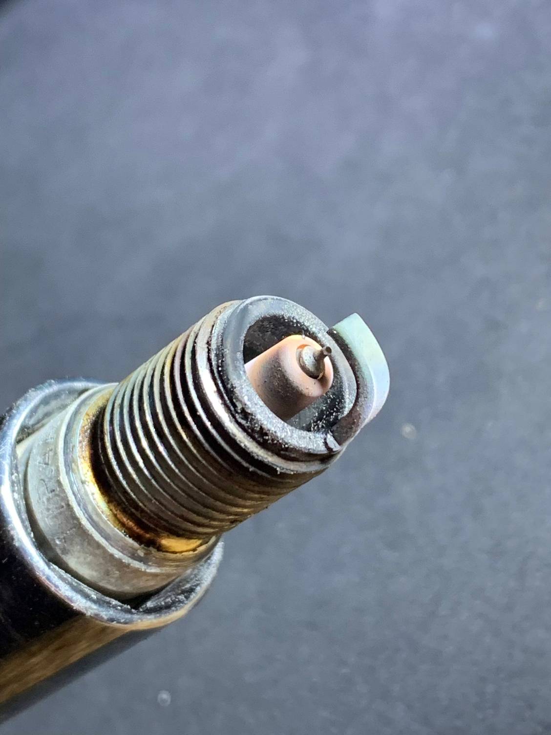

Thanks Les, the only code was P0420 which has been there for a long time now. I pulled a plug and it looked fine, didn't look like it was running very rich. I also did the spark test again yesterday and found good constant spark when I tested. I then realized my IAC valve was making some funny noises so I took it out to inspect further and made the pintle and spring shoot out lol. I swapped in another one I have had, and its motor sounds much nicer. In the video below, the first valve is the original, second is the one I swapped in. So here's a little backstory on my experience with IAC valves, I had the original one in, then it was causing me a problem where the truck would not idle at all but run perfectly if I was on the throttle at all, then the next day with changing nothing it was able to idle normally again. So I still replaced the valve with an aftermarket one and never had any more problems like that, then I thought I was having some other problems with this aftermarket one so I swapped the original back in and have been running with the original for a few months now with "no issues". I'm thinking I have solved that stalling out-of-nowhere problem now... I was thinking about it and it seems to be almost the same thing where sometimes it will idle fine, then sometimes stall when letting off the gas, but runs well off idle. I also started it up 4 or 5 times yesterday at the certain temp (in different heat cycles) and it never gave me an extended crank. Fuel trims still look rich though. I also tested the primary and secondary windings of the coil yesterday and found both within spec (0.3 primary, 5750 secondary). Will be playing with it more today to see if it will give me an extended crank still or if I can get it to stall again. https://youtube.com/shorts/DaB8Em5dtGw?feature=share
I am leaning toward replacing the ICM here because of the inconsistent spark and persistent rich trims, I think ICM not coil because the coil looks great it can jump the 1" gap with no problem and the spark looks strong. Additionally, the resistance tests showed nothing on the coil, and all other system tests have resulted in good. If I still see problems after replacing the ICM I may look at replacing the coil, they are both the only ignition components that are still original, so I don't really have a problem replacing these for the reliability of my blazer. Especially with this big 12-hour trip coming up. On that note in the last few days while being around in the bay I noticed a very small coolant leak from the driver-side pump gasket, I think it's fair to say this is my fault, those damn gaskets are so hard to line up while the accessory brackets are still on with the alt and ac compressor up in your face! Thinking I will take this opportunity to swap out the thermostat for a fresh one as that's the only thing I haven't replaced in the cooling system thus far, I was also looking at some threads about the pump and I may try a thin layer of rtv on the pump when reinstalling so I can just stick the gasket to the pump and don't have to play around with dropping the gaskets again. Either do something like that or install studs in the block I'm thinking, the studs would be a little bit more involved task though.

I think you've done about all the diagnosis you will get done easily. So I think I agree that it warrants an ICM out of the parts cannon and see if that is it! Good luck getting it ready for the trip. Let us know.
