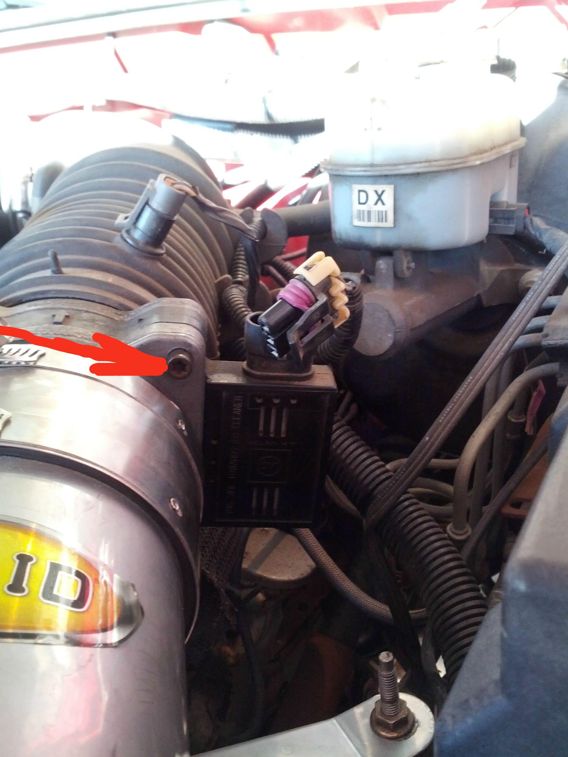

So I'm on my second Blazer and this one is a 2000 ZR2 I've had about a year now. It has always felt a bit slower that my '97, and seemed to lack power between ~1200-2500 RPM. If I hit it with WOT. If I drove normally and didn't mash my right foot, it would behave nicely. However, if I wanted to get a quick start from a light or pass someone on the road, it would always hesitate, shift slowly, and the struggle to get moving. It was like a dead zone of power. I'm not sure if I read this tip on here or on a different thread, like ZR2USA or something, but as I was tinkering on my Blazer the other day, I remembered a post about trying to drive it with the MAF unplugged. I thought I'd give it a shot.

Holy cow did it make a difference! It feels like a new truck! Plenty of power, no dead zones while accelerating, and sounds much healthier. The only other difference besides the CEL being on, is the thing now seems to shift at a higher RPM and the shift also seems much more stiff/abrupt. Even when I shift from P to R or D, it feels like it clunks and shutters the vehicle, which it did not do before I unplugged this sensor. Should I be worried about this? It ****s like my '97 did, it seems to snap off up-shifts like a much newer vehicle does, and sometime even chirps the tires between 1st and 2nd. Any reason I should NOT keep running it like this? Could I do permanent damage to something? I want to make sure before I start driving it 50miles round trip to work again. Also, what if any effect will this have on MPG?

its either a bad MAF or vacuum leak. Sometimes they are beyond cleaning. I notice the picture it looks like an aftermarket filter housing. Is it oil charged? and where does it suck air?
i was going to say this too.
sometimes the filters have too much oil and it gets sucked into the engine,thus covering the maf sensor. it can cause what you are experiencing.
