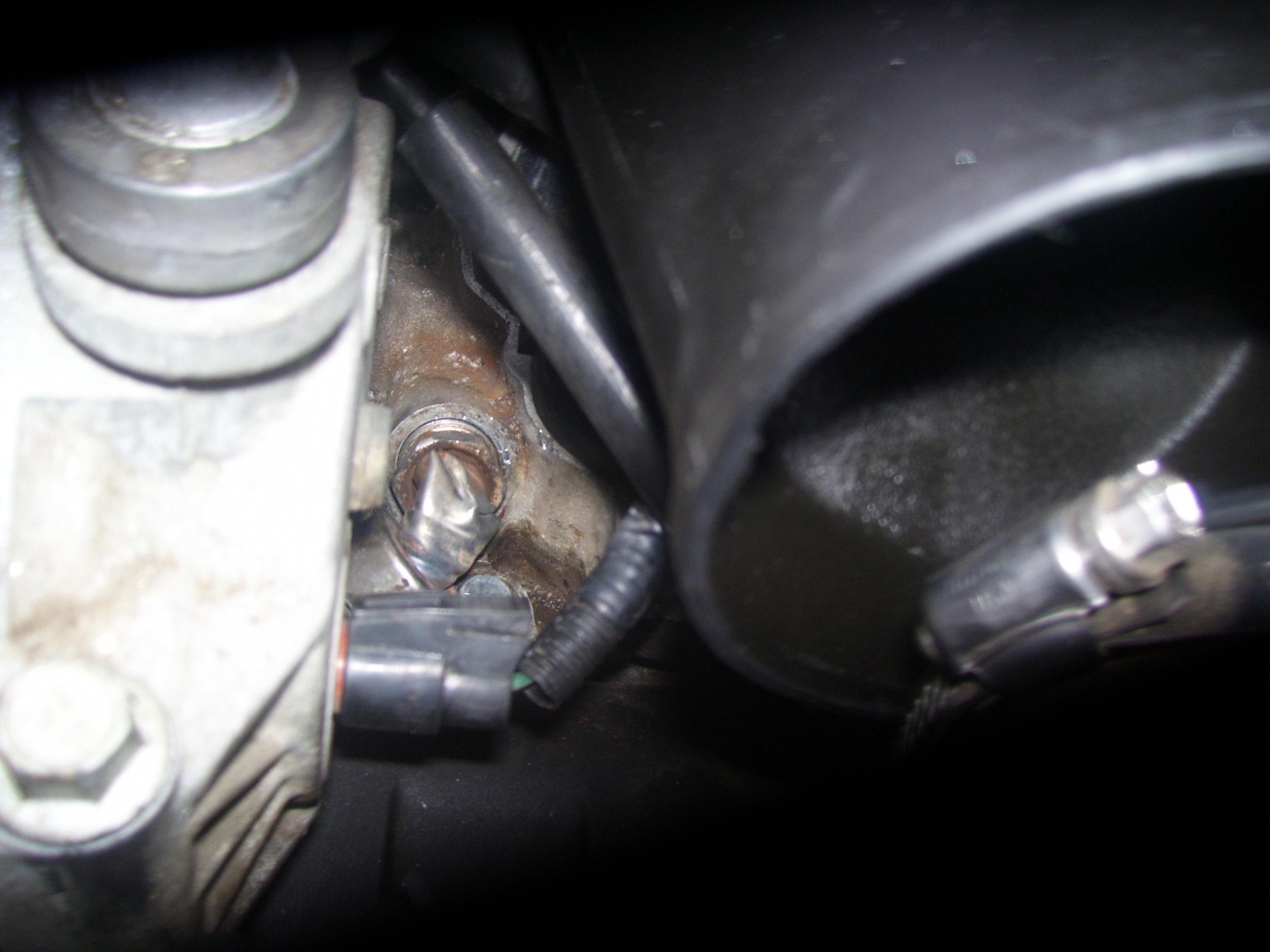

I have a 96 Blazer with the injection that looks like a carb.
I have this line twisted and it goes nowhere. I have codes 1153 and 401 that the shop says could be related to this piece. It is getting real bad gas mileage too. Think it is in limp mode. If you know what it is please tell me and get some pictures of it not broken.

I figured it out. Went to the junkyard and called arround and could only get it at the dealership. Junk yards won't split it up. It is 168 I figure what the hell is another 200 dollars. God I love this thing. Please tell me it is going to be worth it. I better get years of untroubled miles out of this.
So the shop thinks that once we get this hose replaced that it will fix the codes. I can see the EGR flow code but I can't see the O2 sensor code but I'll keep my fingers crossed.

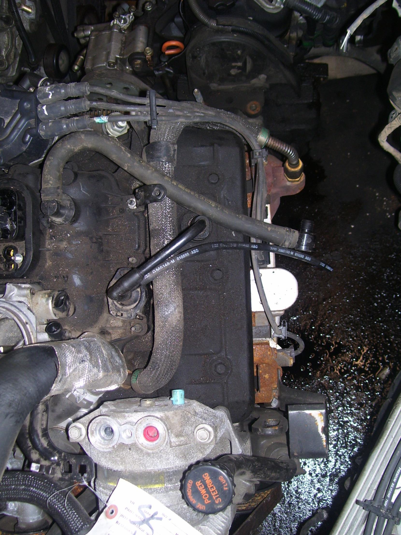

What part are we looking at specifically? The PVC valve whitj mount and gromet with the vaccuum line coming off of it? And no you don't have carborators, you have injectors, which I believe is a CPI on this model. Anyways a describtion of were the part is exactely and what it looks like would be helpful, so we can track on the pictures what you are looking at.
also looked up codes, the O2 sensor should be replaced if it is giving a trouble code, the egr valve can be taken out and cleaned carefully to salveage it(GM egr valves are expensive) O2 sensors are not bad, and if you are looking at the PVC valve that one vacuum line can be reattached without having to by that whole plastic peice.

The twisted off hose is the EGR supply pipe. The last two pictures you attached show an intact pipe which goes from the exhaust manifold up to the intake manifold.

I'm not sure if that would cure the P1153 code, but I would fix the pipe first and then reset the PCM (disconnect the battery for 15-20 minutes) and see if it comes back.
