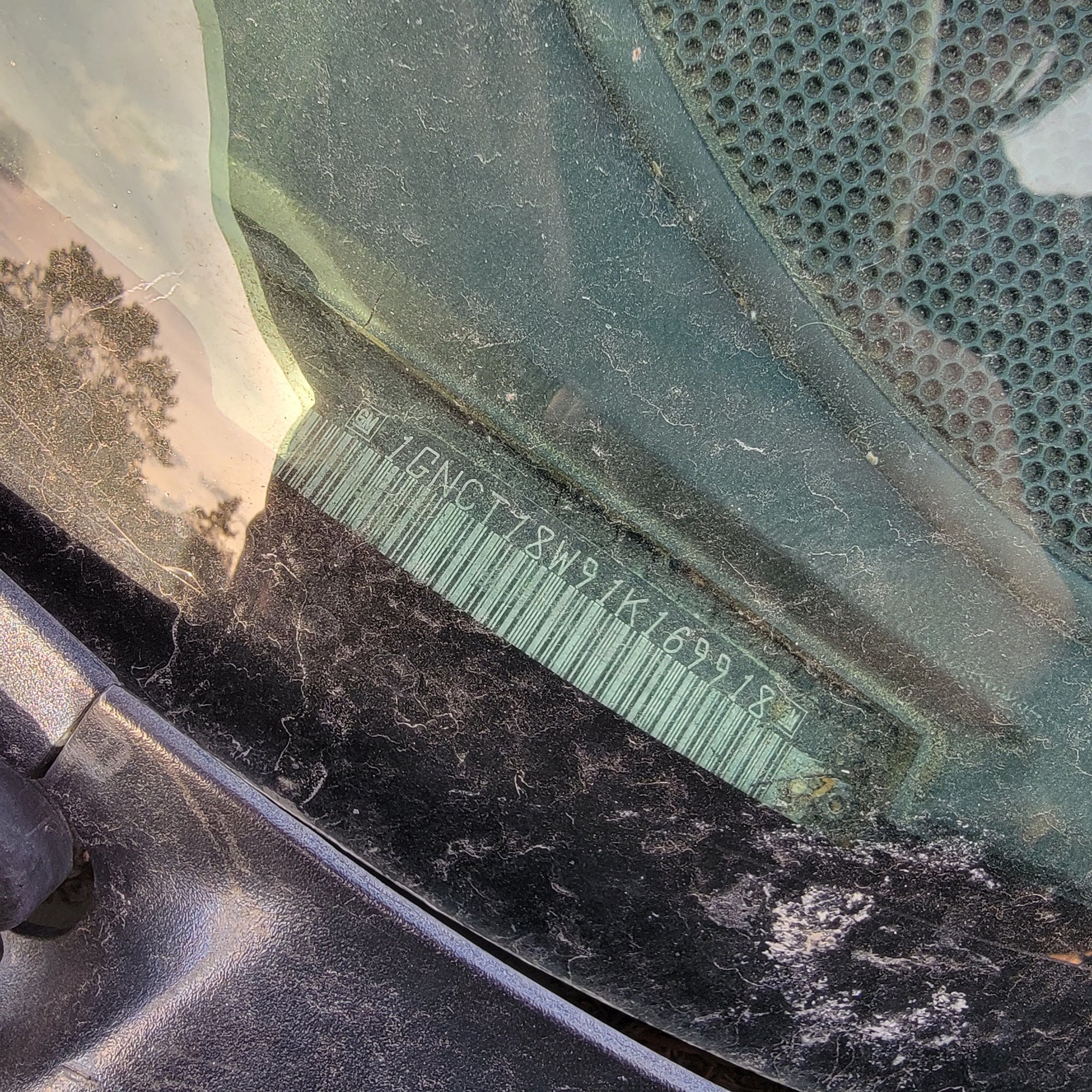

This is my first post so I'm sorry if it's not in the right place, I have a 01 blazer and the front end locked up on me. and I narrowed it down to my front differential ( I pulled the front drive shaft and it didn't help)
So my question is if i go to a pick n pull yard, and get a front diff is there anything i need to look out for because i dont know what gear ratio myn is. Or are all of them interchangeable? I looked on the front diff and can not find and code or anything
01 blazer
2 door
​​​5 speed
I added the vin if anyone knows about these thing well enough to give some info

OK. So then the next step is to find a VIN decoder that will then create a list of all of your RPO codes. I did this a long time ago with my Blazer and it was super useful to have. Unfortunately I forget where online I was able to do it. Perhaps a GM dealership could do it for you too.
