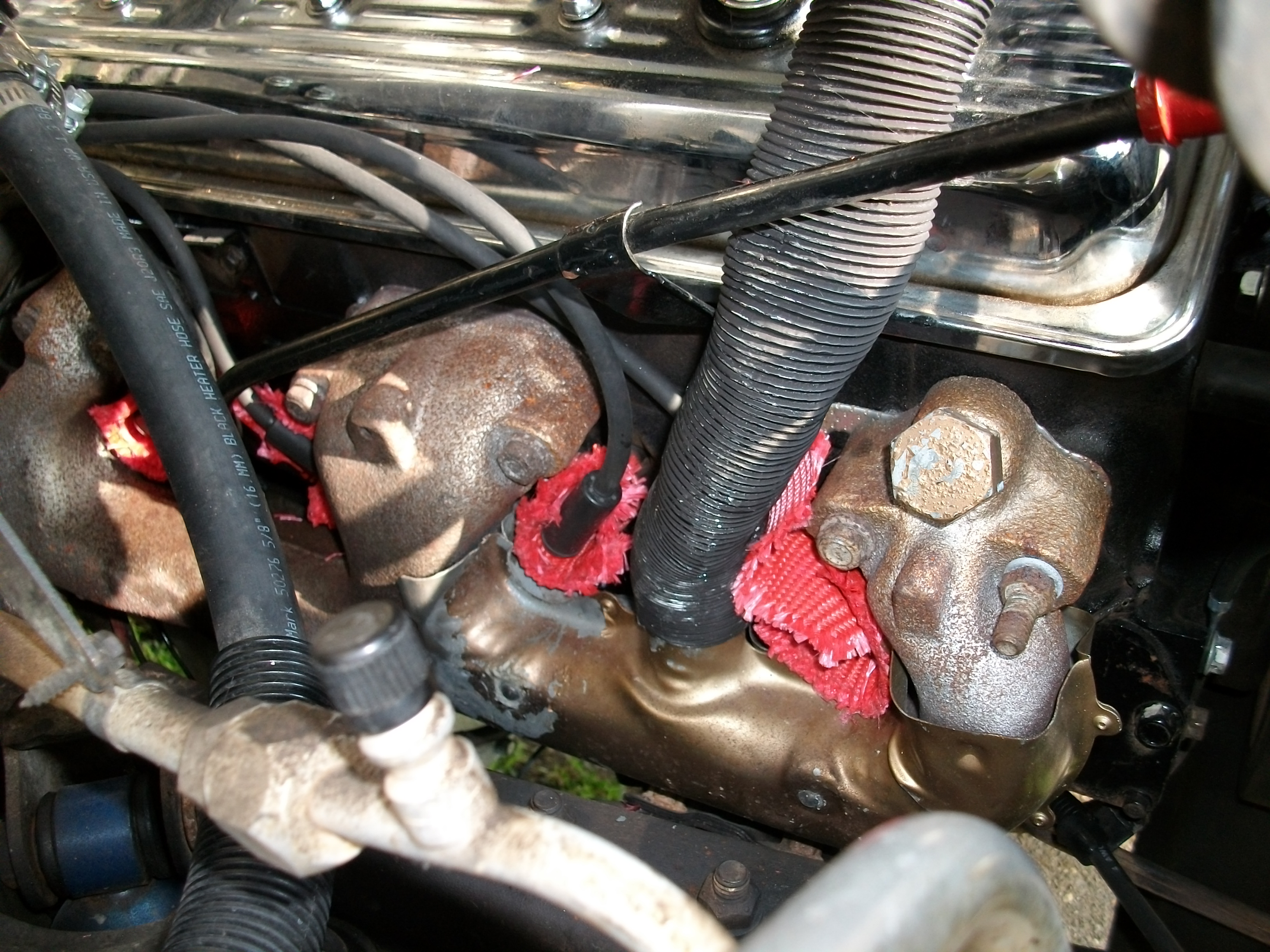

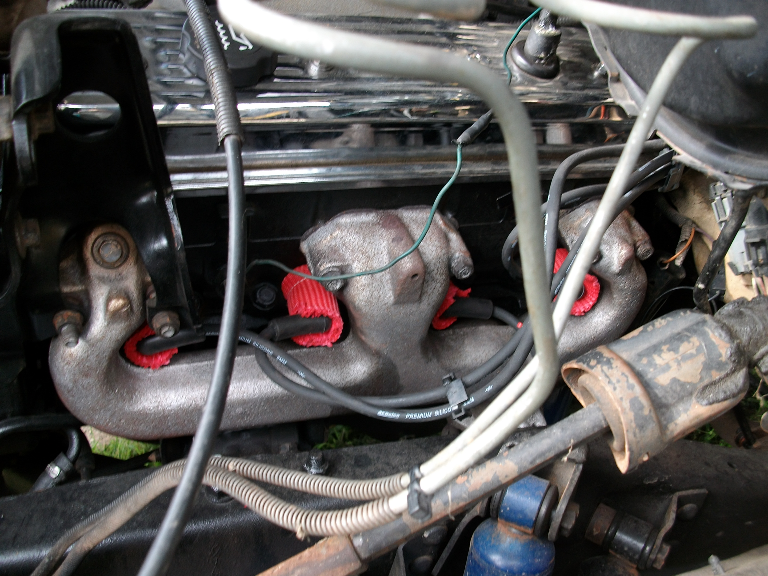

It Has a new OYX2 sensor. But I'm going to put a new set of AC Delco professional Rapidfire plugs in it. It's gotten to the point you can stand by the Magnaflow exhaust by the quarter panel and hear to pop pop pop and it just about every second. That makes me think it in the secondary wiring and I have gone backwards and examined the plug wires and brackets and holder and can't find a single problem.
I have a brand new AC Delco wires, ( lifetime warranty) and it has a MSD 40K volt coil and cap and rotor. The only place where the exhaust close to the wires in at the 90 degree boot at the plug connection. So I made some asbestos "booties" and have them fit over each wire connection. The #2 is the worst as the plug wire boot is like 3/8 of an inch from the super hot cast iron manifold. Tried 2 different sets of "Shorty Headers" but none will fit this engine bay. In the first picture, you can see the black frame sitting 4 inches from the heads ?
