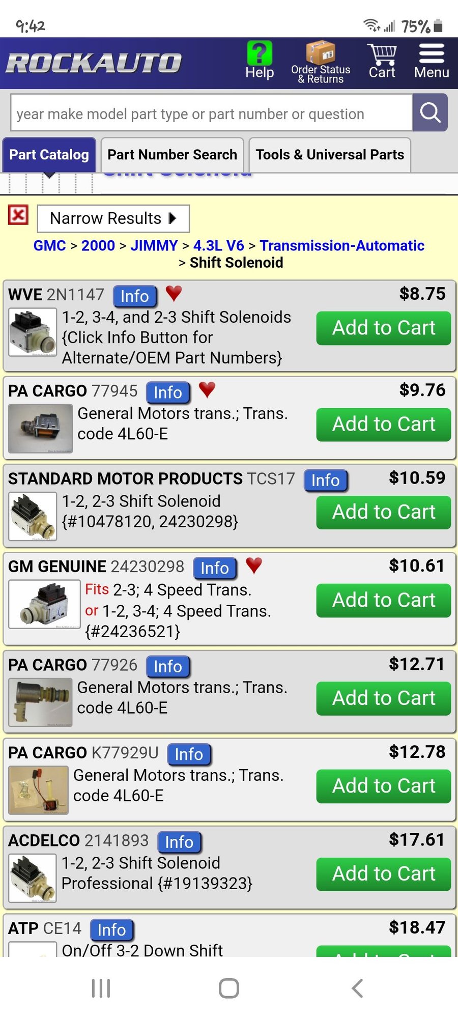

Doing more slow research, and found these.
Has anyone had to deal with these? and am I just prolonging a trans rebuild?
It does shift a little better now that they CHANGED the fluid, yes all the fluid. But it still does NOT go into second without a manual shift.

Unlikely the fresh fluid and solenoid will solve the problems you describe. Will the transmission shift past second gear after manual shift?

Could be the band servo has cut seals. Second and fourth use the band to achieve these gears.
