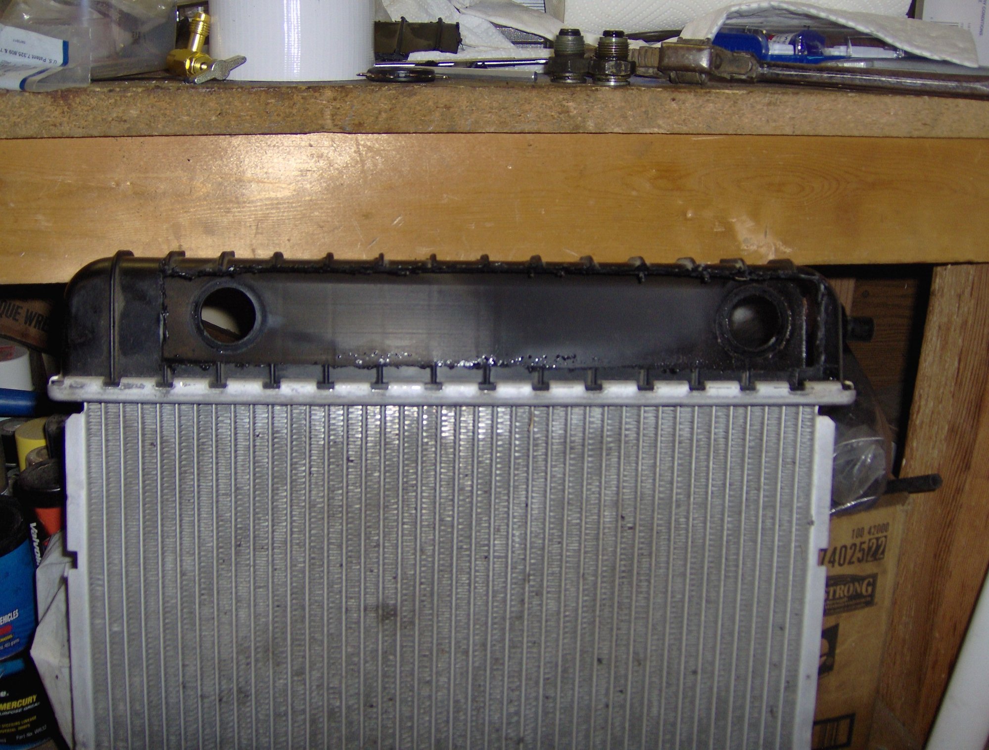

And in case you are interested, here are some pictures I took of my old bad radiator to see how the internal cooler was mounted:
The cooler removed from the radiator. It appears to be made of steel.
Side view showing the feed-through. There is an o-ring on the inside that mates with a smooth flat surface on the inside of the radiator.
The front-facing side of the radiator. The top of the radiator is to the left. I used my Dremel tool to cut away the plastic.
