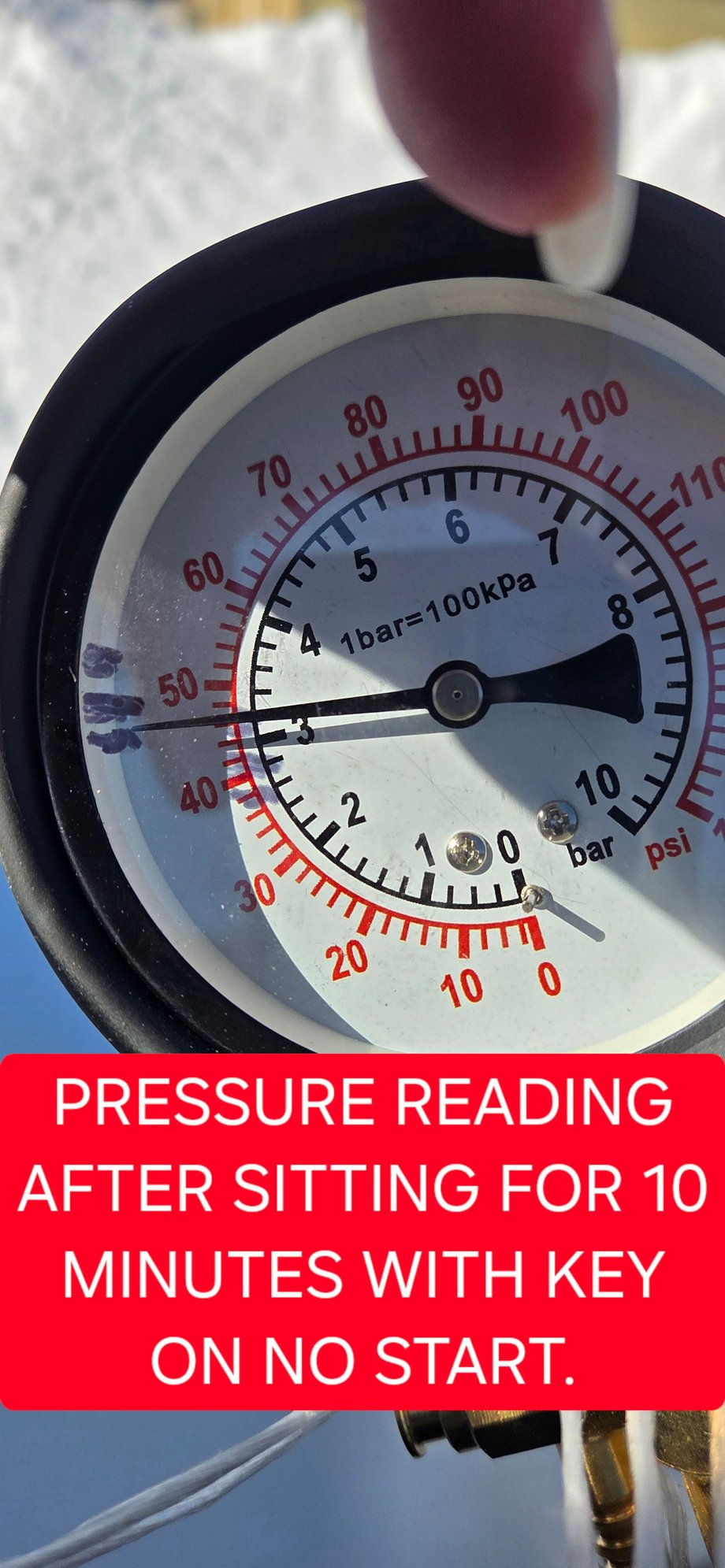

Some of those pressures are low enough to cause problems but lets start with the classic test. pressure at key on/no start and then the pressure at ten min still with key on.
You seem to be getting inconsistent results so do this three times, bleeding the pressure to zero in between attempts.
Then we will devise a driving test.

Good afternoon George, I attached photos, not sure what order I attached them in,
but, as usual the photos have text on them to explain which each one is. Let me know how you would like me to proceed. Thank You.

You have a fuel pressure problem. Now lets find out if its in the tank or the intake. Follow the instructions in the FPT sticky for doing these same reading at the output of the fuel filter:

Ok, I had to rig some stuff up in place of getting the proper fittings order so was a little trial and error but from what I can tell, with the gauge purged key on and left on (pump was only on for the prime but left key on for GP, it hit around 102 - 104 Lbs. left the key on and I think I had a small bleed but not enough to see or feel a drip but over 10 minutes +/- some seconds for getting my decrepit *** up and down between key operation and watching the gauge lol and the pressure dropped to 60.5 but as that article said it stayed above 55 Lbs. and if I get the right fitting in a timely manner I would imagine it probably only has about 1-2/3's the loss. How do you want me to proceed? P.S. I did finally just call the distributor, and they are supposedly just sending out a replacement Delphi pump just in case this one is causing a problem, supposedly gets here tomorrow at some point. I probably wouldn't bite the task of replacing it until the weekend maybe.

Thats a good strong pump with a good initial charging pressure, That said, thats quite a bit of loss during the 10 min bleed down but is in within spec and should be plenty to run the truck properly. Its almost 20 psi higher that the reading at the intake/shrader after the leakdown. This suggests a leak in the intake or with an injectors(s). There are a couple of different ways to go with this:
