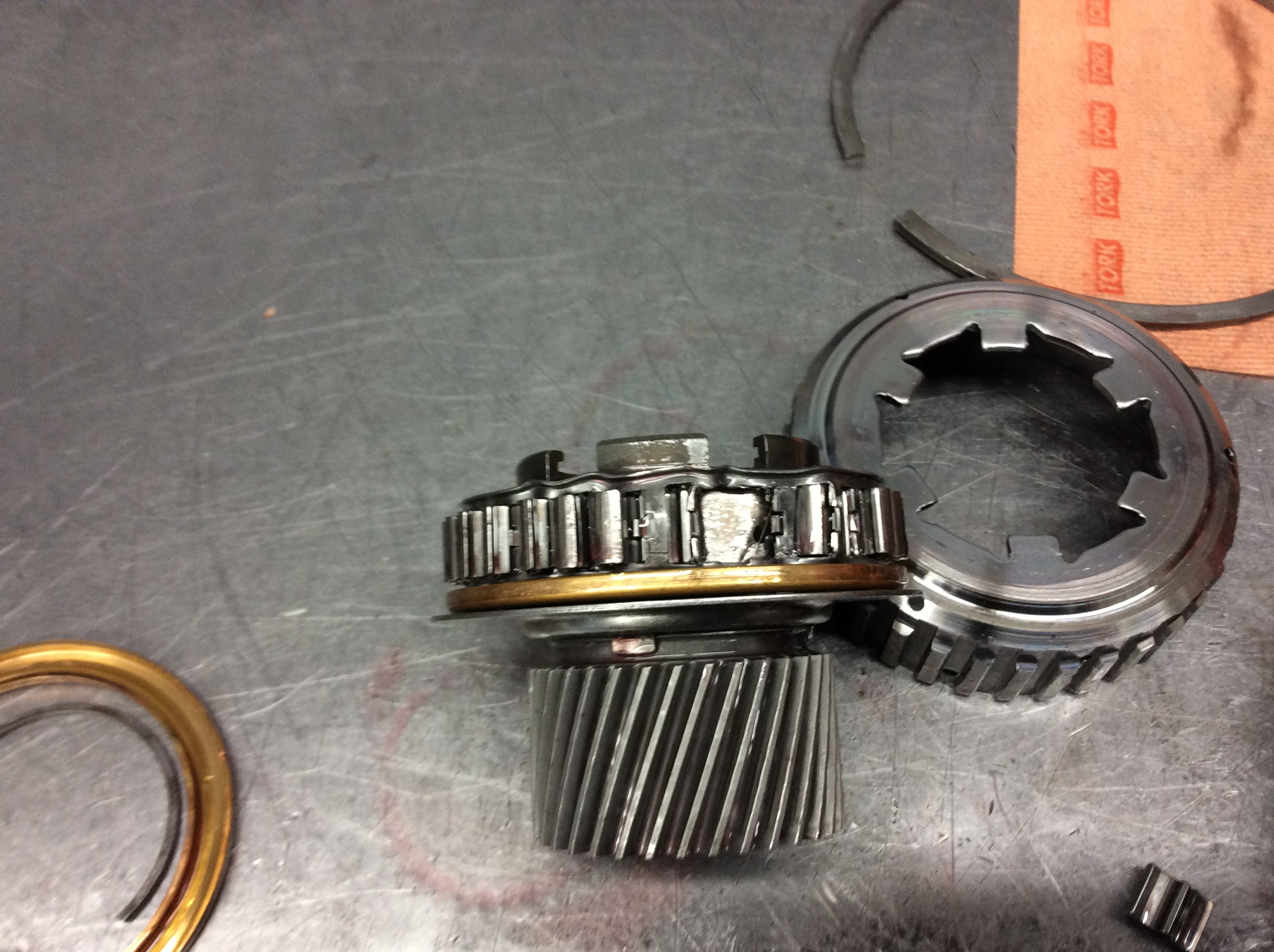

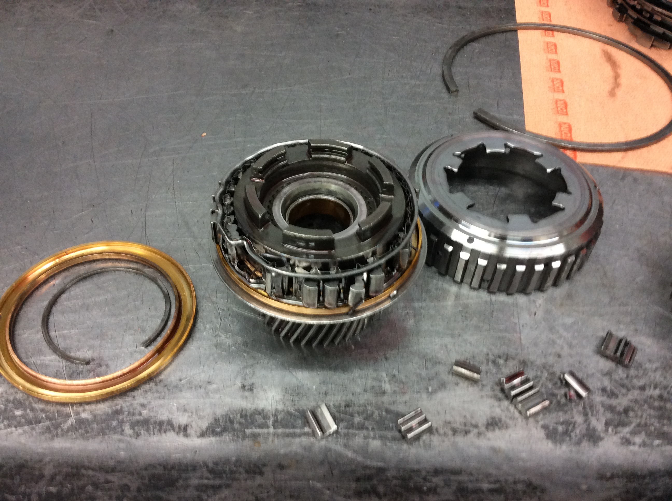

If it sounds like when a belt squeals you will have an input sprag failing. If you continue to drive you will definitely do more damage to be repaired at overhaul. It is an internal part and transmission has to come out. Sorry couldn't be better news.
Trans squealing/ making funny noise-img_2116.jpgTrans squealing/ making funny noise-img_2117.jpg

Thanks for the help. Is the picture you included the part? Would it be worth it to have the whole trans rebuilt while its out?

Yes that is a failed input sprag in the pictures. You should always consider rebuild while transmission is out of the vehicle. That's where most of the time and cost are in labor on removing and reinstalling. Or you could go used or re manufactured transmission route.
