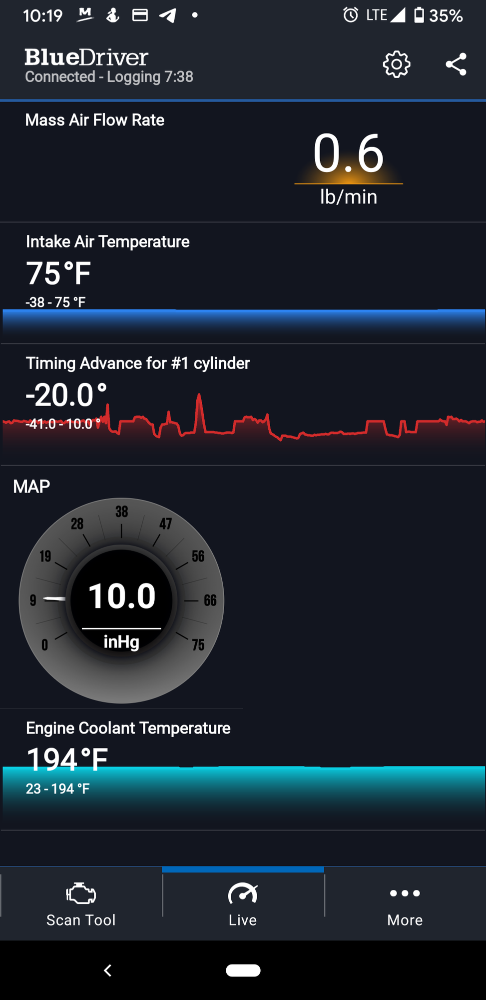

USing the blue driver scanner all the sensors appear to be working not sure what the numbers are supposed to be though. My timing advance for cylinder 1 on the scanner says -20 when idle and up to -40 when going down the road. Not sure if that is normal. Though it idles good and runs good going down the road with no hesitations. I'm like you don't want to just throw parts at it and hope for the best. I have checked fuel pressure but not spark as I will need to get a tester.

The important thing for timing is cmp retard which needs to be within -2 to +2. The computer controls timing advance and is not adjustable. You need to double check fuel pressure when it runs crappy in case you have some injector problems when firing for instance. Sensors in live data:
ECT should read ambient with engine cold and around 195F with engine hot
MAP or baro should read ambient with KOnEOff
TPS should be smooth and follow the gas pedal through its range from around zero to 5V, KOnEoff
O2 sensors should be switching between around 0.15V and 0.85V at a frequency of around 1-3 hertz at idle
MAF sensor should be reading around 6-7 g/s at idle but the definitive test is a screen capture at the full throttle 1-2 gear shift
IAT is ambient at KOnEoff
Fuel trims are <+/-10 each bank ST+LT
Report back on FP, ignition and sensors
George

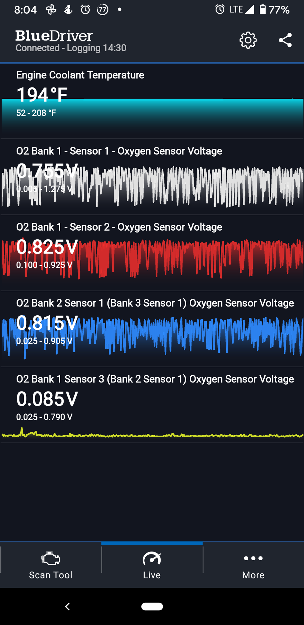

O2 sensors

Maf, map, intake temp, coolant temp and timing to cylinder 1

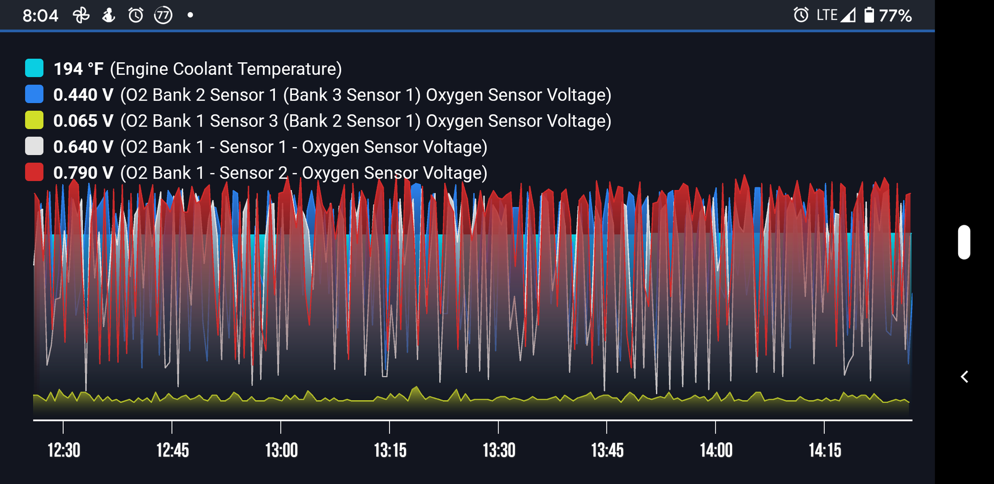

Can your set up graph the O2 sensors, that is more useful. Here is an example:
It looks like you sent the O2 data twice.
George

Also, the truck has to be really warmed up for the post cat O2 sensor to make any sense.
George

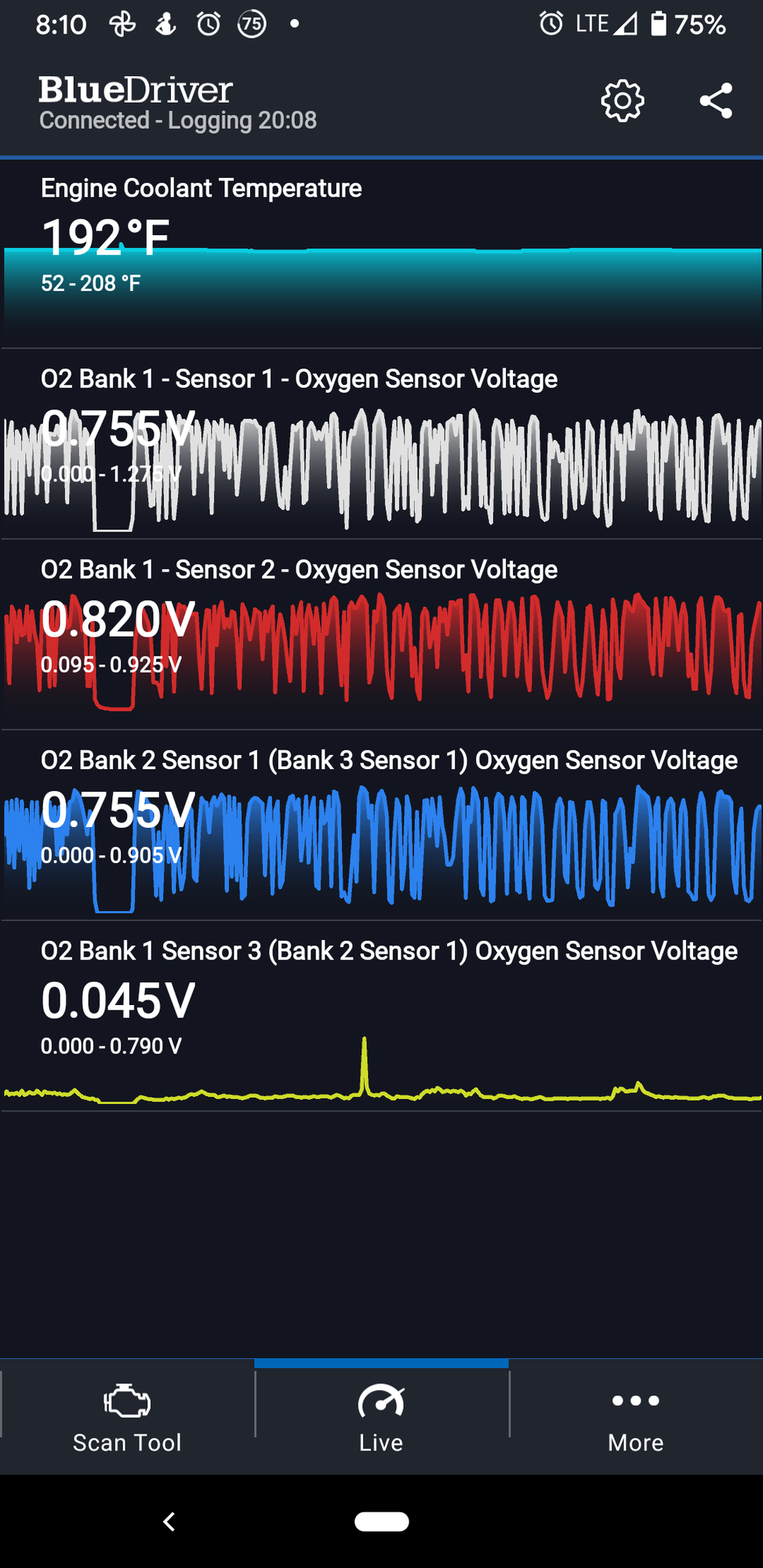

Old Nov 21, 2021 | 07:26 PM
Draventhedark's Avatar
Joined: Nov 2021
Posts: 14
Draventhedark is on a distinguished road
Old Nov 21, 2021 | 07:28 PM
Joined: Nov 2021
Posts: 14
