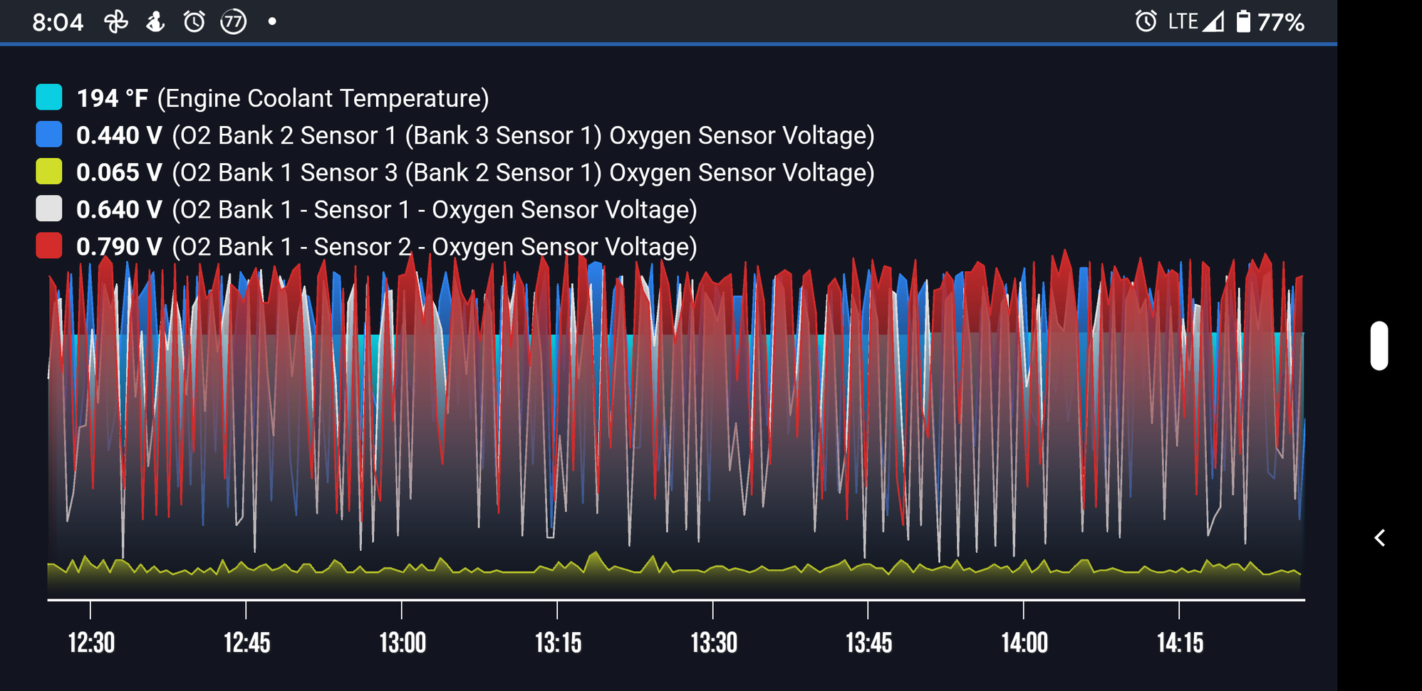

Those upstream O2 sensors look pretty good but there is no horizontal time scale. Can that be added and the graph zoomed out to see the frequency? Looking for 1-3 hz
The downstream sensor does not look right. It should be a roughly steady voltage level but somewhere between 0.45 and 0.75v not less than 0.1v. Did you say no codes? Look at that graph when the engine is cold to see if the downstream tracks the upstream sensors before the cat warms up.

Will get fuel trims tomorrow on the way home and.post them. Iat, ect are a match to the outside temp when cold. As far as I know the sensors are all original in it. I have not yet checked the wires and ground with working 12's and 7 days a week haven't had much time to mess with it. Also you are correct I get no codes and I scan for the in the morning when I get home and at night when I get to work. I have a graph with all of them with a time on it I will post on here. Did it the other way cause this one is a mess to look at.

If I am reading that funky O2 sensor graph correctly it looks like around one transition per second which is typical at idle.
