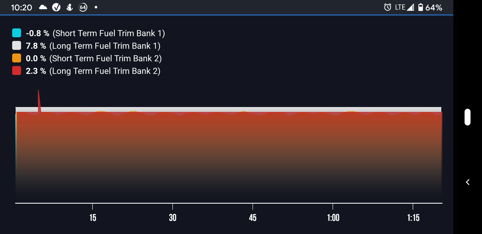

Can you display those fuel trims as a simple chart? I’m not sure what to do with the “-“ sign in between the values. That said, these fuel trim numbers are a mess. I don’t know if I have ever seen such large negative values. I’ll wait for the chart before we launch into this but if I understand those numbers the computer is significantly reducing fuel control to compensate for a very rich condition. You might want to read this:

Not sure where the major negative numbers come from as it never goes that negative while I watch it. The one is from this morning going home the other shorter times one is at an idle after driving to work. I did have it hooked up to a friend's snapon scanner and it was showing the fuel trims as normal usage buy that was only at an idle and not driving.

Your fuel trims look OK. You add ST and LT together for a given bank and you want to be under 10 absolute value. Your trims are positive so the computer is adding fuel for a perceived lean condition. If you have a vacuum leak then if you rerun those trims at 2500 the net positive numbers will go down. Just warm the truck up and read your trim values in the driveway at idle and 2500 rpm.
